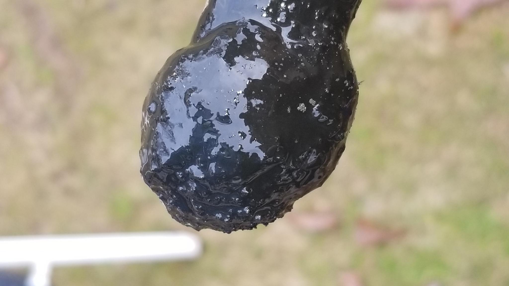

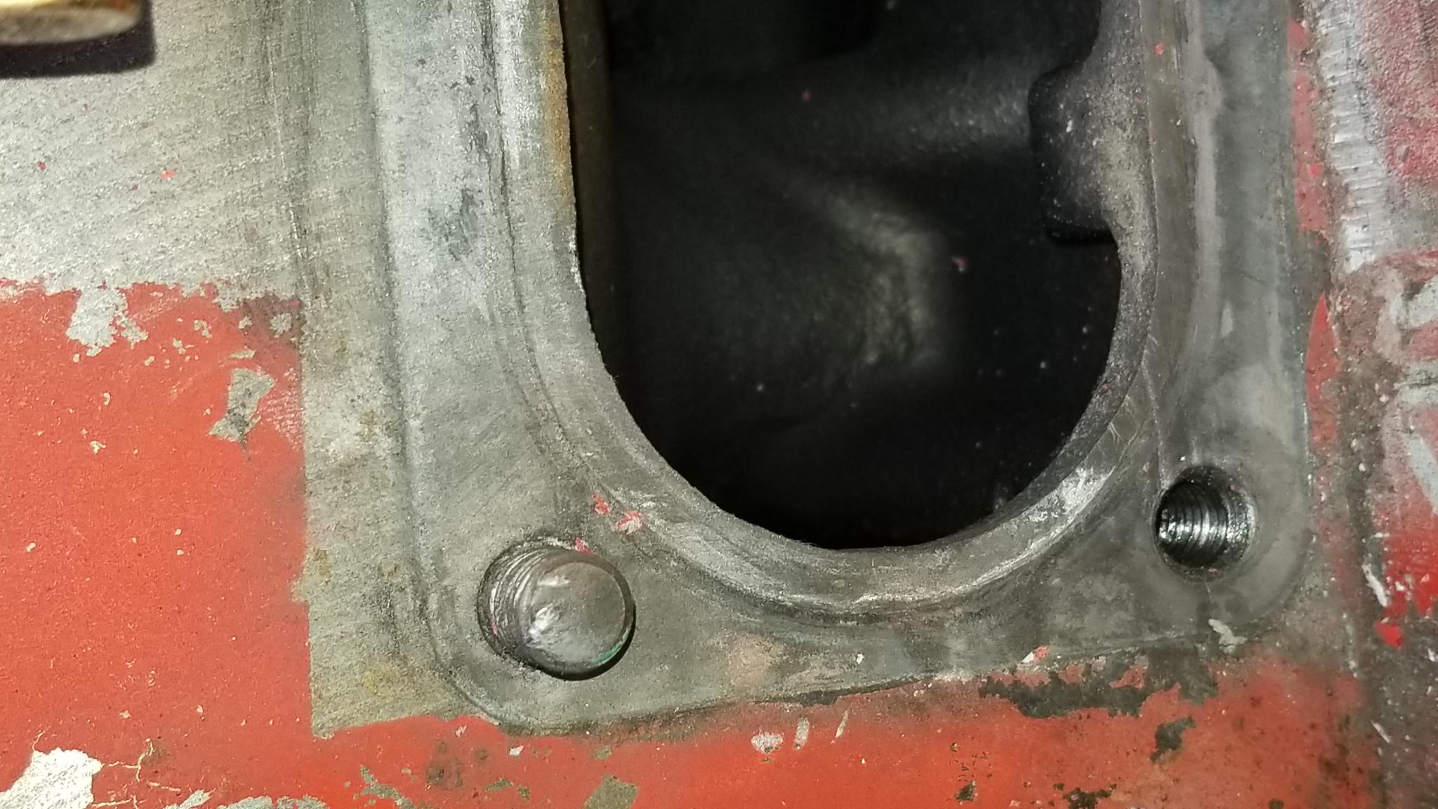

On Saturday the 21st in OK my truck sounded like it was screaming at me. I thought it sounded like a balloon that someone was letting the air out. I got the truck home on the 23rd, and started to trouble shoot. I ended up replacing the fan clutch it had over a million miles on it. This isn't the issue. Yesterday the 27th I took the truck to Rawze's , and we took the turbo apart. Nothing going on the inside of the turbo. So, the way home I stop by Peterbilt here in Jackson to get a turbo mounting gasket. This morning I decided to start replacing the the turbo gasket. I took off the air cleaner the whole assembly, and saw a broken bolt on the intake. I took off the "EGR hot pipe" that goes down to the EGR valve, and it is full of sledge. What will cause this, and how do i fix that.

Is this engine demandated or factory? If demandated then it is likely moisture/condensation mixed with old carbon - Nothing to worry about as there is no flow through that pipe. If it is factory then it is likely you have a leaking EGR cooler.
12-28-2019, (Subject: Screaming Truck )
RE: Screaming Truck
This is 871 demandated.
