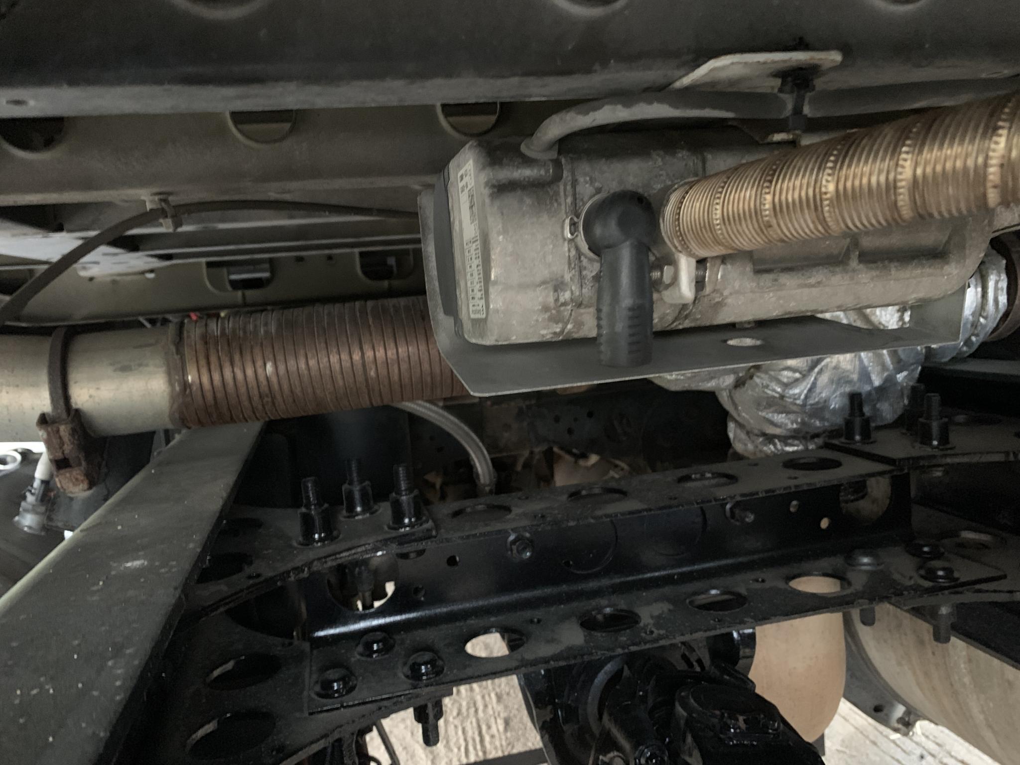

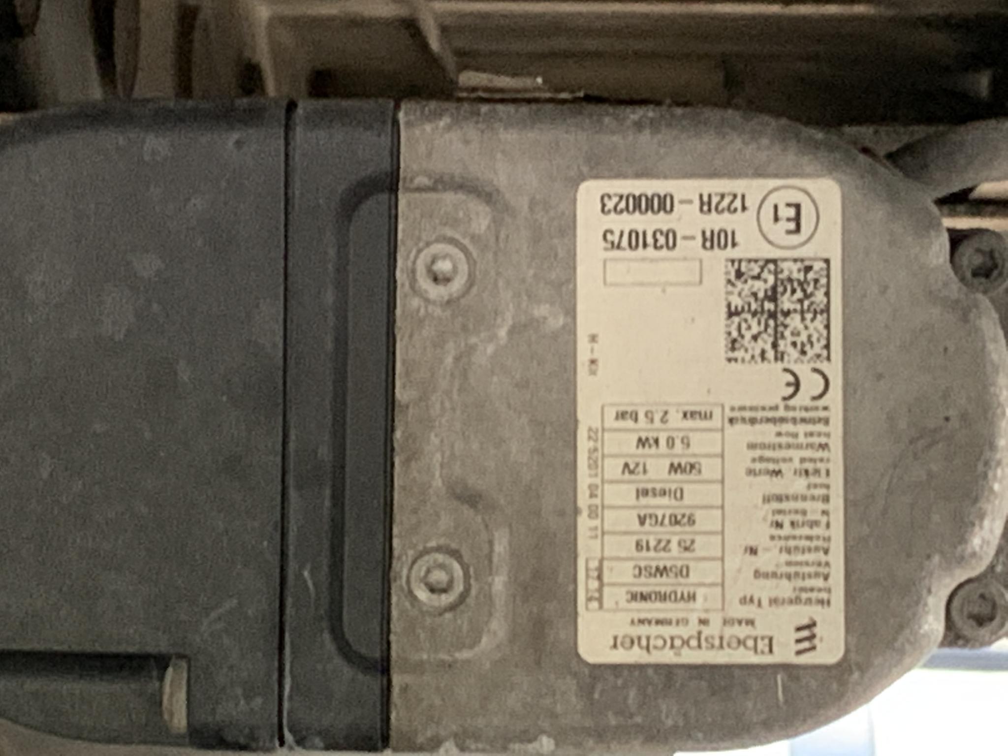

So I got the bunk heat working. I had to remove the heater and take it apart. The burner blower was stuck from just sitting a lot. Lubed it up with some Howe’s spray. I love that stuff. Assembled it and put it on. Had a hard time starting but a heat gun and a couple wackes on the thing got it going. Now I’m wondering how to get my auto start to work. I turn off the truck and hit the switch and no green light. I don’t know anything about this system so any ideas would help.
