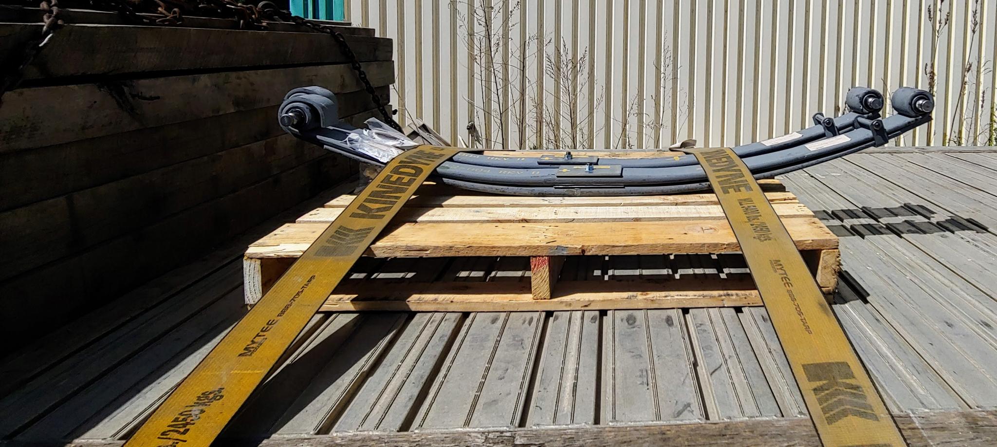

So, recently I had a choice. Which repair to do first: Crankshaft Damper, CAC, or Front Springs? Well, the spring pins have been popping, front and back, for a while now. Plus the front tires are fairly new, so i went with the springs. Anyone have any prep and/or install tips? They came unpainted, any preferred paint or primer? I have some black chassis spray paint laying around somewhere.

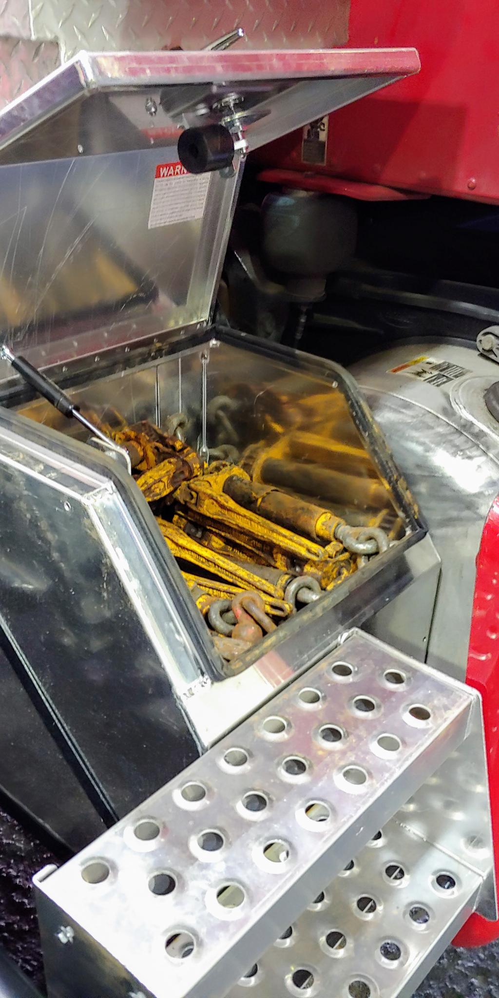

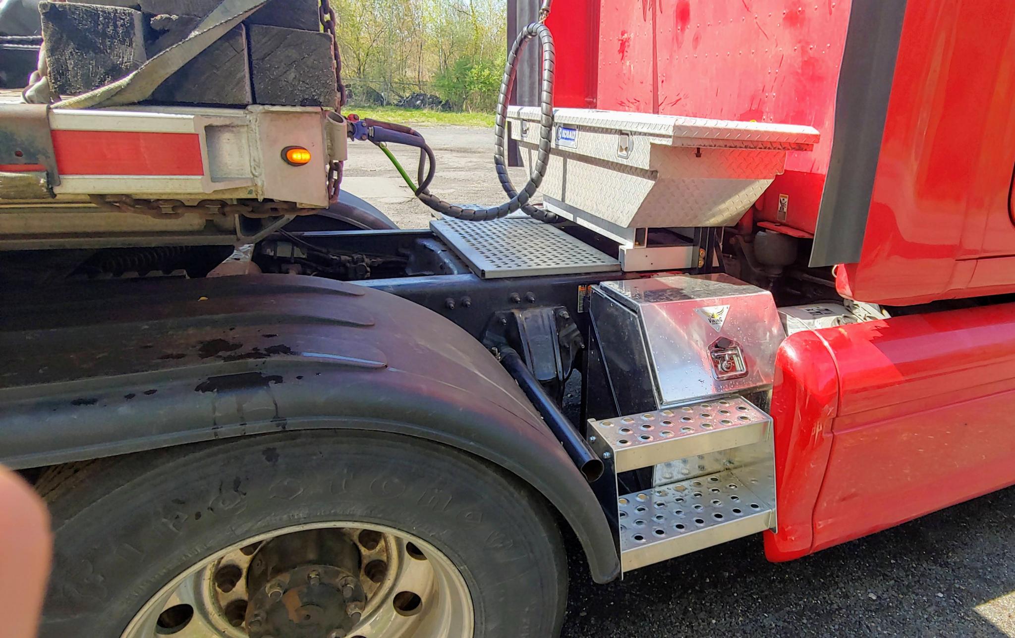

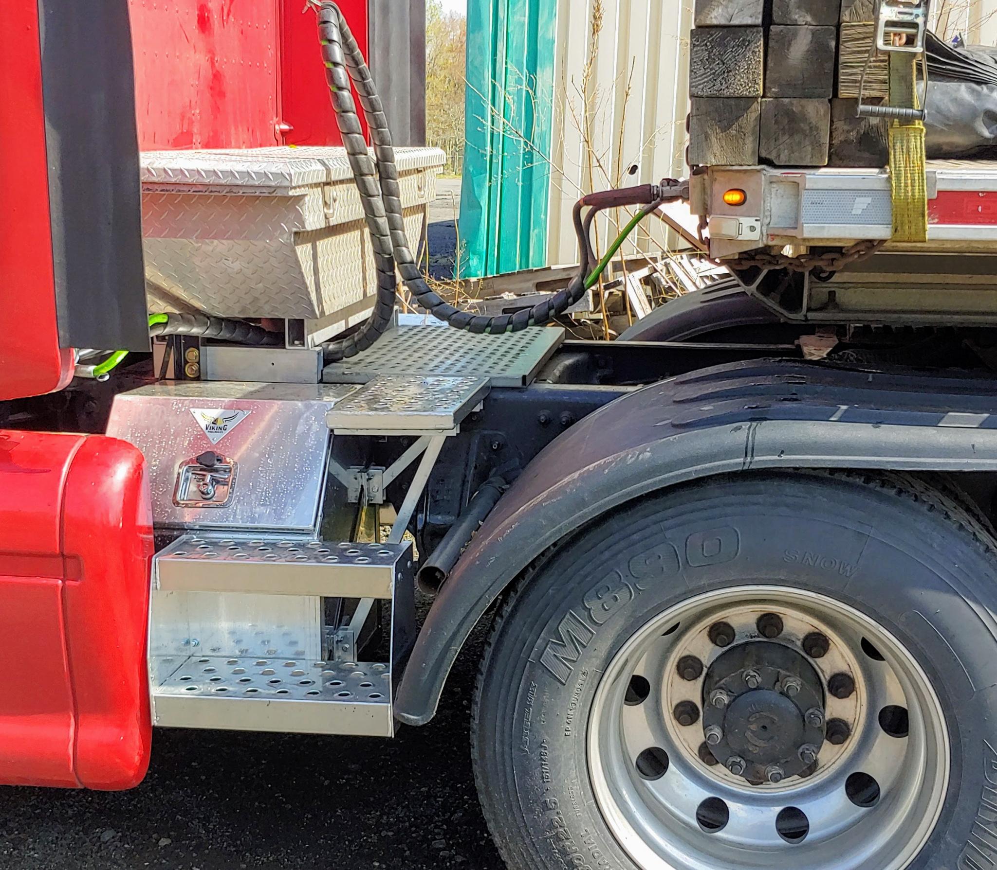

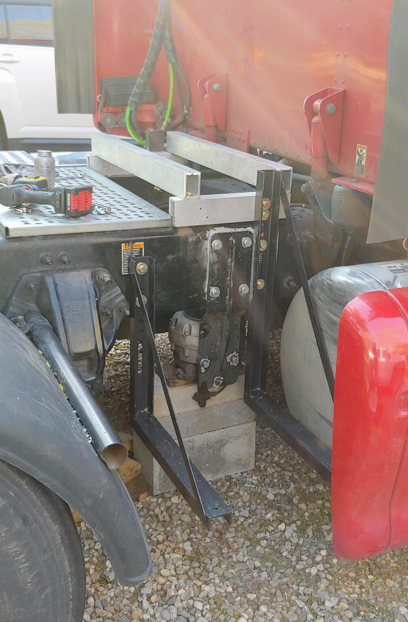

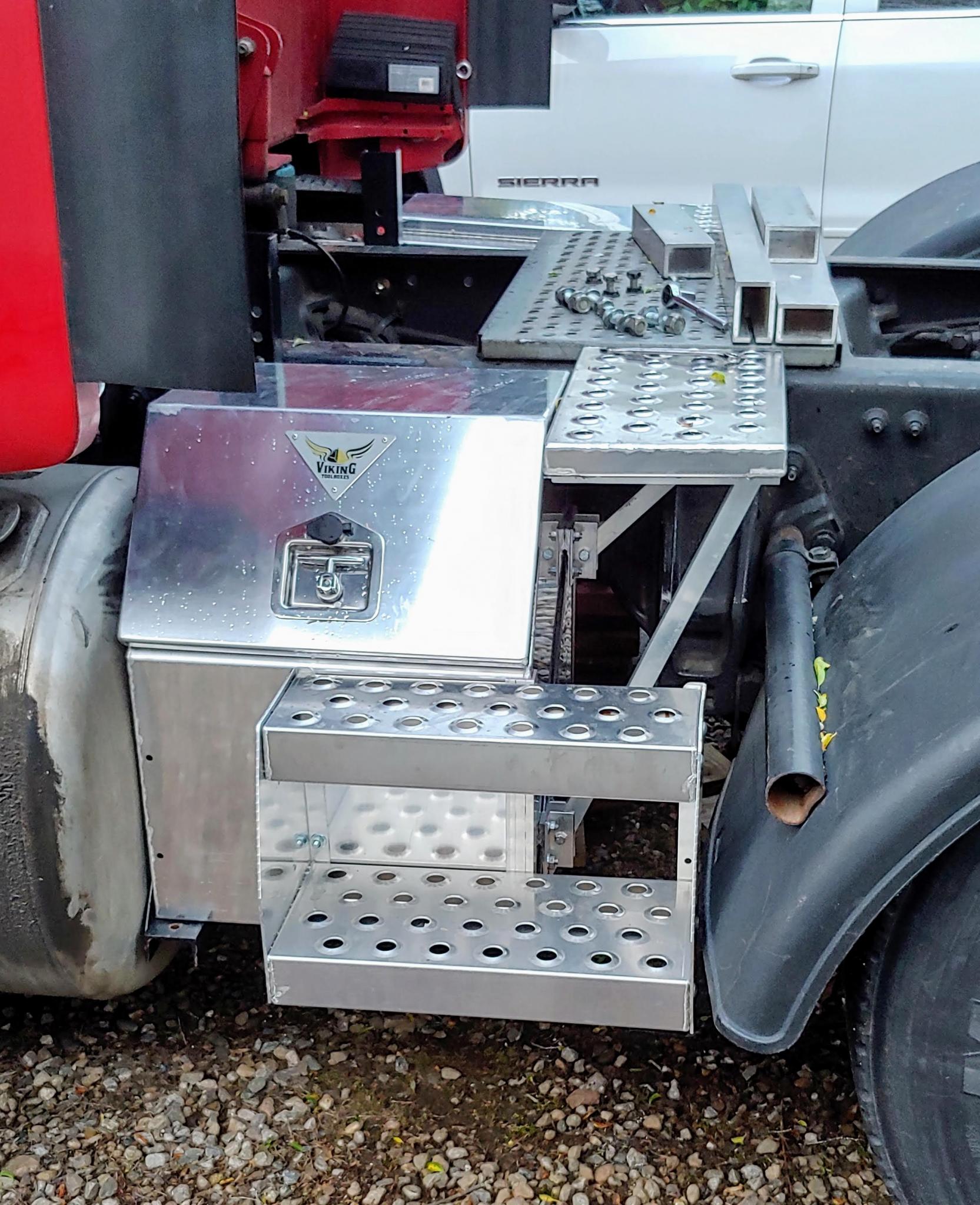

Also, finally got around to drilling the holes in the frame (bought a cheapo Chinese mag drill) and installed my modified step boxes. Bought the boxes last summer. Finally, more storage!
