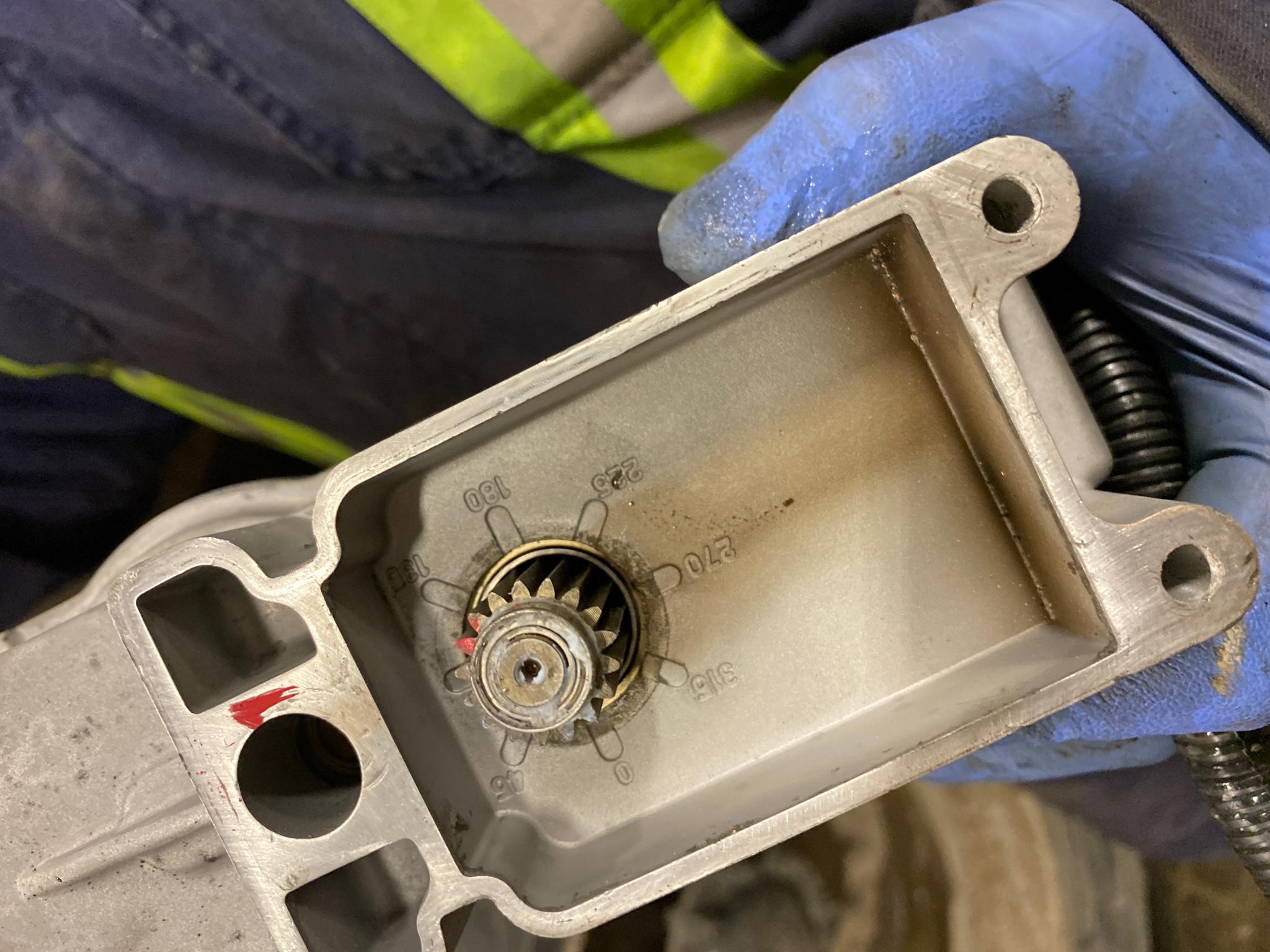

We found that the actuator was getting a short somewhere between ecm and actuator. Right now there is a new harness installed between the two and it is running normal after a 20 minute test drive. A burnt smell from the actuator was present and it looked like this...

(03-04-2020 )trucklogger2 Wrote:  We found that the actuator was getting a short somewhere between ecm and actuator. Right now there is a new harness installed between the two and it is running normal after a 20 minute test drive. A burnt smell from the actuator was present and it looked like this...
looks like it got hot (likely from bad-deletes-r-us.com) and the grease inside it ran out / got cooked. - keep running it like that (and without opening it up and re-greasing it internally), and you will be replacing it soon.
that thing got a pyro and boost gauge on it? What are they getting up to in a hard pull?
