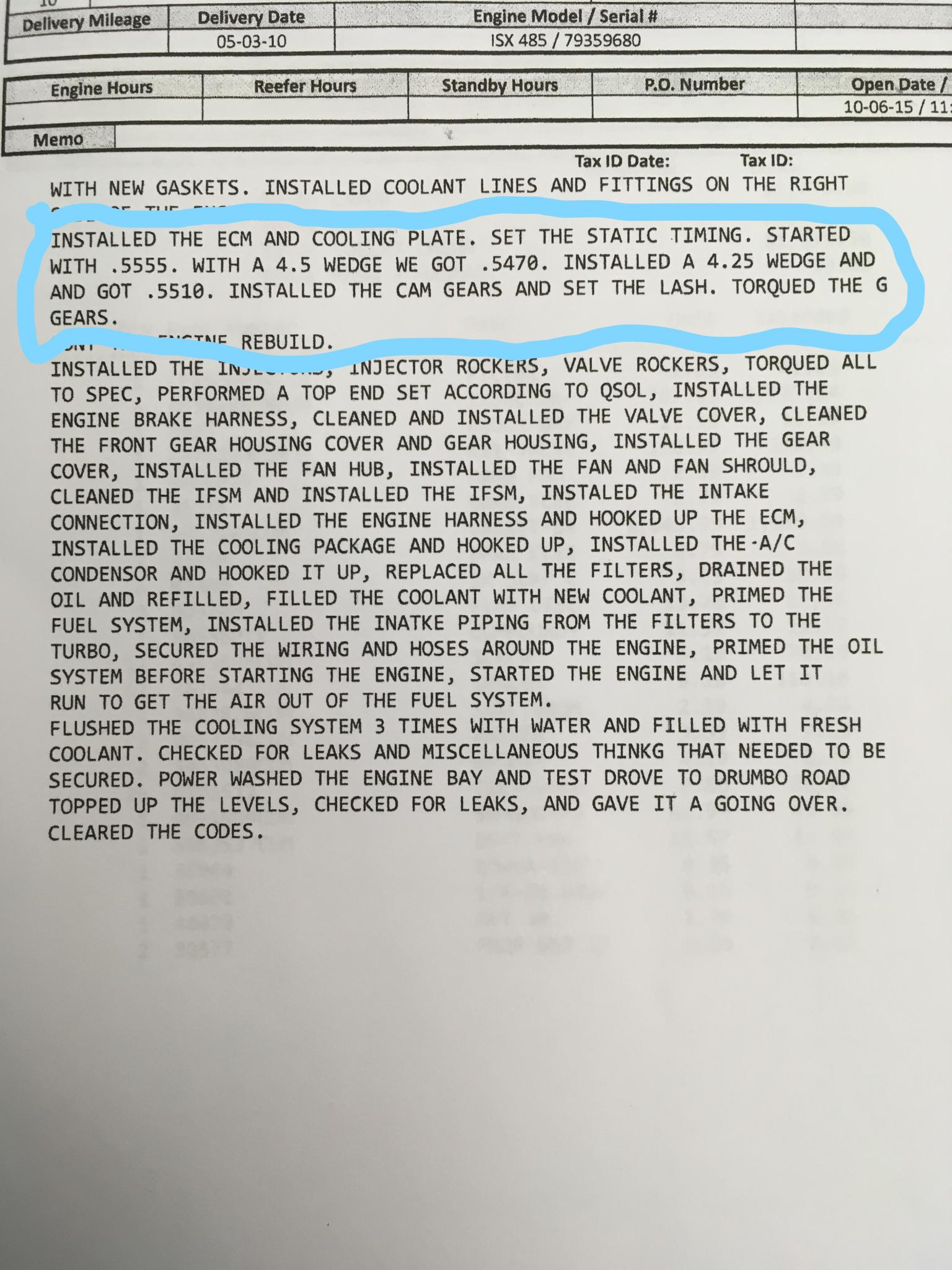

Hi Guys
I have a question on timing. Picked up CM871 and noticed that the 4/6 on the valve cover had been changed to 4.25/6. So, i went to the origional owner and in his files found that this truck had a recent overhaul, In the paper work they discribed setting the timing, i have attached a picture and was wondering if this is the proper way to set the timing at overhaul. Is this the base timing method? Thanks for the help.

They've used the proper static injection timing kit to get your timing as close to nominal as possible (0.5515).

I have never had to use anything but 4/6 wedge on a CM871 engine... And they all come from the factory at that setting, the software expects them to all be set at exactly 4/6. - Not sure that the older methods even really apply on them as such, but that is up in the air for speculation.
Most of the time when they do this older methods, they also don't properly use loc-tite-609 on the tapered gears to secure them, so that they can take them on and off... Also only setting liner height to 0.010" (or less), and a lot of other things that i would not trust one damn bit.
Was it counter-bored?-- liners raised to 0.014"? -- was it a brand new head? Was it all OEM parts?
I would be skeptical of this build.
just my thoughts when reading this.

Yup Rawze you is right. Shitty work. Finally got this truck in the shop. It was sold as rebuilt engine with documentation. Truck ran like shi#t bringing it home. So started with Insite and found no parameters for anything related to DPF or EGR. I noticed that the Turbo was running about 30,k rpm and when you stuck your foot in it it would spool to 85,000 rpm :oh:. Boost was bouncing to 30-40. SO, Pulled DPF and DOC pics attached (i think). Went to pressure test A to A, failed. Turbo is pumping oil. actually the leaks in the ata are easy to see, there the ones leaking oil. 2 year old cooler, Block plate in intake. (free give away). front cover is leaking so pulled it. When i pulled the bottom idler gear the one bolt was covered in silicon ????? Looking in at it againi see that 3 holes go into the water jacket and the one below the oil gallery is blind. Thats the one that had the silicon on it. Local dealership tells me that that is common to find. Any thoughts, This truck had a history of coolant leaking in to the oil is there a chance that coolant can pass by the bolts that are into the coolant jacket.

Oh god! That is your DPF? All of that back pressure caused by all of that soot explains your issues, and the leaks and failed CAC. Damn. Worst thing, from my own personal experience, if that motor was put together the way we are currently seeing, they did not cut the ledge for the liners, they simply dropped them in, like in my first in frame. I would bet money that the head and the head gasket are shot. That is where your coolant is leaking. And no, the silicone is not normal, that is laziness, and you have bigger issues.
