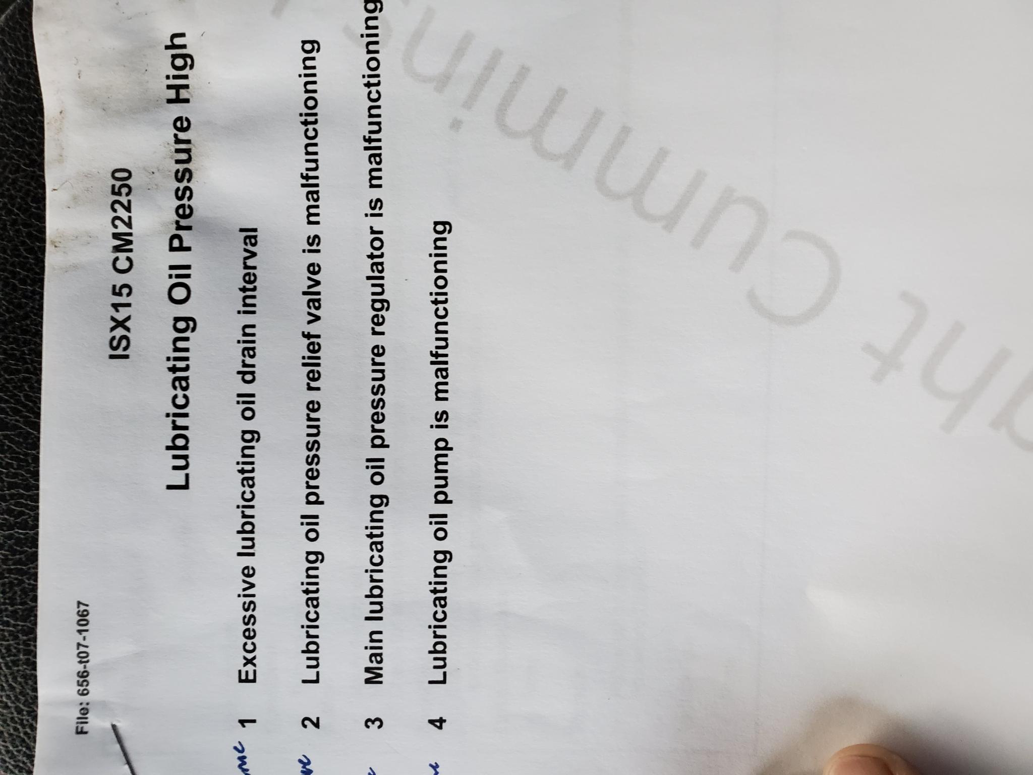

| Replacing oil pump (should I do the dime mod?) My oil pressure at start up for the past couple of weeks has been 90 psi. I have changed the oil pressure sensor twice put a manual gauge on the block to see if dash gauge and scangauge are correct. They are. Cummins quick serve says only 4 things can cause high oil pressure and I would be eliminating 3 of them with a new pump. So while I'm doing it should I put the dimes in or not? | |||

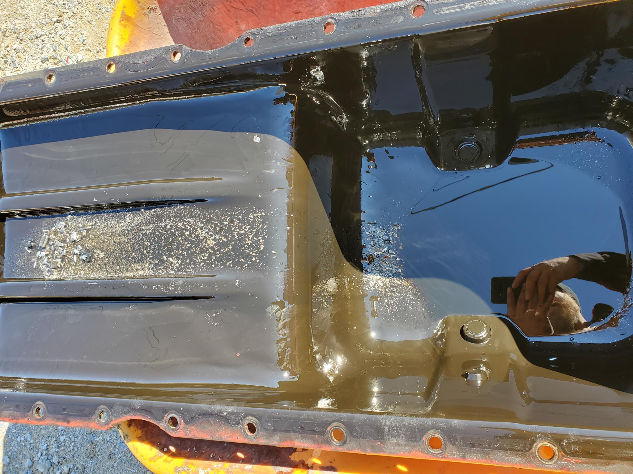

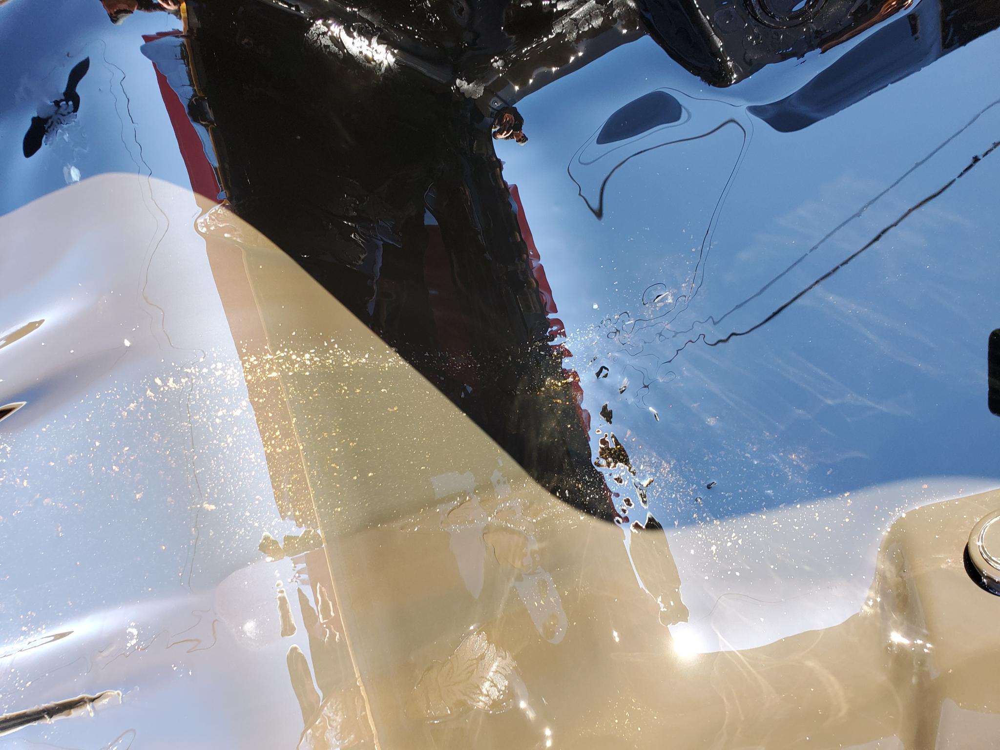

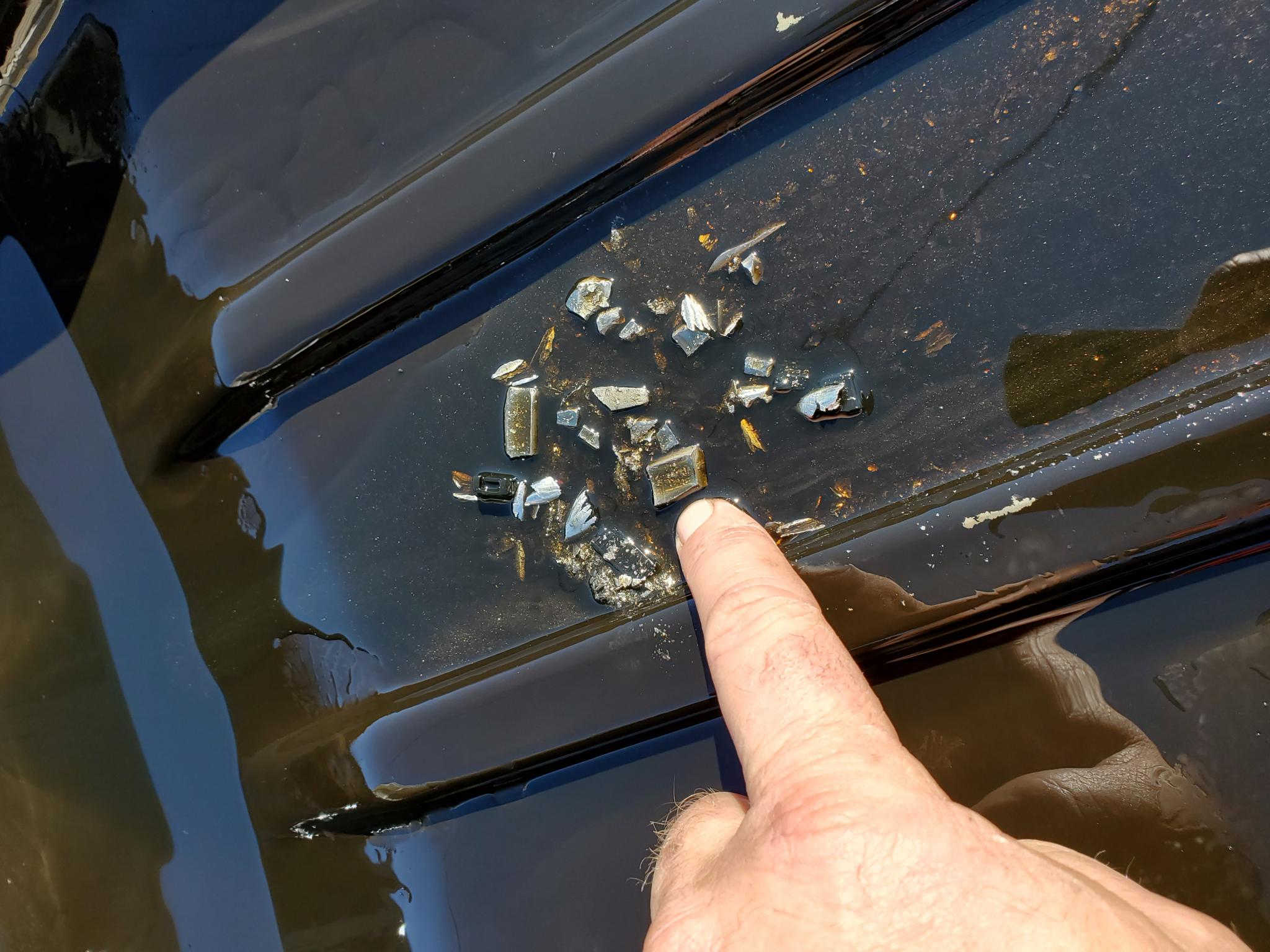

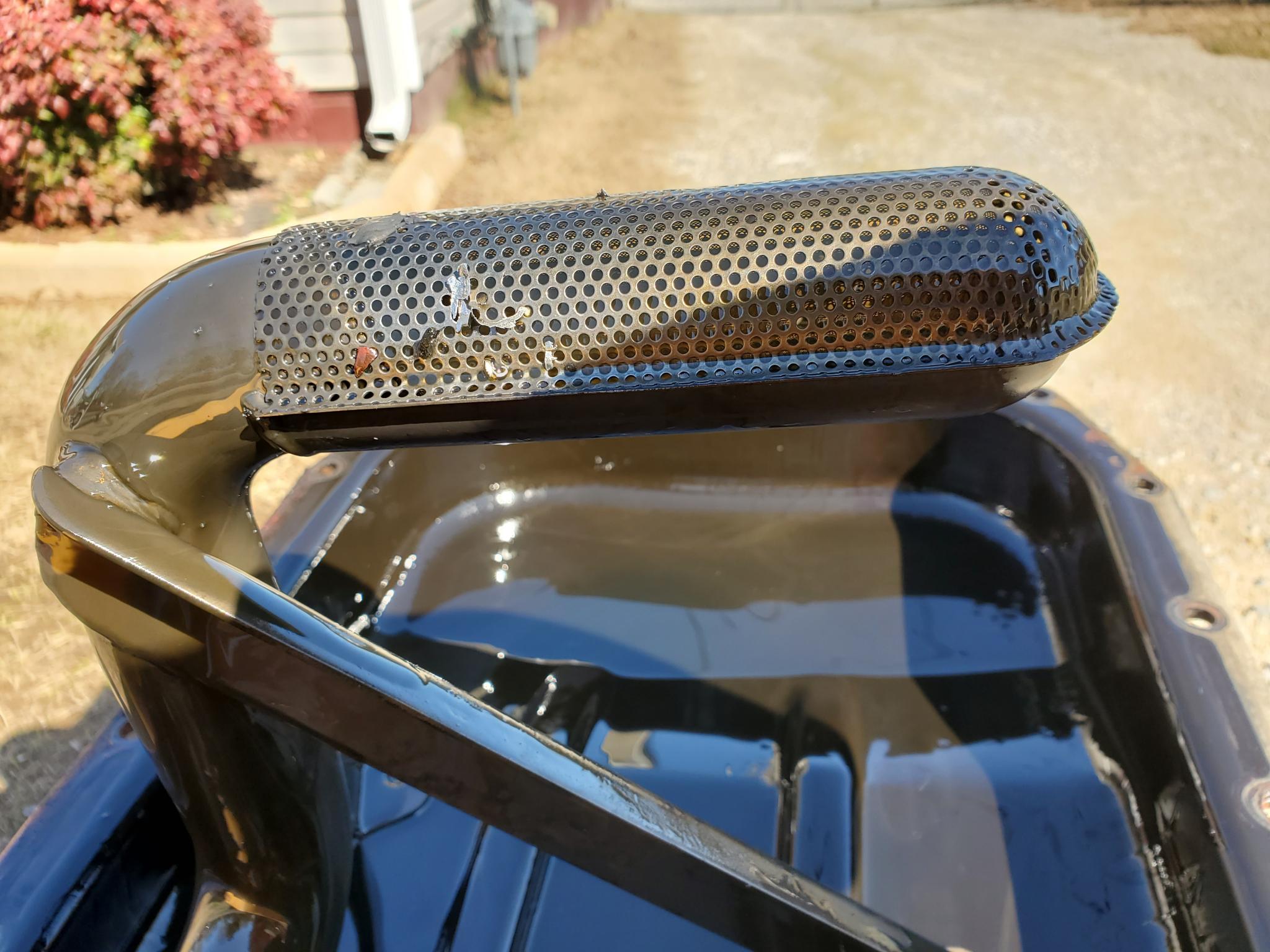

| 02-14-2020, (Subject: Replacing oil pump (should I do the dime mod?) ) Post: #9 | |||
| RE: Replacing oil pump (should I do the dime mod?) This is in my oil pan. | |||
