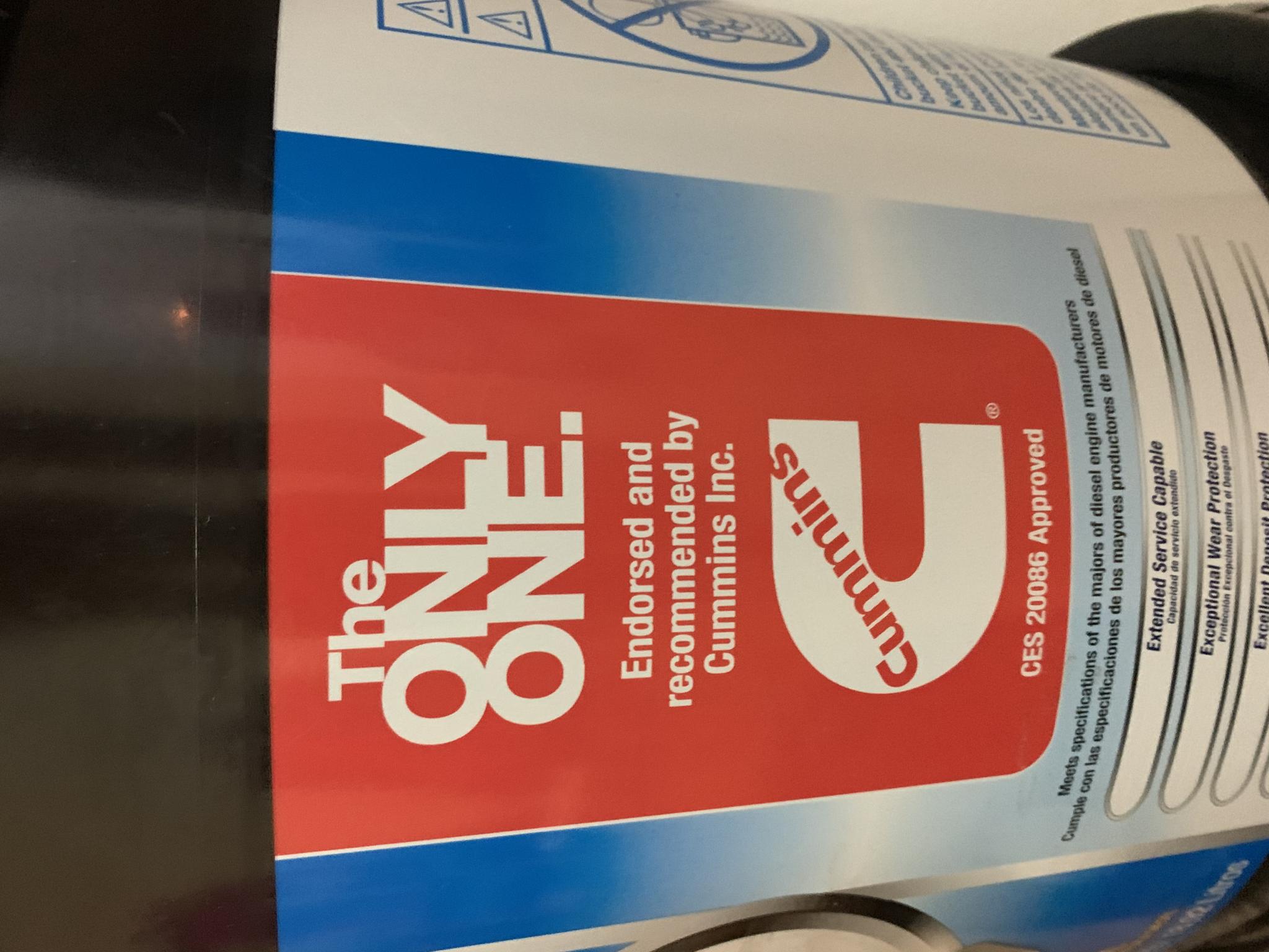

The stuff you are referring to ...
a person can use it, no problem. I think though that it has a slightly shorter lifespan than some other brands, may require oil replacement more often than some of the brands that have better separation and/or TBN loss preventatives.
Just because the engine maker endorses it, does not mean it is the beast thing out there. - That is somewhat mis-leading in my book.
Does not matter to me what the engine maker says (within a certain bounds) as much as application and use would dictate. Only way to know for sure if what you are doing is working well for you is to do some oil sampling. watch for iron levels vs. mileage on oil, and see what the results are after a few oil changes.
Personally, I don't think any of those oils are nearly as good as the pre-epa oils that allowed more zddp up around 1440 ppm (optimum) and the like. - A lot of these newer oils are recommended, zddp and other additives have been stripped out of them, not based as much on wear as they are based on emissions too any more, and this mis-leads the public.
