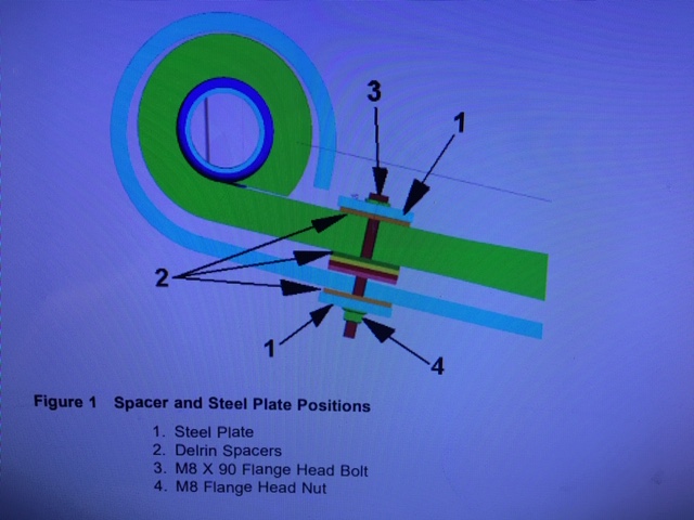

That lower spring tapping the leaf above it is normal. Its just the design of the spring coiling over at the spring bushing. Its sort of an upgraded design from the earlier year Internationals that would snap the lower spring leaf.
10-11-2020, (Subject: Chopped tires )
RE: Chopped tires
I think you want a 2587984C91 anti rattle kit. 1kit does both springs on one axle.
Kit is called out in NAV 2 docs iK0500013 and TSI-05-03-03 This will quiet it down. Note this kit does not last forever. Couple years ususally../uploads/202010/post_3838_1602457963_366b308810858ab08d2c84781e0af7db.jpg
