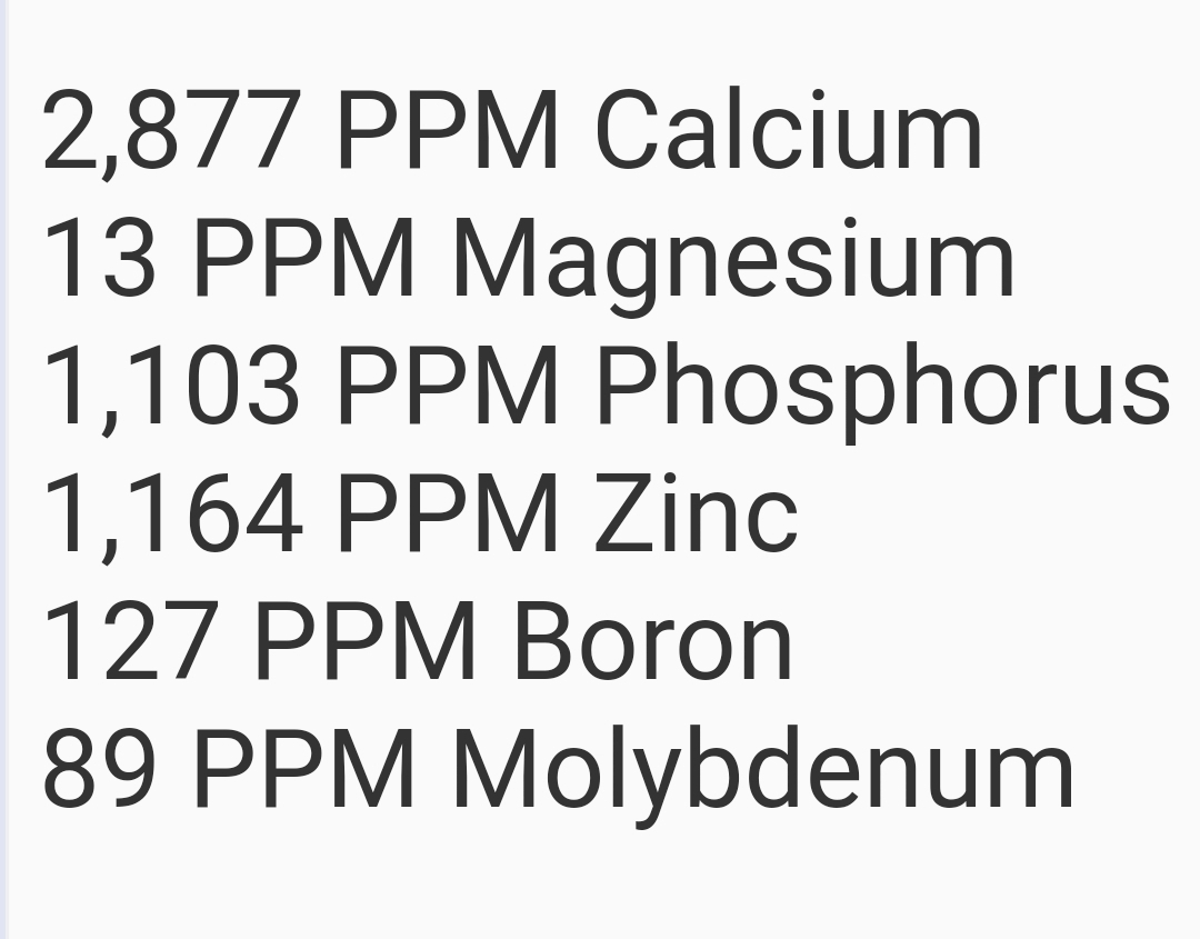

RE: John Deere Plus 50 Something to also keep in mind is that it is commonly known that low pressure oil system engines (like the ISX) love lots of zinc (ZDDP). As long as it has 1100 - 1400 ppm zinc + compatible with the engine in general, then it is likely ok. If it is down on the 800ppm range or lower, I would consider something else. User's Signature: ->: What I post is just my own thoughts and Opinions! --- I AM Full Of S__T!. | |||
09-14-2020, (Subject: John Deere Plus 50 ) Post: #4 | |||
RE: John Deere Plus 50 (09-14-2020 )Rawze Wrote: Something to also keep in mind is that it is commonly known that low pressure oil system engines (like the ISX) love lots of zinc (ZDDP). As long as it has 1100 - 1400 ppm zinc + compatible with the engine in general, then it is likely ok. If it is down on the 800ppm range or lower, I would consider something else. Here is a break down I found online... not my test. | |||
