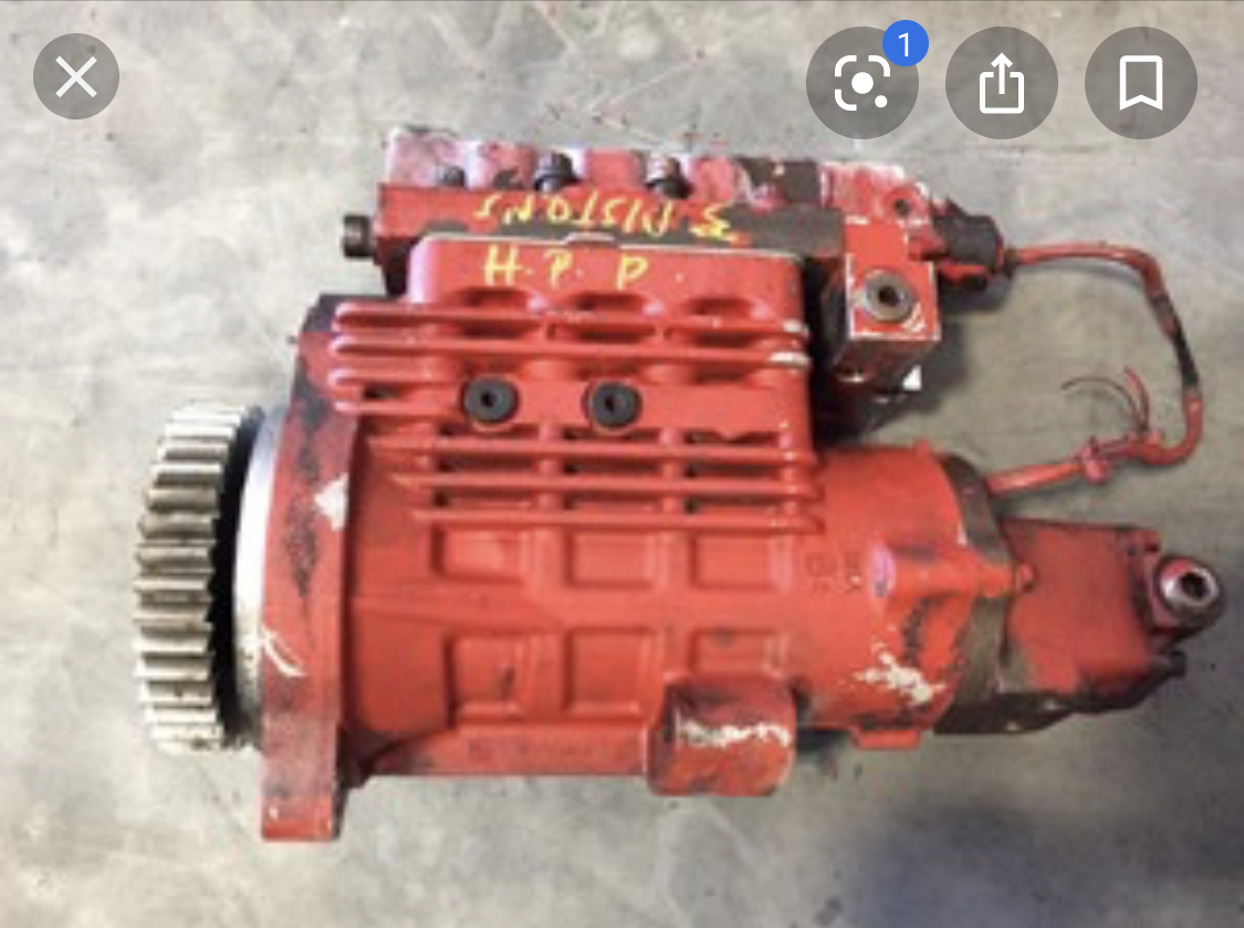

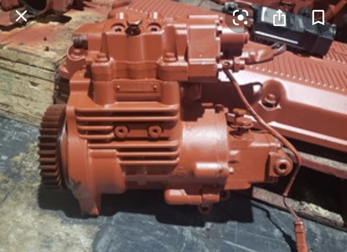

Smaller one is 2 plunger, larger one is 3
2-piston pump...
./uploads/202009/post_1621_1601221379_dc3b60bb94f7a7a96ca000273fed23e8.jpeg
3-piston pump...
./uploads/202009/post_1621_1601221395_03a1a8b4977254931341d086d8e64918.jpeg
 Thanks given by: JimT , boss_trucker
