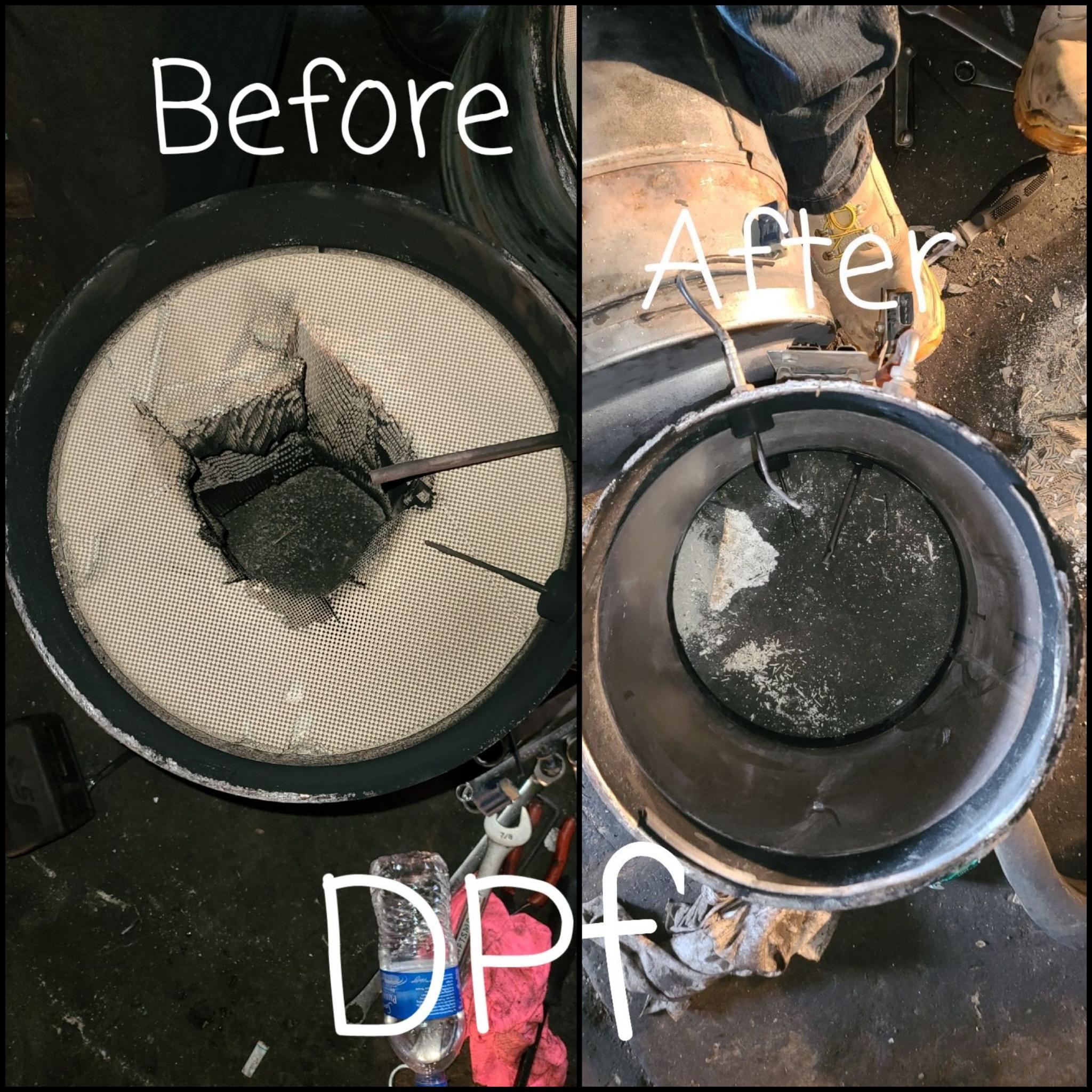

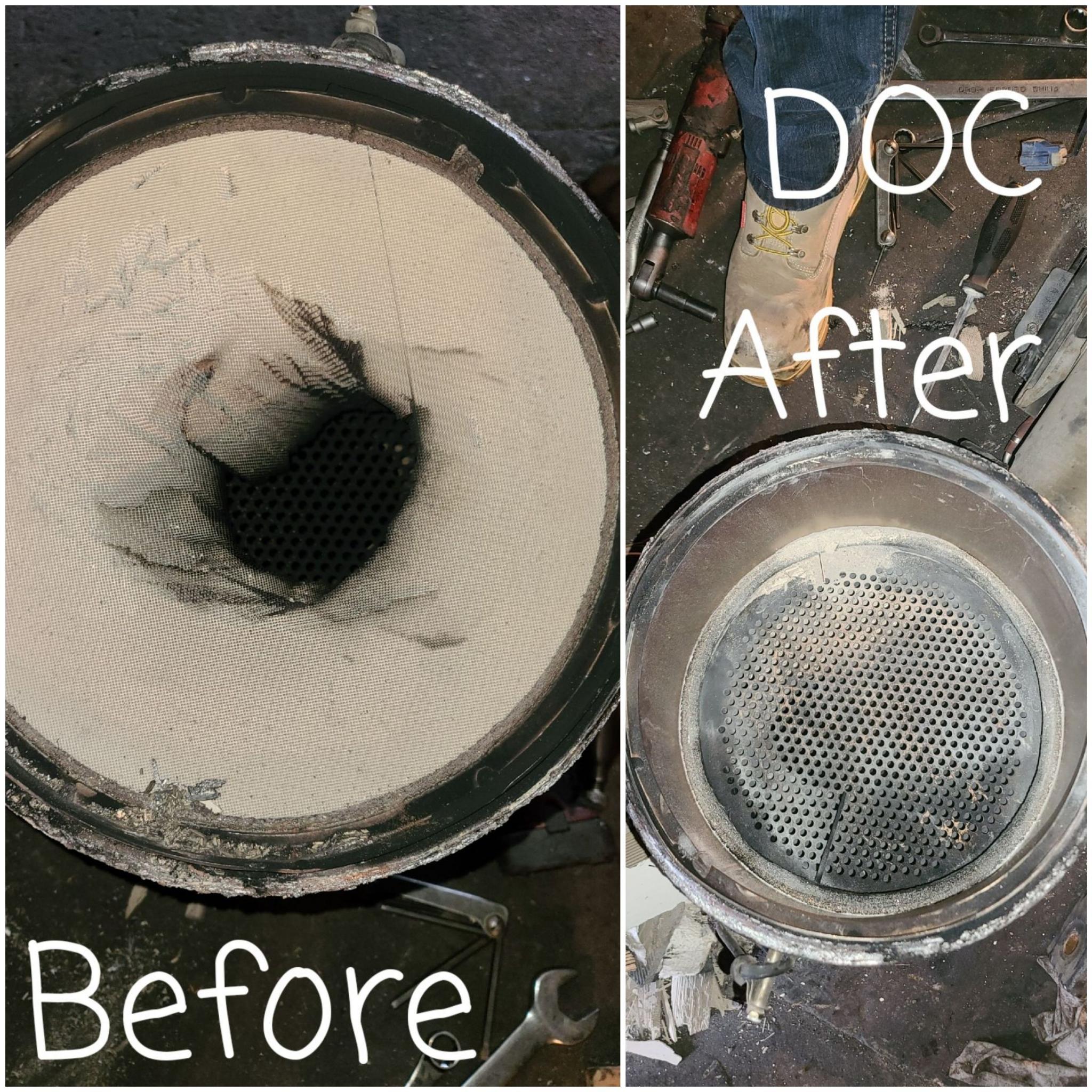

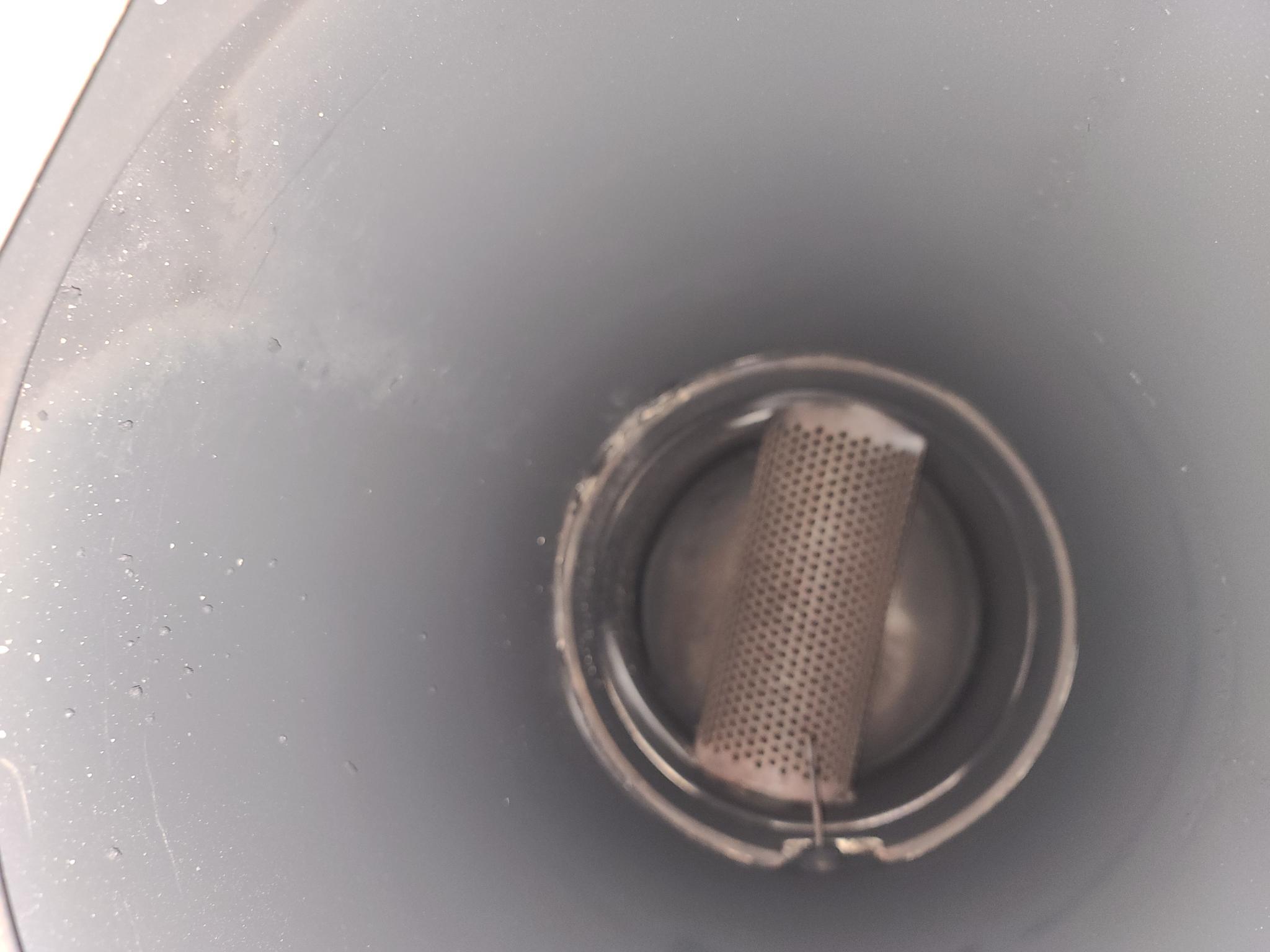

So a little update on today's accomplishments.
We took off the Cans to get them hollowed out. To my surprise the only one that was hollowed out was the SCR Can, the others had a hole on them maybe 4-5 inch in diameter. I'm attaching before and after photos for your entertainment. That's what a $2500 "delete" around regular shops buys you.

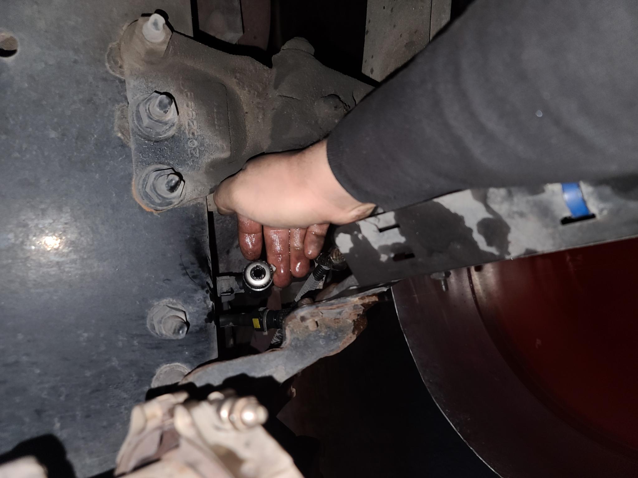

On the last picture, I broke a coolant hose when I was taking of the SCR. I think it goes in to the Decomp Tube? Should I replace the hose to get it back to how it was or can it be clamped off(cancelled)??

If is all hollowed out , the 2 coolant tubes is not needed. can be capped or bypassed.
