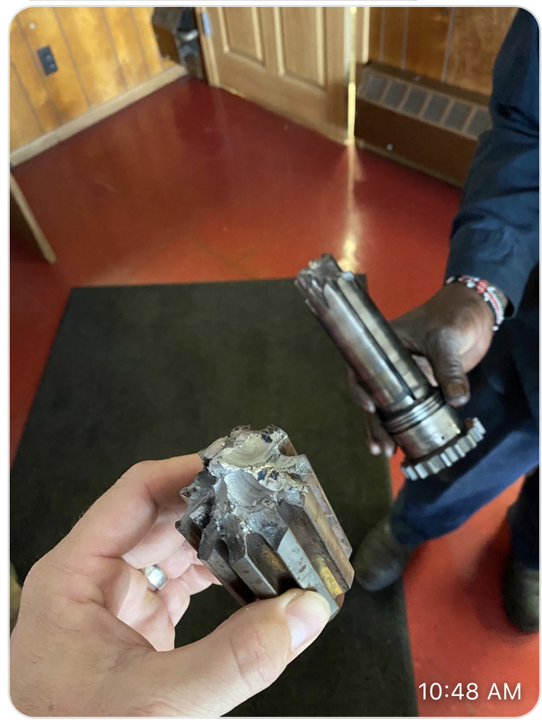

./uploads/202012/post_1621_1608694718_3d3747108526766324dab139041fd202.jpeg

^that came out of a 550 whp dd15 doing heavy haul, but I’ve replaced enough destroyed clutches

that photo looks like abuse ... or mis-alignemnt.

I know the driver/owner
I’d say abuse or lack of care

Im curious, what about that snapped input shaft looks like abuse? I know Rawze has said he used to failure analysis for large corporations. I'd like to know what he sees that says that.
That thing looks like it was barely used. I can't see any grooves worn in it from being in the clutch very long. I would've leaned toward flawed steel. But thats why I'm curious what looks like abuse.

same here ... it does not look like it was worn down.
