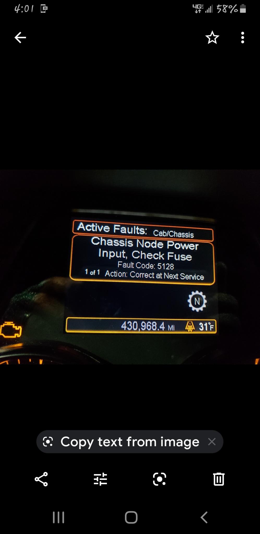

| 02-10-2021, (Subject: Chassis Node fault code 5128 ) Post: #1 | |||
| Chassis Node fault code 5128 | |||

| RE: Chassis Node fault code 5128 pull all battery cables and let it sit for 30 min then re-connect. paccar chassis controllers are flaky and need a hard reset on occasion. User's Signature: ->: What I post is just my own thoughts and Opinions! --- I AM Full Of S__T!. | |||

| RE: Chassis Node fault code 5128 $7500 for two harnesses is a lot of money. Did they say what harness and where they rubbed? Had something similar on my truck. Found dirt in loom around harness had rubbed a few spots in my harness. Took a little work, but I was able to find the wires by pulling the loom back and looking. Fixed the bad spots and a year later no troubles. User's Signature: 2015 Kenworth T660 | |||
