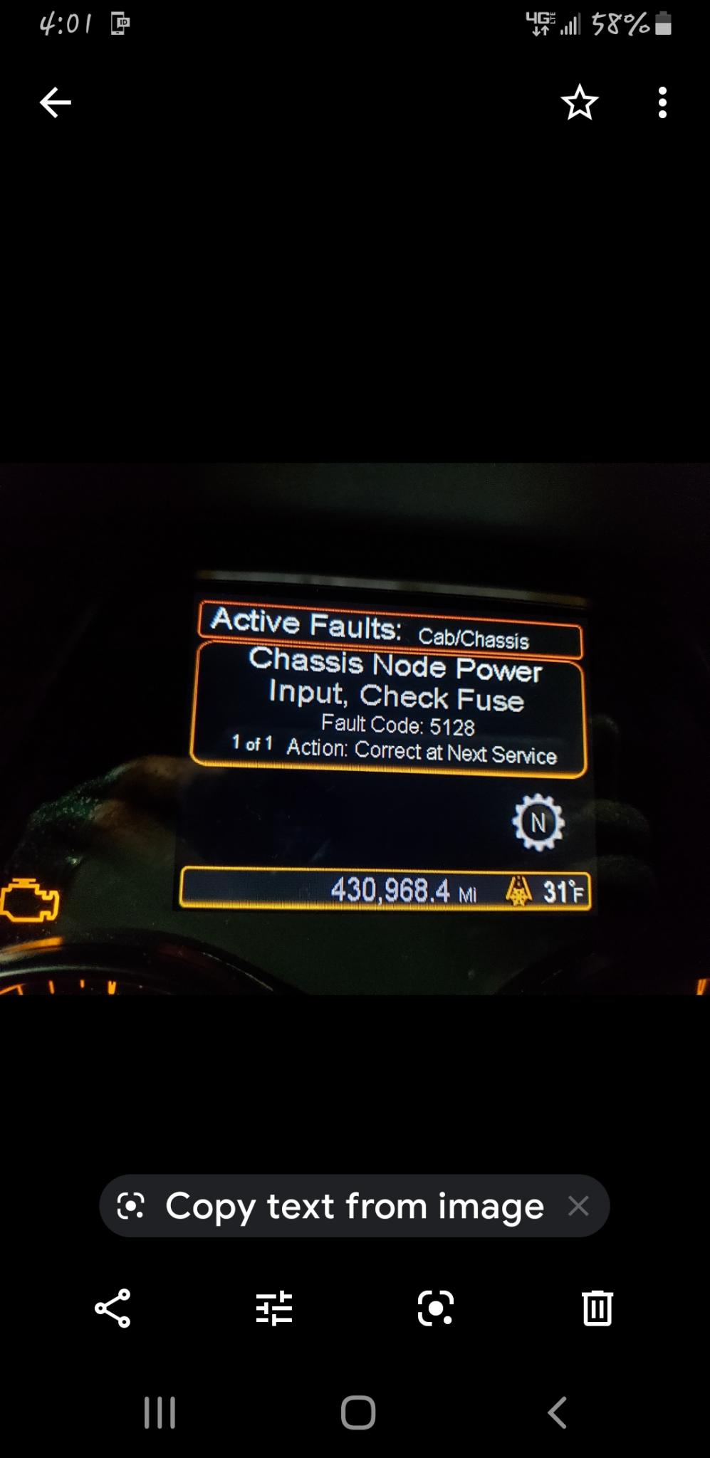

Im new here and looking for help with 2016 Pete 579, Chassis Node fault code 5128. I took it to the dealership and they wanted to charge ne $7500 to change2 chassis harnesses they said rubbed together caused this fault and also stopped my windshield washer fluid from working. Any suggestions?

pull all battery cables and let it sit for 30 min then re-connect.
paccar chassis controllers are flaky and need a hard reset on occasion.

$7500 for two harnesses is a lot of money.
Did they say what harness and where they rubbed?
Had something similar on my truck. Found dirt in loom around harness had rubbed a few spots in my harness. Took a little work, but I was able to find the wires by pulling the loom back and looking. Fixed the bad spots and a year later no troubles.
