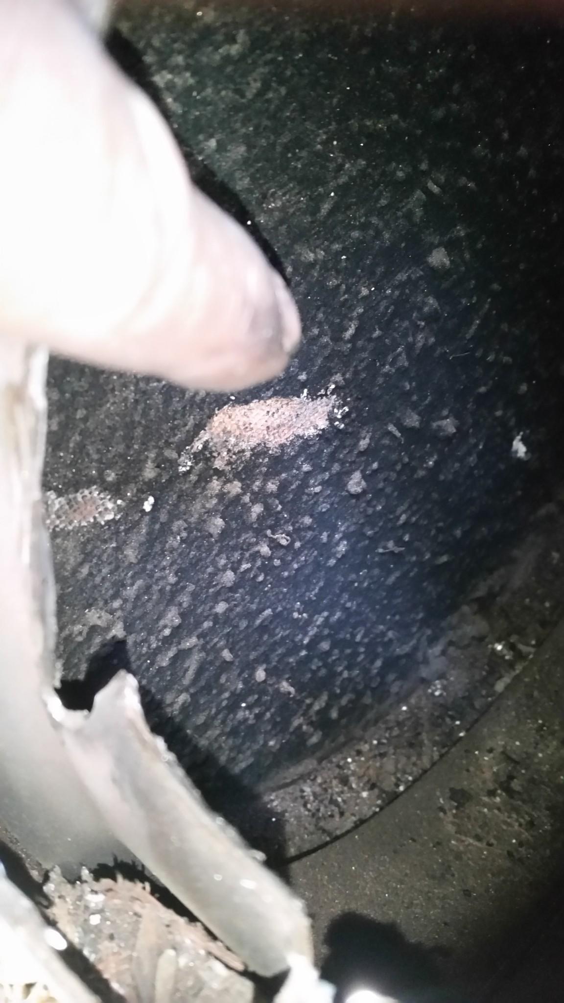

So,. This person stopped by here this Easter weekend. Really nice person by the way, I enjoyed their company. I help them review their programming. It was horrible to say the least. SOme company in Pensilvania did it that does a lot of delete programming and pushes the fixed-vane turbo's etc.. like a bunch of complete idiots.

* The SCR can was never hollowed out. It got so clogged up with soot that it was causing harm to the engine and turbo.
* Programming was horrible. The typical 'Jail-Break', set as few settings as possible to get the alarms out of the dash and hope-for-the-best type of engine destroying programming.

THEY ALSO DID NOT do the hardware mods correctly...
* They did not remove the Intake air throttle valve, it was causing low boost problems... even though the turbo was over-spooling all the time to try to overcome it.

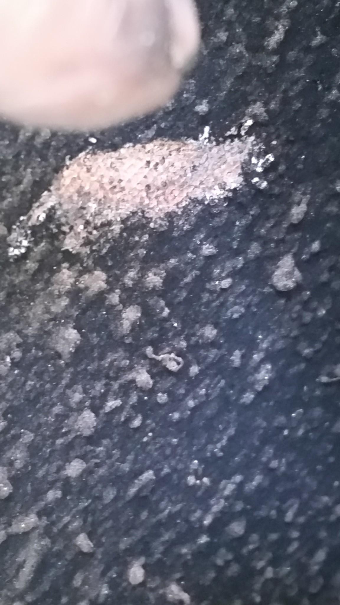

* They also did not hollow out the SCR canister. - This truck has run for 4 months, slowly loosing power and fuel mileage slowly dropping off.. then some of the gaskets between the exhaust cans blew out causing a massive exhaust leak under the passenger steps opf the truck. - THIS IS BECAUSE THE IDIOTS WHO DID THE DELETE DID NOT HOLLOW OUT THE SCR CAN AND TOLD THE TRUCK OWNER THAT IT WAS A PASSIVE DEVICE AND THAT IT DID NO0T NEEDD IT! -- HERE IS WHAT THIS TRUCKS OWNERS SCR CAN FACE LOOKED LIKE AFTER 4 MONTHS OF THIS NONSENSE LAZYNESS GARBAGE!!!!...
100% BLOCKED UP AFTER 4 MONTHS OF RUN TIME!!!
-- HE IS LUCKY HE HAD NOT LOST HIS ENTIRE ENGINE YET! due to the completely face-plugged SCR CANISTER that the delete shop idiots told him was not necessary to do... I SEE THIS WAY TOO OFTEN.. THESE DELETE SHOPS ARE COMPLETE RETARDS IF THEY THINK THAT SCR CAN IS GOING TO STAY CLEAN ALL ON ITS OWN!!!
-- really... I just don;t get it.... I shake my head in dismay at how utterly stupid these people and places really are.

Looks like coolant on that dpf doesn't it ?
04-07-2021, (Subject: Looking for help/advice on truck ... )
RE: Looking for help/advice on truck ...
(04-07-2021 )tree98 Wrote:  Looks like coolant on that dpf doesn't it ?
I was thinking the same thing... however the front face of an older SCR element is usually tinted slightly reddish to begin with though.
