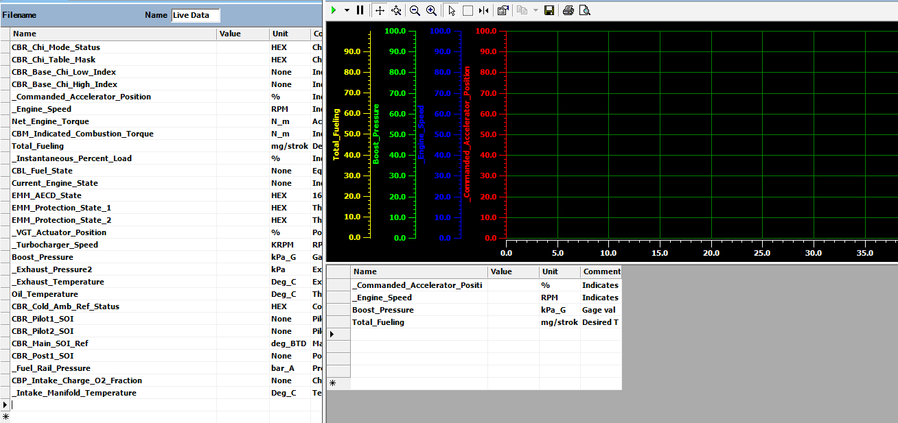

This is the screen you (or your mechanic) should be watching to see what that engine was doing.. both before and after that delete occurred. It reveals engine mode, injection timing, turbo position, and most all the other top-most important stuff on what is going on with the engine...
./uploads/202108/post_2_1629654133_d9f683f6222991ee232aa2de2c4a36f2.png
(right click and choose "View Image" for a larger view).
