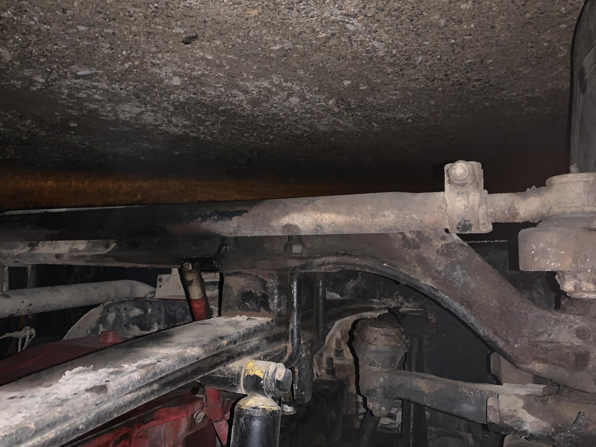

|  Is oil and smoke normal on the crankcase breather hose    04’ cm870.Is it normal?    |  |||
|    10-06-2021, (Subject: Is oil and smoke normal on the crankcase breather hose )   Post: #2   |  |||
|  RE: Is oil and smoke normal on the crankcase breather hose    CM870's do not have a crank case filter to help collect oil fumes like newer model engines do. The crank case fumes vent directly into that tube.  How much oil get out is totally dependant on how old the engine is and how much blo-by there is. ref: http://rawze.com/forums/showthread.php?t...22#pid9322 User's Signature: ->: What I post is just my own thoughts and Opinions! --- I AM Full Of S__T!.  |  |||

 RE: Is oil and smoke normal on the crankcase breather hose  (10-06-2021 )Rawze Wrote: CM870's do not have a crank case filter to help collect oil fumes like newer model engines do. The crank case fumes vent directly into that tube. Thanks Rawze. I don’t know why the pic is upside down lol.  |  |||
|    10-07-2021, (Subject: Is oil and smoke normal on the crankcase breather hose )   Post: #4   |  |||
 RE: Is oil and smoke normal on the crankcase breather hose  (10-06-2021 )Rawze Wrote: CM870's do not have a crank case filter to help collect oil fumes like newer model engines do. The crank case fumes vent directly into that tube. I got to thinking about this some more and realized that I was only seeing a little smoke come out of the hose every once in a while and a little oil residue but now it’s constant smoke and more oil.What could have changed?  |  |||
|    10-07-2021, (Subject: Is oil and smoke normal on the crankcase breather hose )   Post: #5   |  |||
|  RE: Is oil and smoke normal on the crankcase breather hose    Post a video of what your seeing     |  |||
|    10-07-2021, (Subject: Is oil and smoke normal on the crankcase breather hose )   Post: #6   |  |||
|  RE: Is oil and smoke normal on the crankcase breather hose    https://imgur.com/a/AMKUoZI   Not a very good video but once I turn on the flashlight you can see the smoke towards the bottom.  |  |||
|    10-07-2021, (Subject: Is oil and smoke normal on the crankcase breather hose )   Post: #7   |  |||
|  RE: Is oil and smoke normal on the crankcase breather hose    Looks a little excessive. Do this and see what you get   https://youtu.be/-Og4jCM6Rfg Could be time for an inframe.  |  |||
|    10-08-2021, (Subject: Is oil and smoke normal on the crankcase breather hose )   Post: #8   |  |||
|  RE: Is oil and smoke normal on the crankcase breather hose    https://imgur.com/a/K5FVWXe   Here’s a daytime video.The smoke is a little harder to see on this one but when I move the camera closer you can see it.  |  |||
|    10-08-2021, (Subject: Is oil and smoke normal on the crankcase breather hose )   Post: #9   |  |||
|  RE: Is oil and smoke normal on the crankcase breather hose    Personally I don't see anything alarming     |  |||
