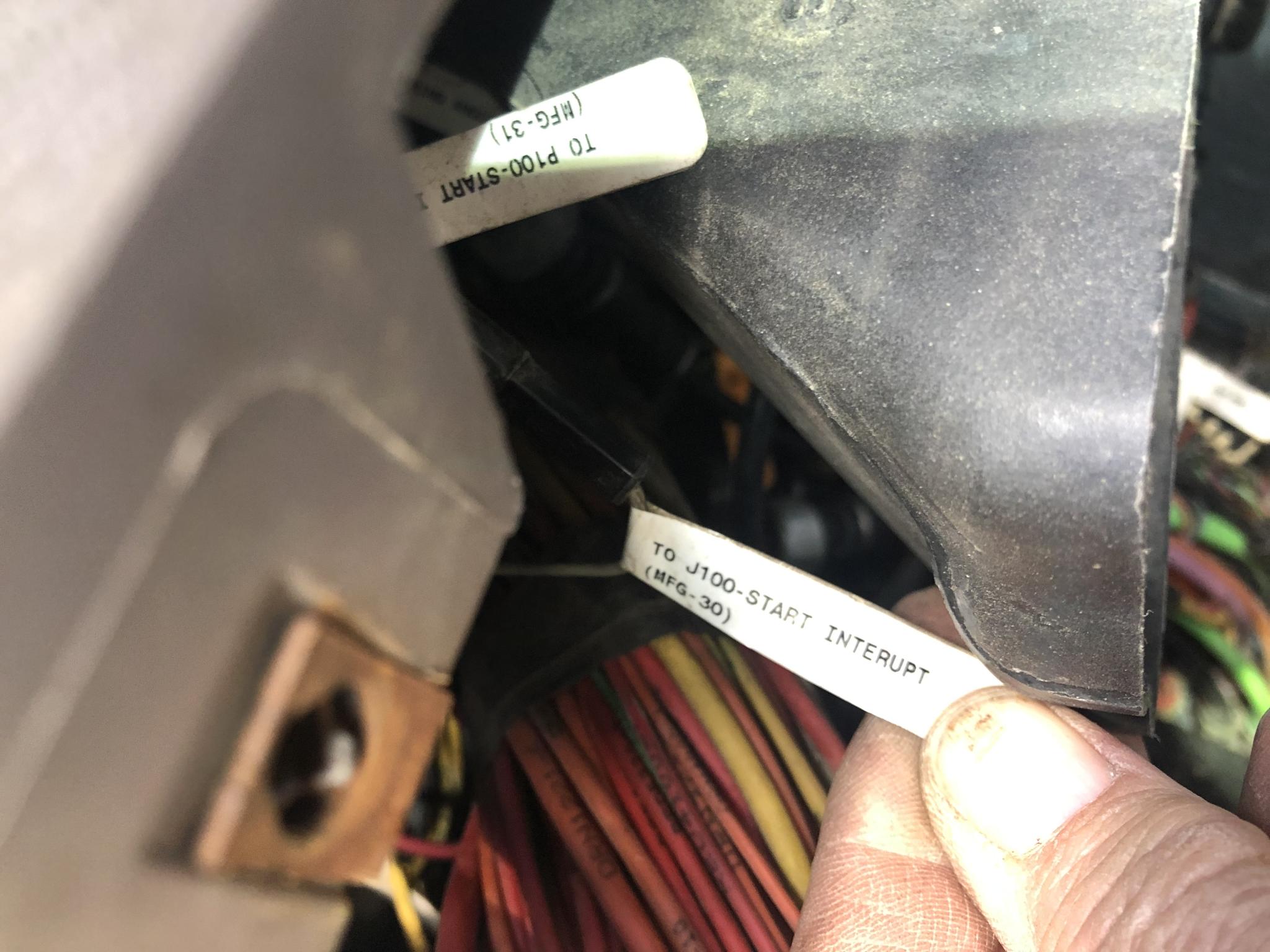

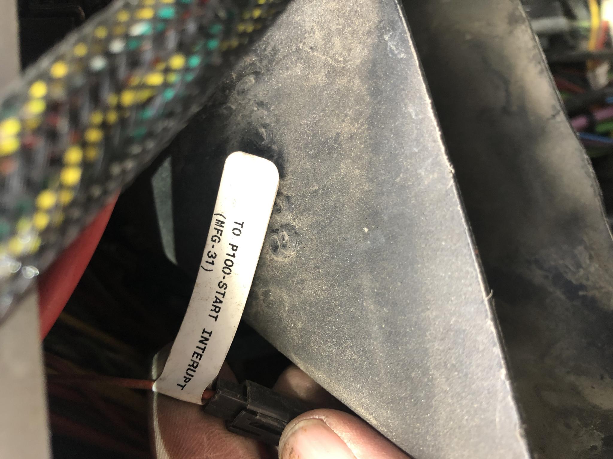

   [attachment=8323I found these connectors under the dash. Can anyone interpret these numbers?
03-06-2022, (Subject: Turn key, no start )
RE: Turn key, no start
They probably correspond with the wiring schematic. Not very useful without it.
 Thanks given by: Mrkentee
(03-06-2022 )tree98 Wrote:  They probably correspond with the wiring schematic. Not very useful without it.
I unplugged and no starter at all. There’s supposed to be a relay for that system you can bypass, but I can’t find it, or the starter relay. It’s like there’s another fuse panel somewhere that I just can’t find.
