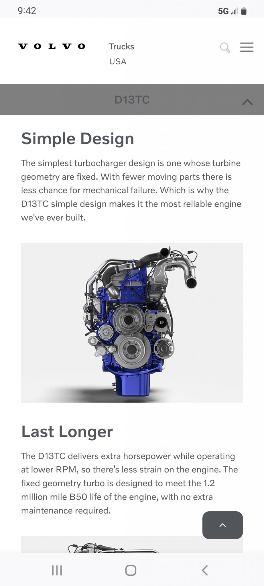

Hi guys, what do you think about new volvo engine d13tc which uses turbo compounding. They went with regular turbo and there is 2nd device which somehow transmits some power from exaust gasses back to the engine. Facebook is full of people claiming to get very high mpg from this trucks. 10+ mpg . I think it is not possible, but people are posting it. I wouldn't buy truck with new technology, but it is interesting to know about it.

(07-03-2022 )Konstantin Wrote:  Facebook is full of people claiming to get very high mpg from this trucks. 10+ mpg
Not with a fixed vane turbo, nope ain't happening.

1.2mil B50 life......hmmmmm

(07-04-2022 )SquareOne Wrote:  1.2mil B50 life......hmmmmm
Yea total joke.

cummins still claims B50 at 1+ million on their newer engines too. I would think this would be true if you never ran it below 1500RPM's.. but reality dictates otherwise on the roads these days.
We are seeing clearly that has these horribly spec'd tall rear ended trucks that are everywhere now, lugging the guts out of the engines all in the name of limiting HP to save fuel artificially. Bacause of this, just about everything at 1850-trq and higher is a B50 of only about 650k, and roughly about 900k on 1750trq.
That is being lenient and assuming ppl change out their fuel pump guts regurlarly ..lol, but we know better for that one too.
- ALL due to a new industry standard it seems of total garbage rear ends that lug the engine into a slow agonizing death, running them at the bottom end of their working range due to innovations in how to get more bottom end torque out of a diesel engine that was never meant to have it.
Because of this reality, and because I don't see that engine as being one with longer connecting rods in it. ... well, you know where my opinion goes real fast on that one.

It is , I looked up volvo in Europe, they are really agonizing about mpg, because diesel cost almost 2 times more. They have all kind of weird fuel savings things. So, they went with a fixed turbo too and this compounding device. You could check it out yourself. Also their trucks do get up to 11 mpg , but speed is way less than here. I think 50mph or around that.

Yes, they do it. I see posted picture and was scratching my head. Cruising speed was 65 mph and rpm just 600. But maybe he was going downhill or something...
I think they will abuse trucks and then just sell them before any catastrophic failure.
And buy a new one. So , maybe it makes sense for them. If mpg is really that high, which I doubt... Also dd15 removed this turbo compounding from our engines, because with our terrain they didn't see much benefit.
