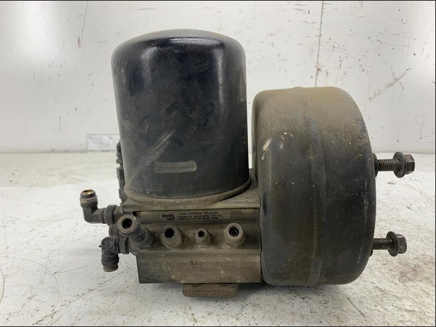

Also if your air-dryer-regulator is going bad, you will get less pressure than 90 psi. Air dryer-regulator is cheap compared to the compressor or that block.. so that is the thing to replace first if it is more than 5 or 6 years old, along with checking for leaks like mentioned above.
Whare is the air dryer regulator. That's not the governor is it?
Both tanks fill equally and I only loose air at night down to 90psi I am always looking for leaks and have changed a bunch of push fittings.
07-29-2022, (Subject: Sleeper air bags )
RE: Sleeper air bags
(07-28-2022 )earnies2 Wrote:  ...
it looks like this...
./uploads/202207/post_2_1659095442_a68ba4d635dfc3d2b245cba5eb402b2d.png
Like I said.. leaks that only happen above 90 PSI.. can usually only be found while the pressures are above this ...+ the key-switch in the dash has to remain on but the engine not running.
Someone has to run the truck and build the air all the way up to 125+ psi for both tanks.. then turn the key-switch off.. only barely long enough that the engine stops running, then right back into the on position, so that all the systems stay active without the engine turning. Then jump out real quick and listen for hissing, air leaks, etc. right away before the air bleeds off down to 90-psi.
