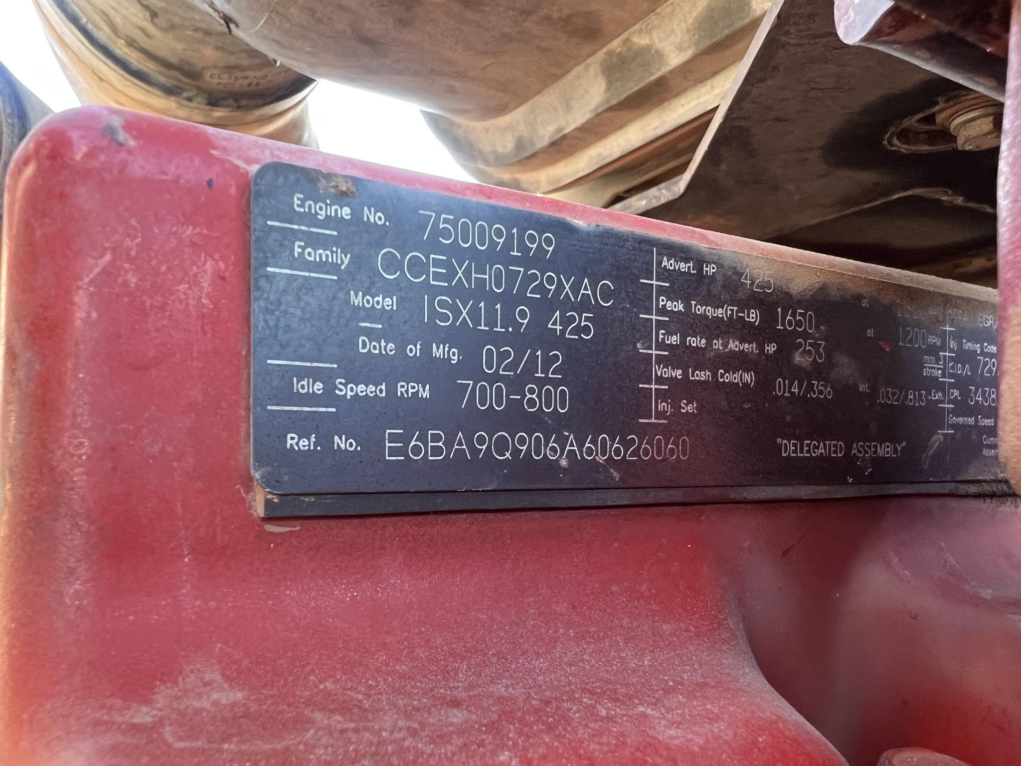

Here’s the engine data plate on one of the ISX 12’s

Thats a X12 we dont see much failure in those like we do the isx15
 Thanks given by: Redland1
10-31-2022, (Subject: Do Tappets need to be replaced on an ISX 12 2250 fuel pump? )
RE: Do Tappets need to be replaced on an ISX 12 2250 fuel pump?
(10-31-2022 )Mr Hagg Wrote:  Thats a X12 we dont see much failure in those like we do the isx15
So they don’t need the updated tappets?
