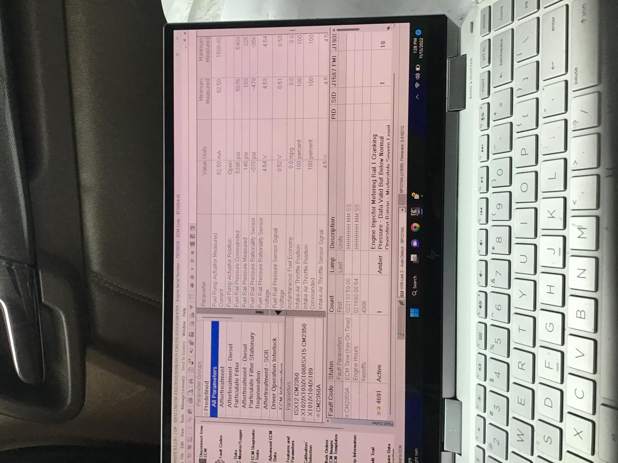

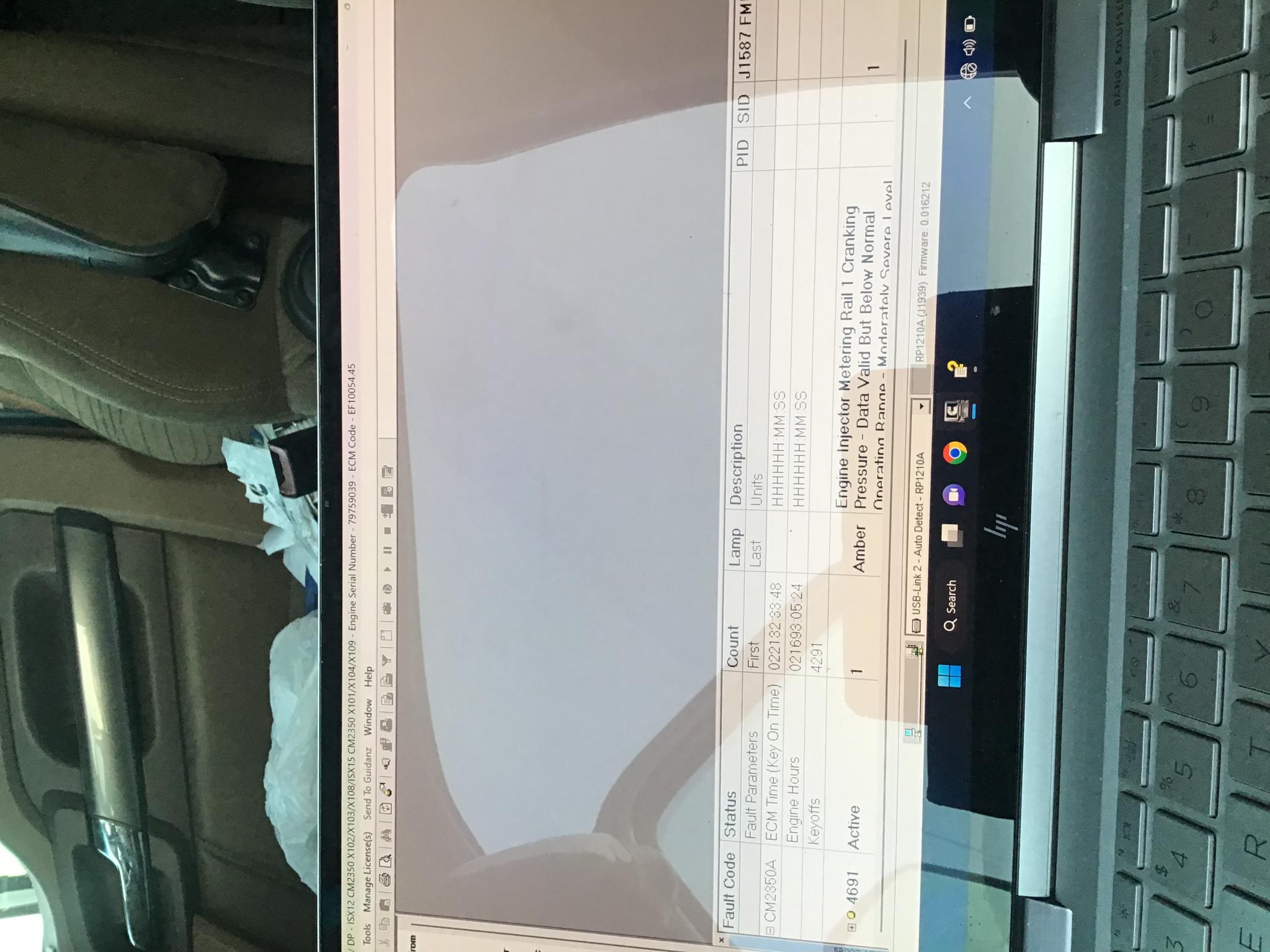

| RE: Hello everyone. Code 4691 help The fuel rail pressure commanded is 5395 and the fuel rail measured is only 141 psi. Fuel rail nationality sensor is -434psi. It has me stumped fuel filters full etc. | |||

| RE: Hello everyone. Code 4691 help You got a serious leak somewhere obviously. What all did you have apart when you put the rings in? | |||
| 11-15-2022, (Subject: Questions on my isx 15_continued ) Post: #9 | |||
RE: Hello everyone. Code 4691 help (11-15-2022 )tree98 Wrote: You got a serious leak somewhere obviously. What all did you have apart when you put the rings in?I took loose fuel rail ,quell lines and the tubes to pop the injectors out to put the retaining rings in. That’s it torqued it’s back down. Im a take it apart again tomorrow to double check everything. | |||
