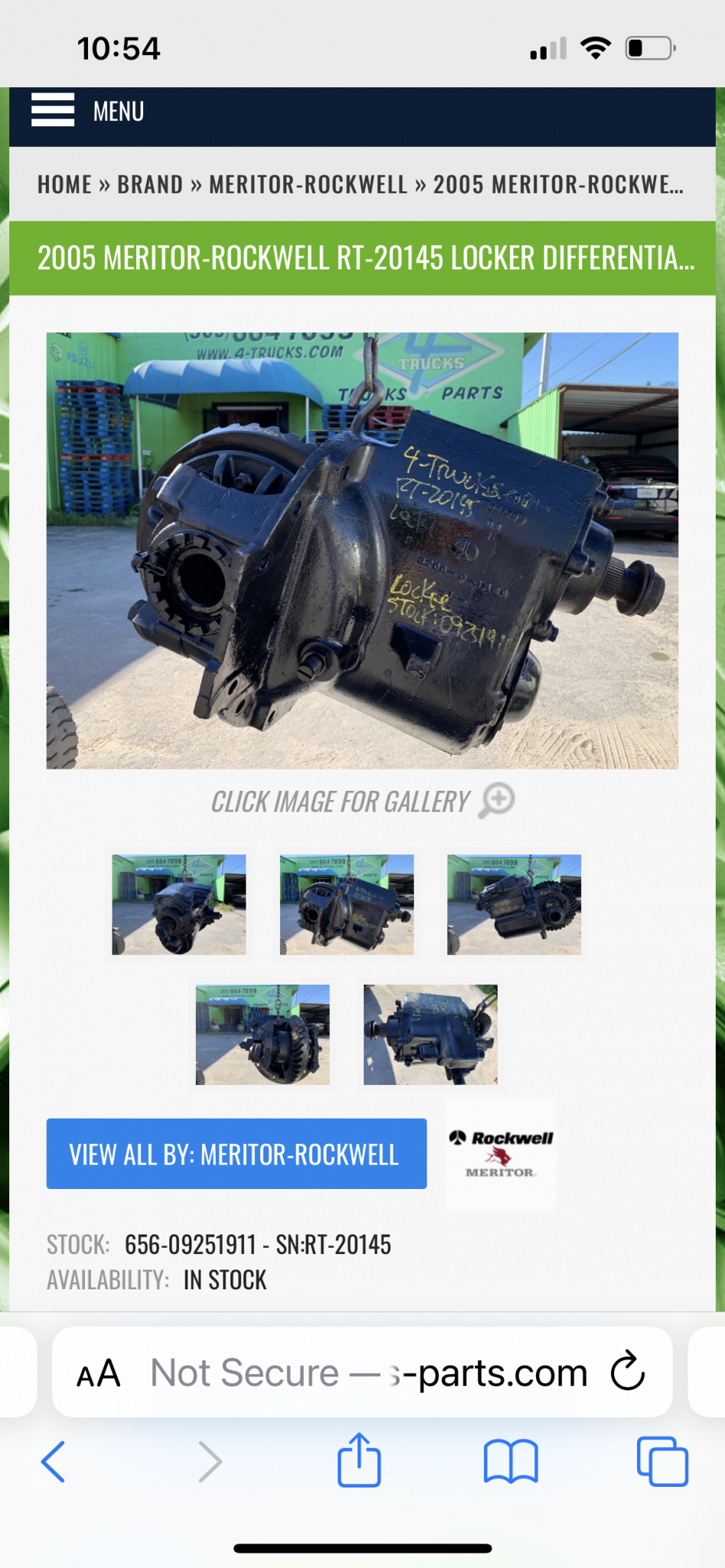

I’m wondering if there’s much of a difference with the years for rearends ? Would something like this work for the front rear ? Currently have “2017 MD2014x 325’s” just curious as to what is interchangeable
This is a “USED 2005 RT-20145 FRONT MERITOR-ROCKWELL NEW WORLD DIFFERENTIAL WITH R:3,90 LOCKER, COMPLETE, INSPECTED READY TO WORK.”

(12-12-2022 )BrandonOlsen Wrote:  I’m wondering if there’s much of a difference with the years for rearends ? Would something like this work for the front rear ? Currently have “2017 MD2014x 325’s” just curious as to what is interchangeable
That for sale link is for the older style Meritor axle. Yours is the newer model they have been using for the last 10 years or so. The newer ones do cost more to replace than the older ones and they are NOT interchangeable.
