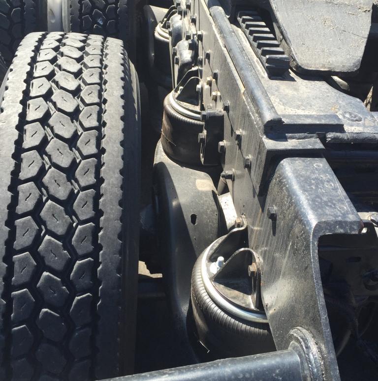

./uploads/201605/post_602_1464281922_55a7bc2f29fb9faedaecea2b1b8b68db.jpeg
Coming back to update the progress.
The KW air ride 8 bag set up has been worth it. It rides better than my 4 bag set up on my 9900ix. It was a nice surprise when I loaded it with 44k on the wagon.
The project turned into more money and time because my top mounting plates were degraded. So I had to buy new top mounting plates.

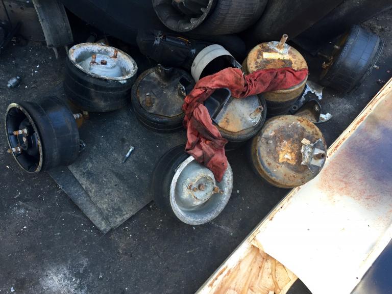

./uploads/201605/post_602_1464282140_d4101947fb5b9e5ee1265f0a63b988e2.jpeg
Pain in the ass but finally in there.
