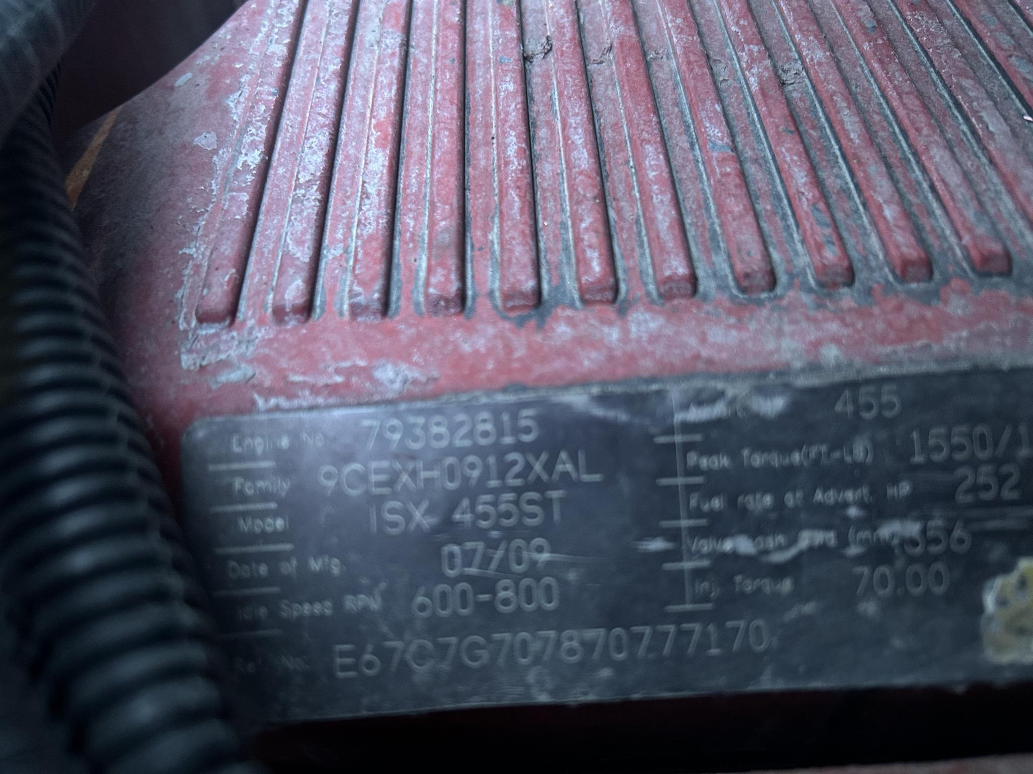

(02-04-2023 )mxmom777 Wrote:  79382815 is the engine serial number.
The DPF is an aftermarket Skyline emissions 1280.
What do you mean the AV10051.xx program

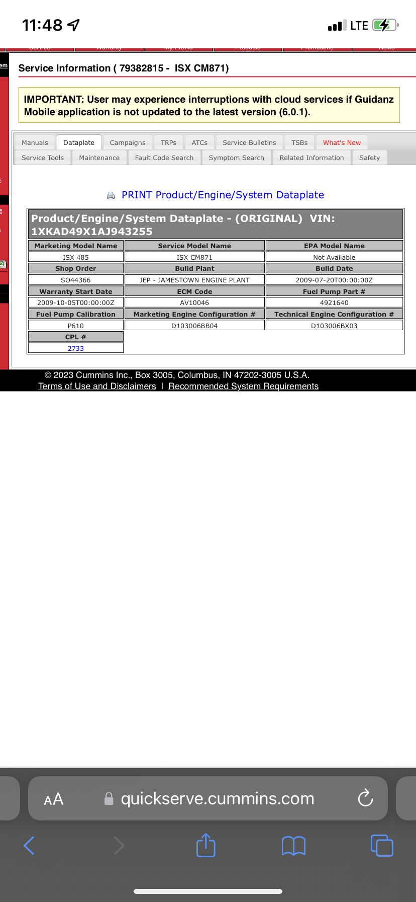

Shows here on quickserve you need an av10046 in your ecm.

First of all. you need an OEM DPF unit. After-garbage DPF's have always been problematic.
next...
That engine is originally supposed to have program AV10046.xx in it.. HOWEVER.. after 2015, they updated ALL of the DOC and DPF units for those trucks, and the old units are not even sold any more.
The DPF you were supposed to have that came with it when the truck was new is part# 4969702. <- That unit stopped being sold and was no longer available after Nov,2015 due to issues with them. The replacement is part# 5297522.
The replacement DPF units all required a change in programming as well .. so this means, after 7+years later ... that your engine is supposed to have program AV10239 in it and your CPL changes to CPL3749.
so ... This is why I pointed this out. Your screen shot shows you using a program that was invalidated back in 2015 due to newer DPF units that were supposed to come out. -> .. and those old DPF units should not even be used, but only the newer ones for about 7+ years now. This means that you should NOT even be using that program if your DPF was replaced with an OEM one at some point during or after 2015.

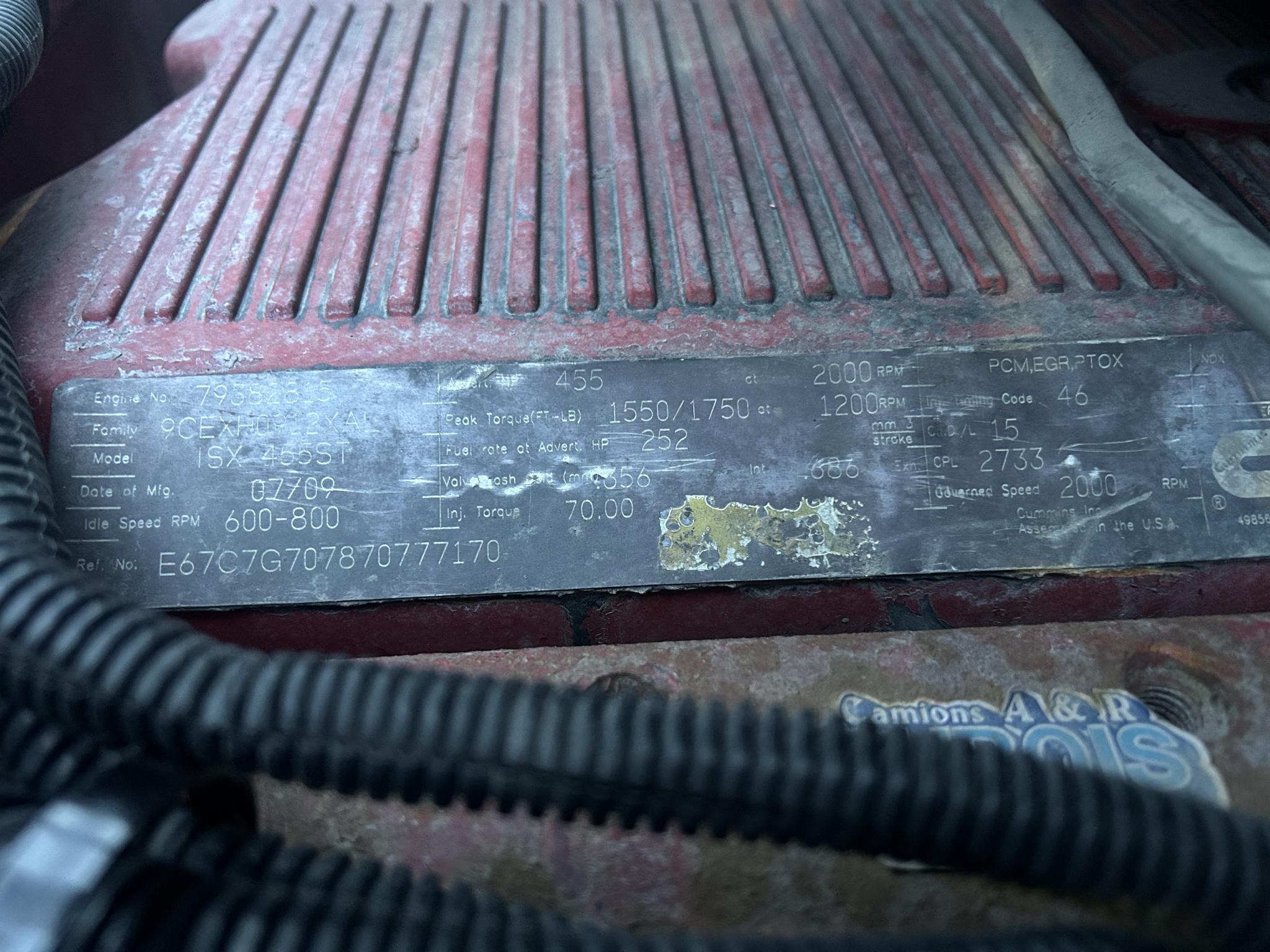

Ok, found a clue as to what might be going on.
Purchased truck used not quite a year ago. We were told and given paperwork to confirm it had new head and machined the block.
The sticker on engine is serial # 79382815. Turns out, This was a complete engine swap prior to the engine work even being done. This engine belonged to a 2010 KW T660.
Our truck is an 09 KW T800. The engine serial number that matches our truck VIN (last 7 digits being J939104) is serial# 79295149.
When our truck is plugged into insight I think it might be picking up the T660 programming and not the programming for our original off the lot engine serial # 79295149 T800.
The Kenworth dealership is using the replaced engine serial # 79382815 but I’m not sure if this would use the same program and calibrations as the T800?
Please help.

Insite is seeing the program that is in the engine that's in your truck right now.
You're going to need the right program for that engine and the proper aftertreatment system that goes with that engine, or demandate it and stop pouring money into it.
