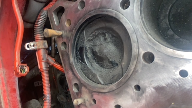

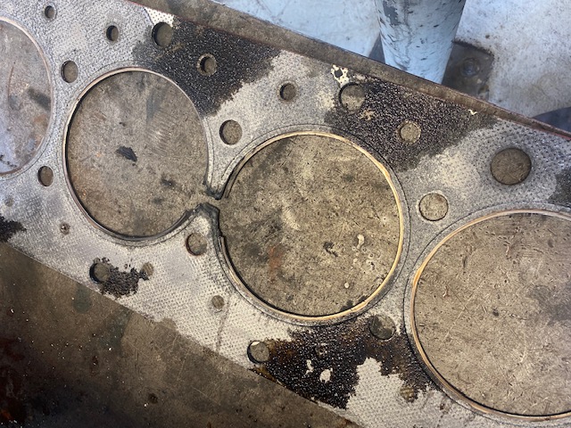

RE: Overheated isx This poor victim I had to inframe and replace the head due to the injector cups leaking, not to mention the eching in the casting between 3 and 4 from the blown gasket User's Signature: Repairing Demandates 1 Truck At A Time | |||

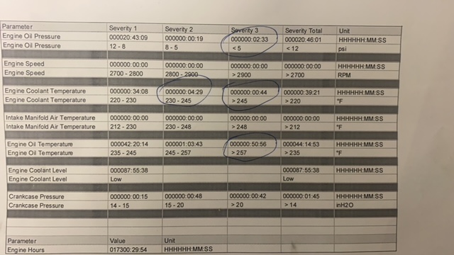

RE: Overheated isx Man, when I was looking at trucks, I would study these abuse reports (along with all the other ecm info), just to make the decision to fly out and physically see any truck I was interested in. The amount of trucks I came across with some rough reports were pretty damn surprising. High coolant, high oil temp, plenty of 'low coolant time,' some low oil pressure time...I came across one with a handful of hours logged in the crankcase pressure column on a fairly low hour engine. The truck I bought was just about the best I could find as far as abuse went and it still logged 30 sec of Severity 1 coolant temp and 8.5hrs of Severity 1 Engine oil temp within the total engine hours of 8900. | |||

RE: Overheated isx (05-24-2023 )RollinCoal Wrote: This poor victim I had to inframe and replace the head due to the injector cups leaking, not to mention the eching in the casting between 3 and 4 from the blown gasket someone better pray like h$ell that block has not gotten etched between those cylinders. If so, then its a boat anchor. User's Signature: ->: What I post is just my own thoughts and Opinions! --- I AM Full Of S__T!. | |||
05-26-2023, (Subject: Overheated isx ) Post: #7 | |||
RE: Overheated isx block wasnt hurt, ran hot enough the liner seals filled the oil pan with coolant User's Signature: Repairing Demandates 1 Truck At A Time | |||
