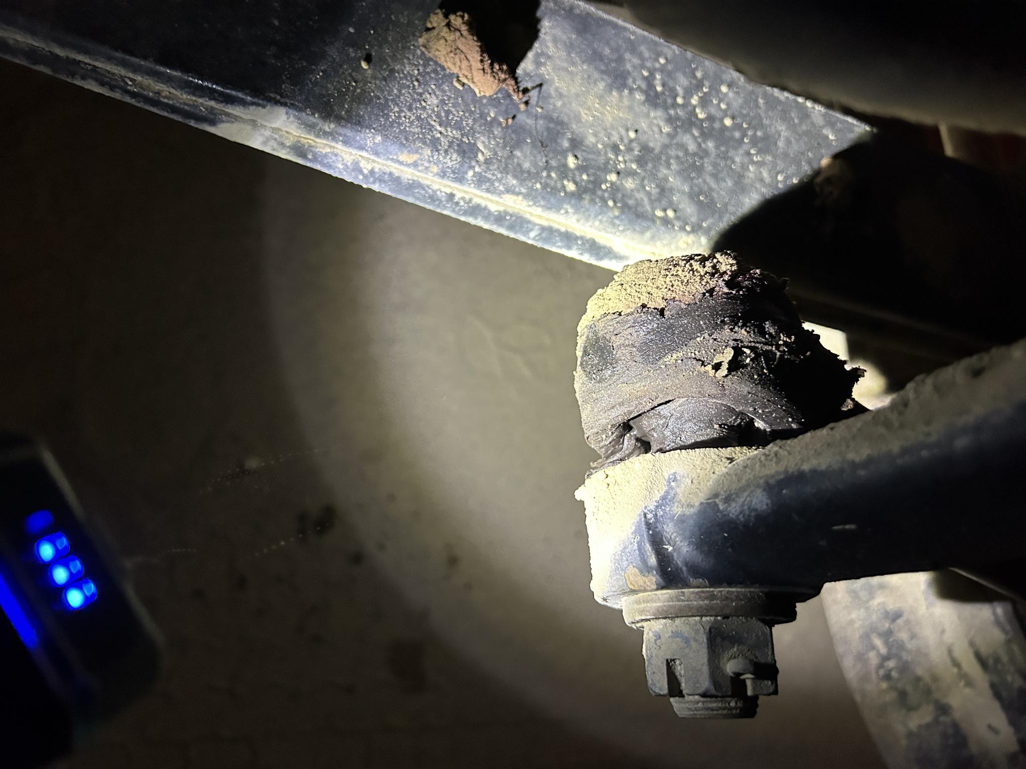

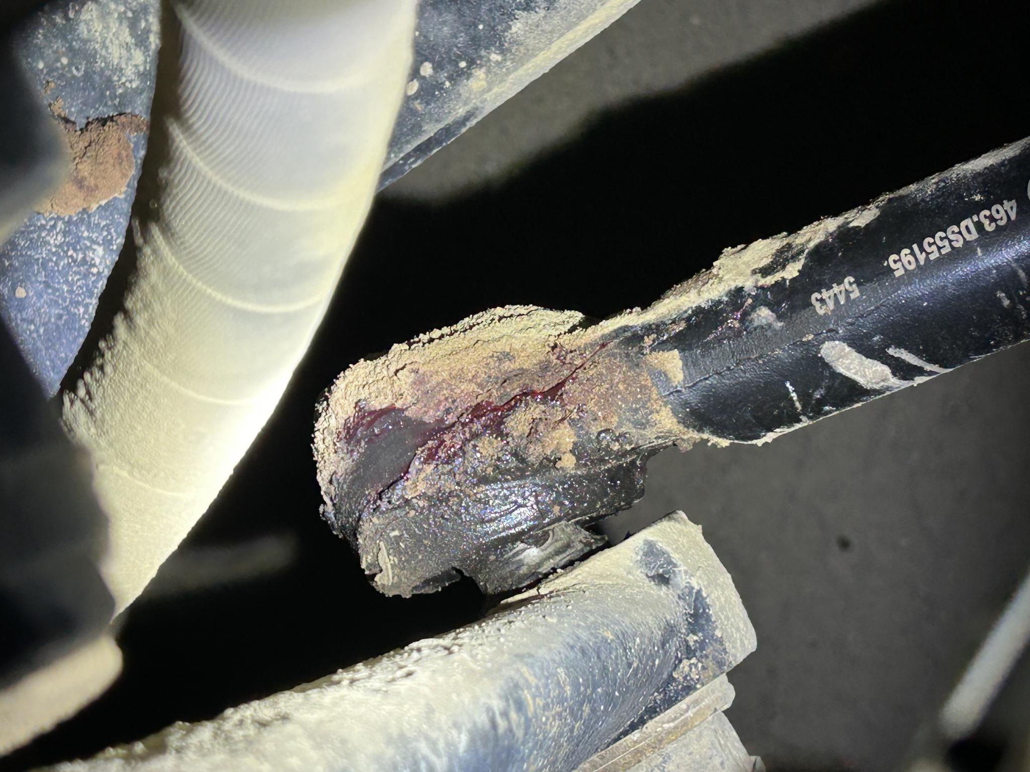

Popping noise when turning or going over bumps.Is the drag link bad? I’ve been getting a pooping noise when turning or going over bumps and thought it was the spring bushings but the drag link looks off. | |||

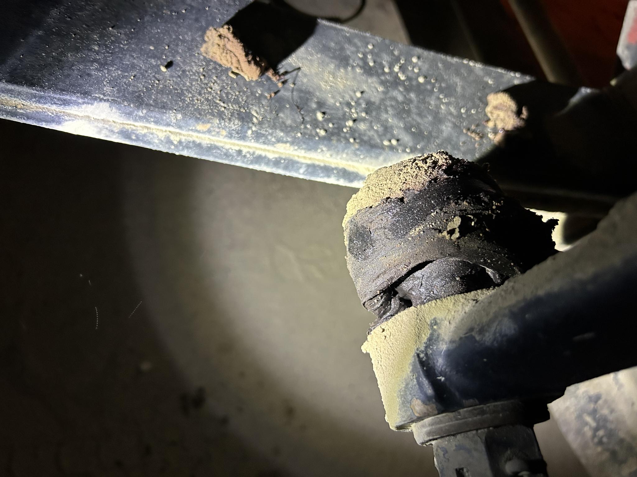

RE: Popping noise when turning or going over bumps.Is the drag link bad? Here’s another angle | |||

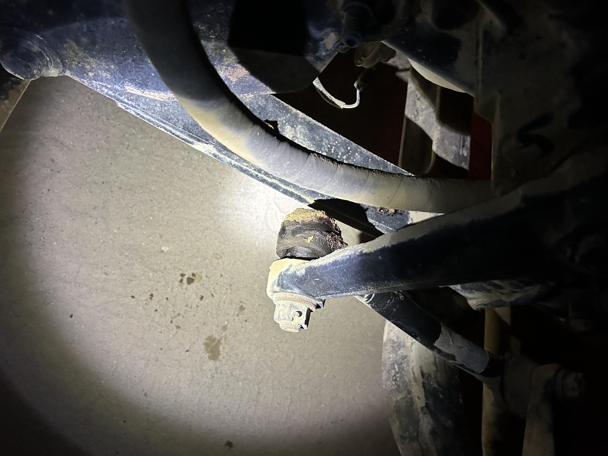

RE: Popping noise when turning or going over bumps.Is the drag link bad? And another | |||

RE: Popping noise when turning or going over bumps.Is the drag link bad? Definitely looks suspect. Have someone turn the steering wheel back and forth quickly while your watching it. Any play at all and it's shot. It's also very unsafe to drive it if it is worn out, not mention a guaranteed red tag. | |||
11-16-2023, (Subject: Popping noise when turning or going over bumps.Is the drag link bad? ) Post: #5 | |||
RE: Popping noise when turning or going over bumps.Is the drag link bad? See if it has any in and out play at the joint. If it does, then its shot!. It can be checked by someone yanking the steering wheel hard one way, and then the other way rapidly with the truck turned off ... and someone else observing that joint (and others) to see if it has any in/out play. BTW: That particular model of drag link is known to wear out like that and cause serious truck accidents!. It is nothing at all to play around with, and can kill someone!. User's Signature: ->: What I post is just my own thoughts and Opinions! --- I AM Full Of S__T!. | |||
