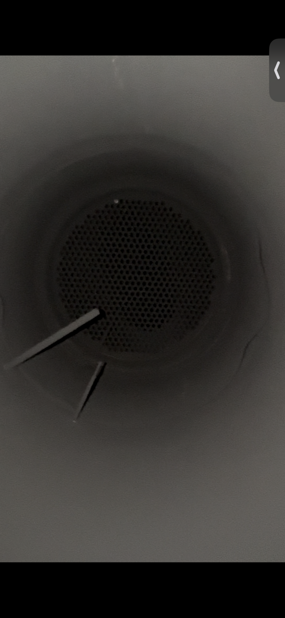

| De-mandate dpf Recently had a shop de-mandate a 2015 cummins isx cm2350, was doing research on the forum that said to double check the dpf/scr cans to make sure they’re empty. So i did just that and come to find there is a thin honeycomb screen at the front of both the dpf and scr. Im assuming this needed to be removed? Photo taken from rear elbow of dpf | |||
| 02-11-2024, (Subject: De-mandate dpf ) Post: #2 | |||
| RE: De-mandate dpf Cans should be hollow as a clean pipe. Also have Rawze review the delete unless its already done by someone on this forum. | |||
| 02-11-2024, (Subject: De-mandate dpf ) Post: #3 | |||
| RE: De-mandate dpf Do you see how that thing is clogging up and starting to face-plug?... If it a de-mandate truck... then it's gotta go!. and yeah.. copy the program out of the ecm and e-mail it to me for an inspection of what someone did in there. Most de-mandates are seriously harmful to the engine (and turbo) over time.. and this is before someone even adding any power to it. User's Signature: ->: What I post is just my own thoughts and Opinions! --- I AM Full Of S__T!. | |||
| 02-13-2024, (Subject: De-mandate dpf ) Post: #4 | |||
| RE: De-mandate dpf The program was sent to me today. -- The program is dated but otherwise good. Not harmful at all. Its got ht right engine mode logic set, the right injection timing, etc,.etc, etc. I don't see that too often, so consider yourself the lucky guy for the year so far ..lol Now.. you just need to get those exhaust problems straightened out. User's Signature: ->: What I post is just my own thoughts and Opinions! --- I AM Full Of S__T!. | |||
