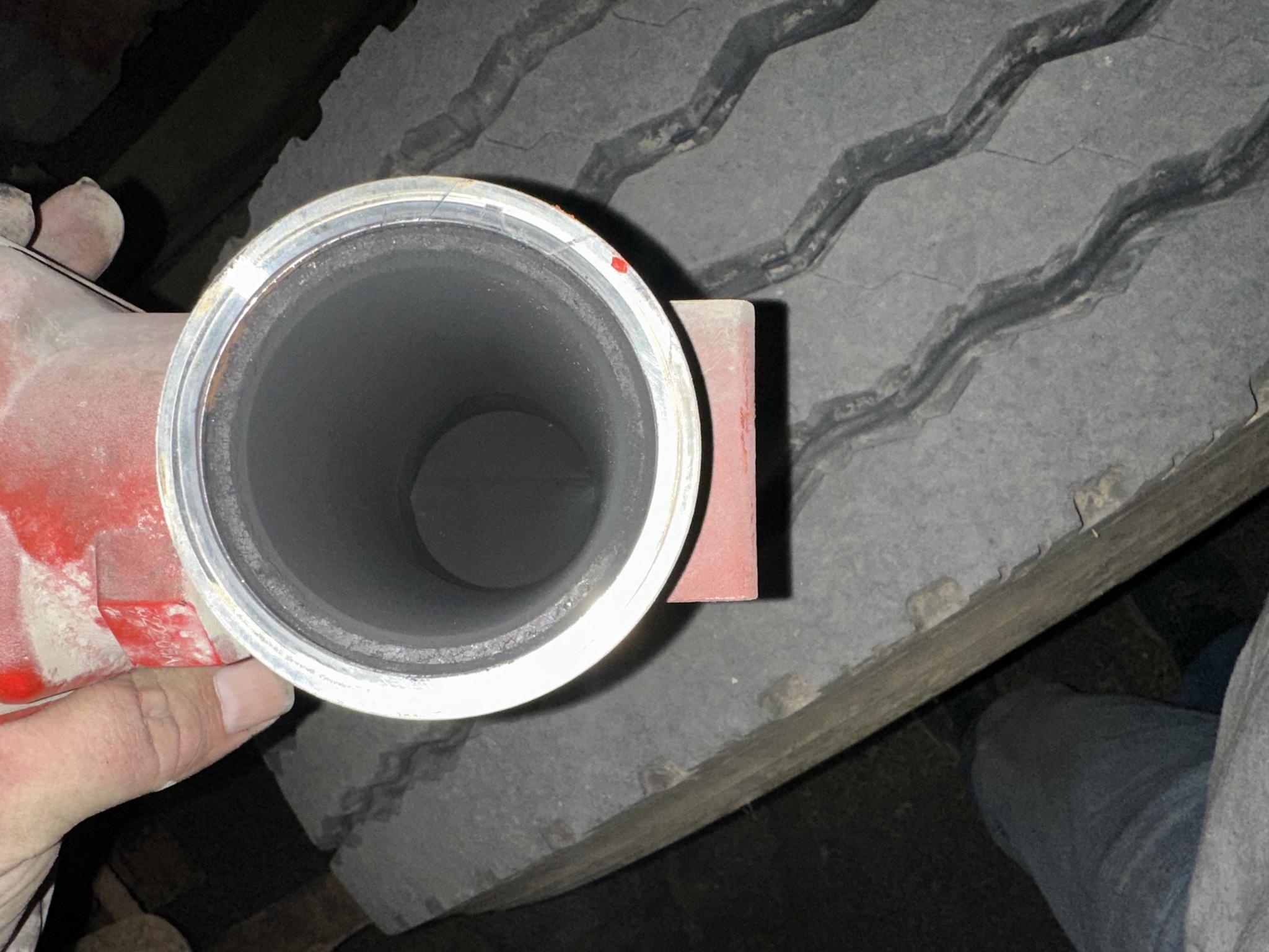

| RE: Peterbilt 2015 cm2350 list of issues New issue, after replacing the egr pressure sensor now I have a code spn5019 fm2 “3138” egr recirculation outlet pressure data erratic, intermittent or incorrect. Took apart the egr mass flow assemble and cleaned it still coded. Tried new delta p and egr pressure sensor coded again checked wiring and voltage can’t find an issue there. Read on quick serve to idle truck 5 min then cycle key to validate. Code and derate went inactive. Test drove got another code for dpf delta p. Replaced sensors and checked pickup tubes were cleared. Cleared codes in system test drove coded again spn5019 fm2. Cleared code in system another test drive coded dpf delta p again cleared then coded spn5019 fm2 again. 3sets of sensors 2 new and original are all doing the same code. Any ideas I did pull the egr this time sooty but dry soot was able to blow a lot out with an air gun truck is making a lot of soot judging by looking at the new imap. Dpf differential pressure is .04 | |||

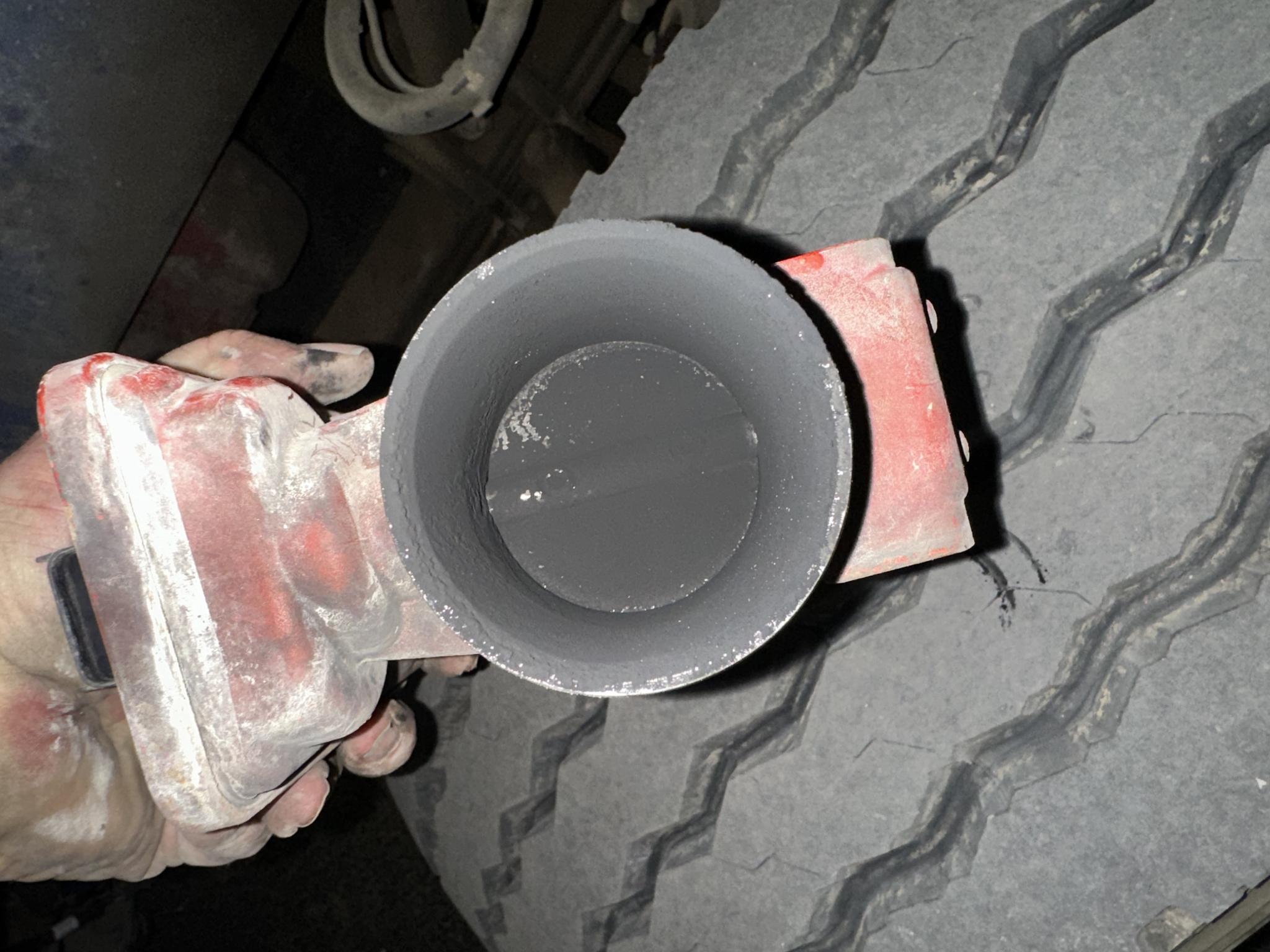

RE: Peterbilt 2015 cm2350 list of issues (12-27-2024 )tree98 Wrote: You need to post the actual codes that Insite shows so we know what we're looking at here is legit. Sorry my INSITE you sent me to eBay for won’t be here till 1/3-1/7. But I’m trying to get fixed asap as I’m 1k miles from home the quickserve code is 3138. I did that process and searched 3138 on here. Rawze said to pull the egr and valve for clogs got nothing posted pic of the valve. Is there anything else I should check before I put the side of the motet back together? Valve has 515k HH miles on it. Is it possible it is fixed and these codes are stuck in the ecm? Is that a thing. | |||
| 12-27-2024, (Subject: Peterbilt 2015 cm2350 list of issues ) Post: #8 | |||
| RE: Peterbilt 2015 cm2350 list of issues No the codes won't get "stuck" like that. There's quite a few things it could be. The engine is just telling you that the egr commanded pressure isn't correct.could be a leak in the egr circuit, a blockage in the egr circuit, a problem with the turbo, faulty sensor, etc. It's gonna be hard to troubleshoot in a parking lot. Also i would say that valve is at the end of it's life with over 500k on it. | |||
