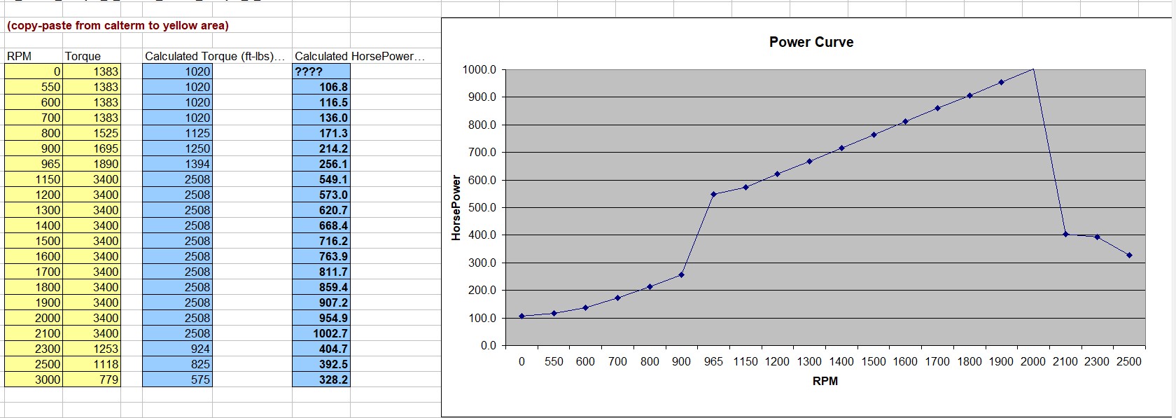

( The Power/torque curve has been completely destroyed) ...
You have exactly the same engine killing, kindergarten torque curve as this guy did.. literally .. as shown in this post. maybe the same clueless fool who created that program made yours too?. - sad indeed.
ref: http://rawze.com/forums/showthread.php?t...7#pid69717
This is beyond some insane madness!!!.
[attachment=9011]
(rt.click and choose 'view in new tab' to see a larger image).
