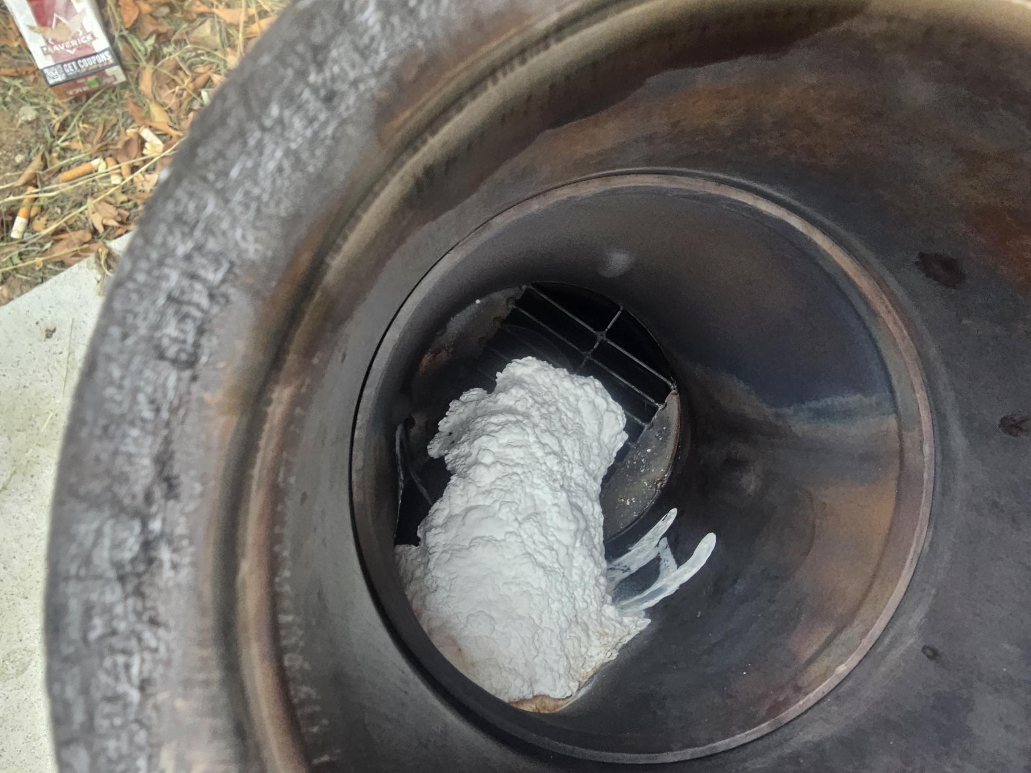

Well you were right about the doser.. I removed it and put my little endoscope camera in there looks like It was leaking pretty bad. I attached a pic.. I also have a little cheap smoke machine and I have a leak at the little soft inlet elbow at the compressor. Would that cause low boost?
[attachment=9828]
