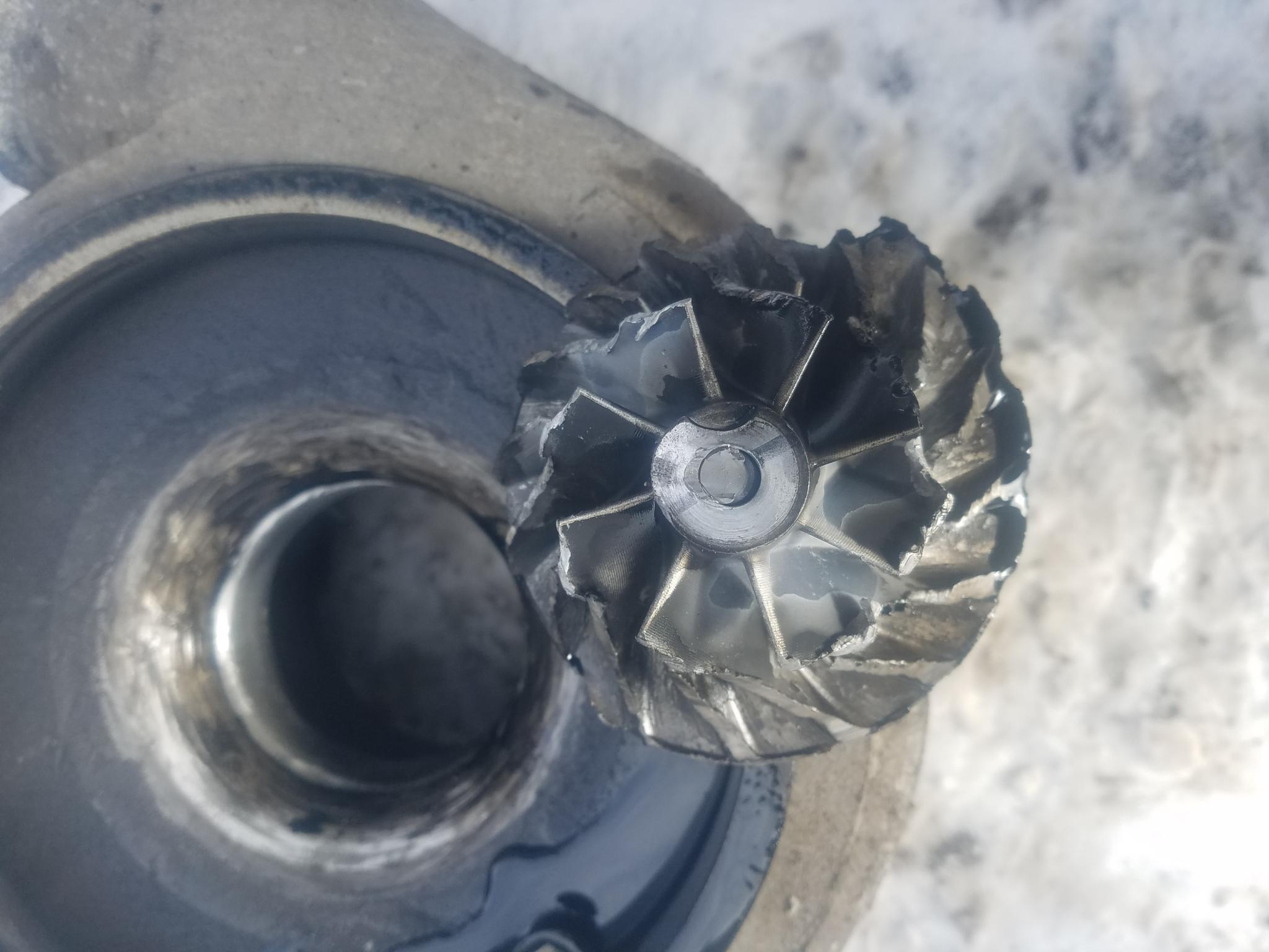

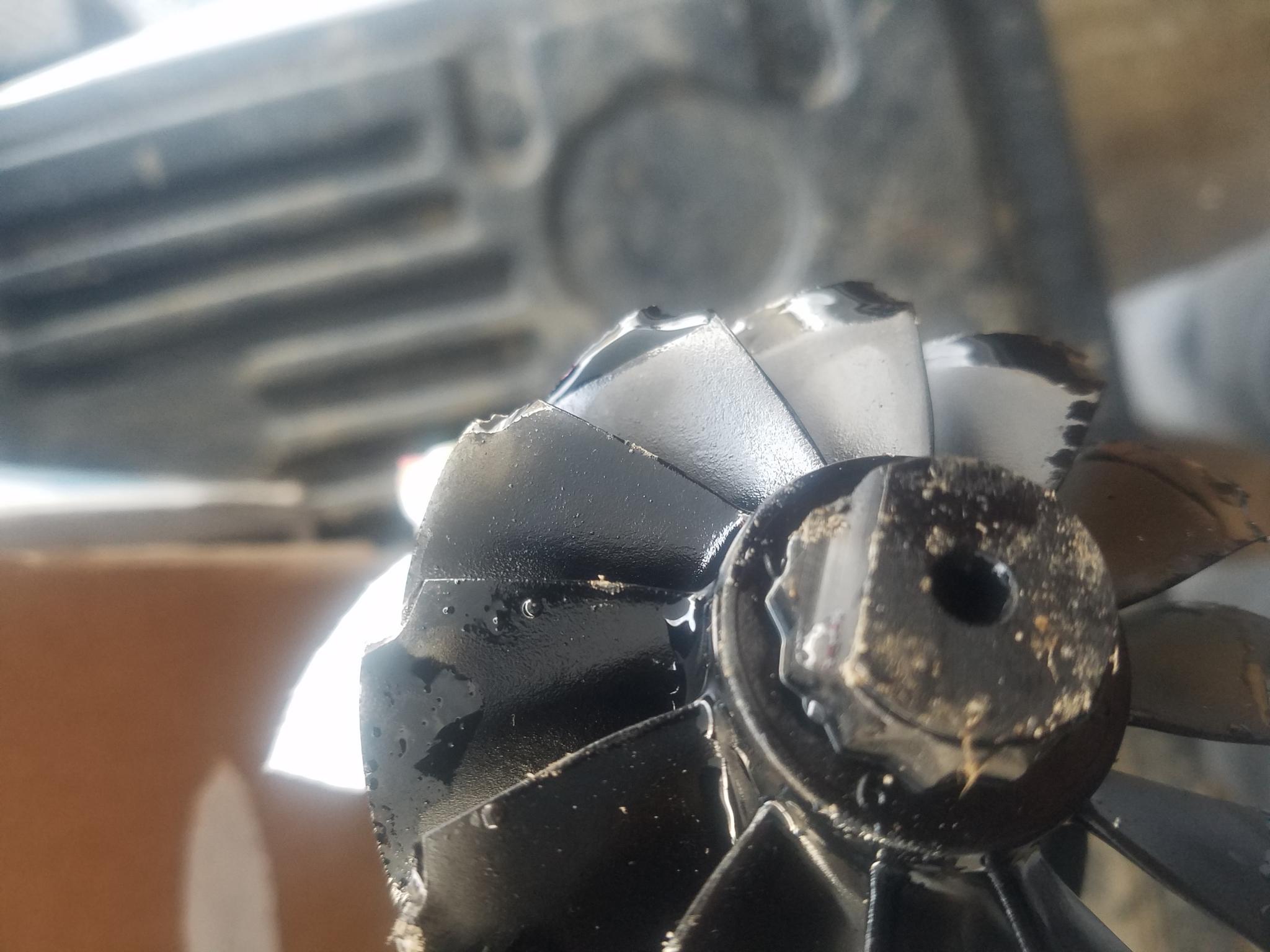

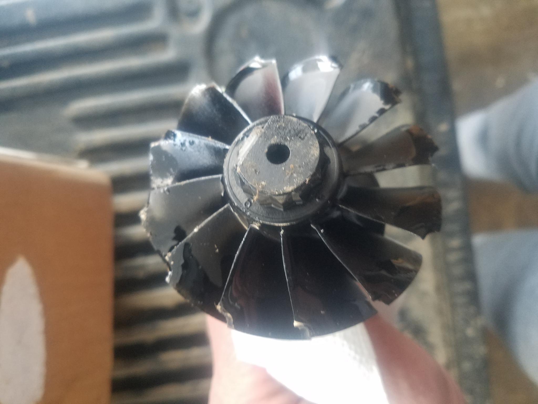

RE: CM 870 turbo Took it apart today, like I thought the turbo failed. I'm just wondering what made it fail? Was it a bearing inside that let loose or was it something inside the motor that failed and went through the turbo? I'm about to put a new turbo, intercooler, oil/ coolant lines etc. etc. a ton of money in parts and I don't want the same thing to happen again if something let loose inside the motor. I attached some pics so maybe you guys can get an idea of what happened?? I need to get this truck back on the road tomorrow if possible, i can post more pictures of the parts if you want to see something specific. | |||
01-25-2018, (Subject: CM 870 turbo ) Post: #7 | |||
RE: CM 870 turbo From the last photo, looks like the fins got chewed up. | |||

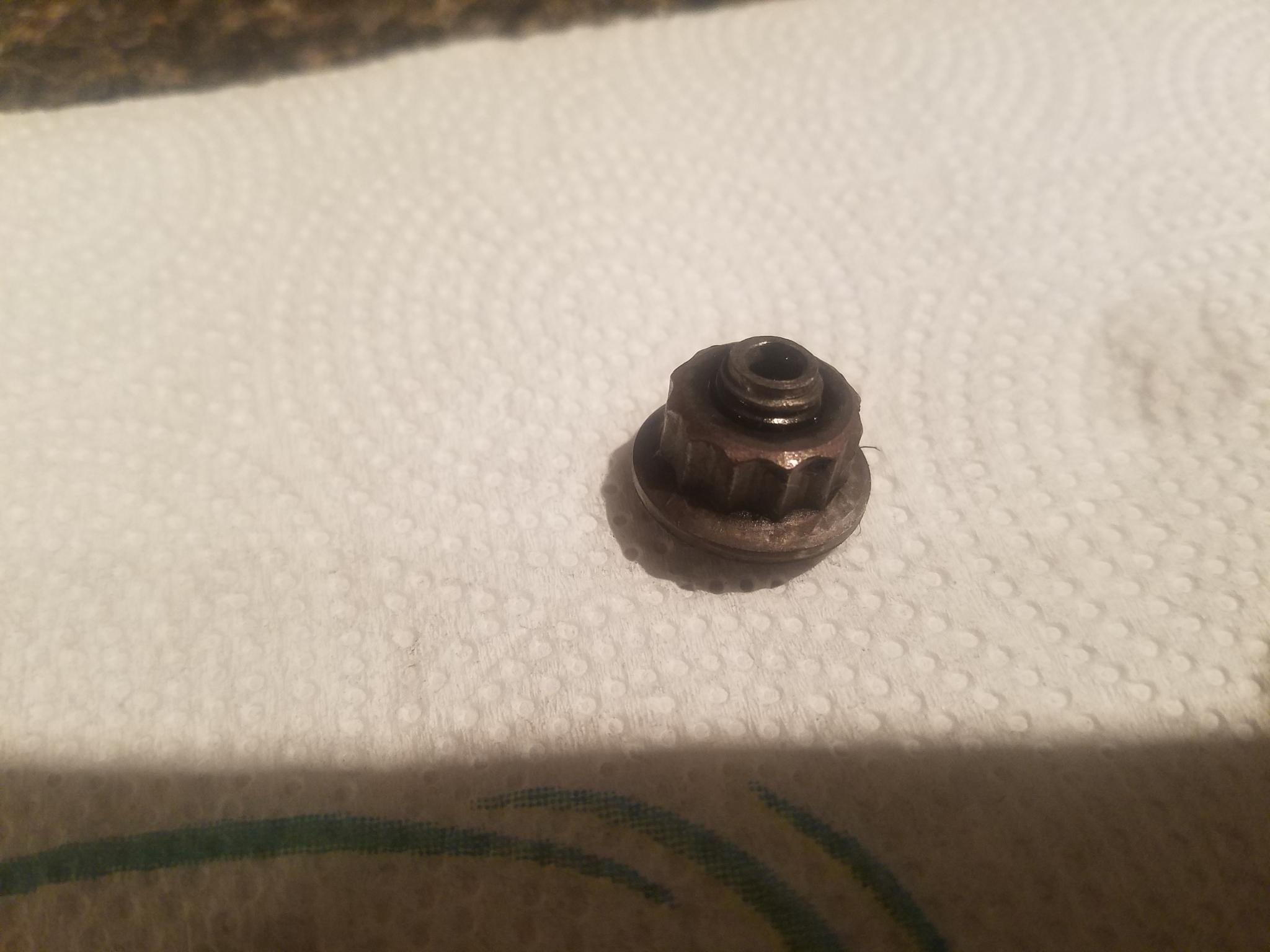

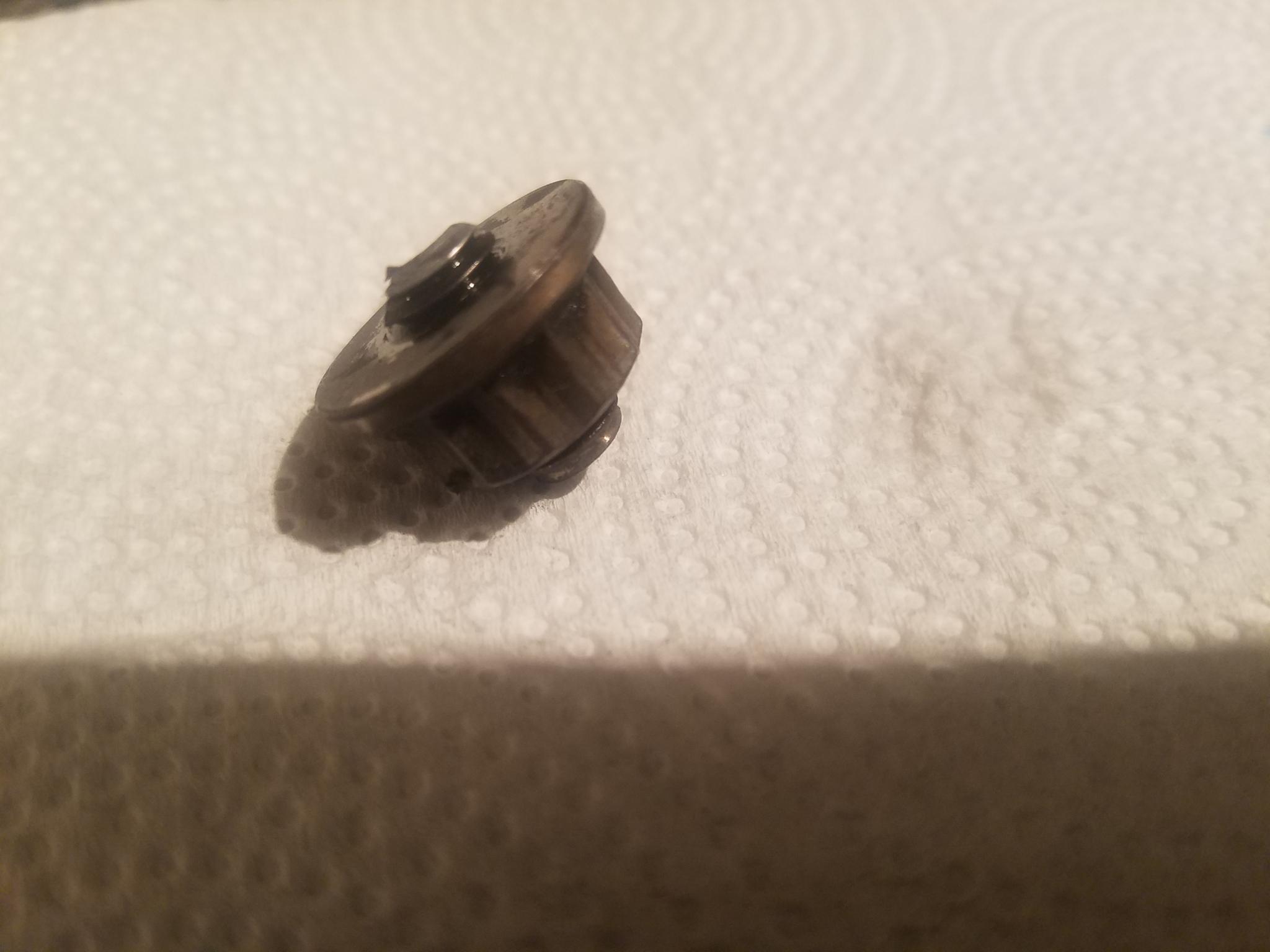

RE: CM 870 turbo the top 2 pics are the turbine (exhaust side) the bottom pic is the compressor side (intake side) I found this broken stud with a strange looking nut on it inside the turbo. Was that part of the turbo or did it come out of the motor? [/quote] This is the compressor wheel retaining nut with snapped portion off the turbine shaft still in it . Have you lugged when this ting happened? Be honest. | |||
