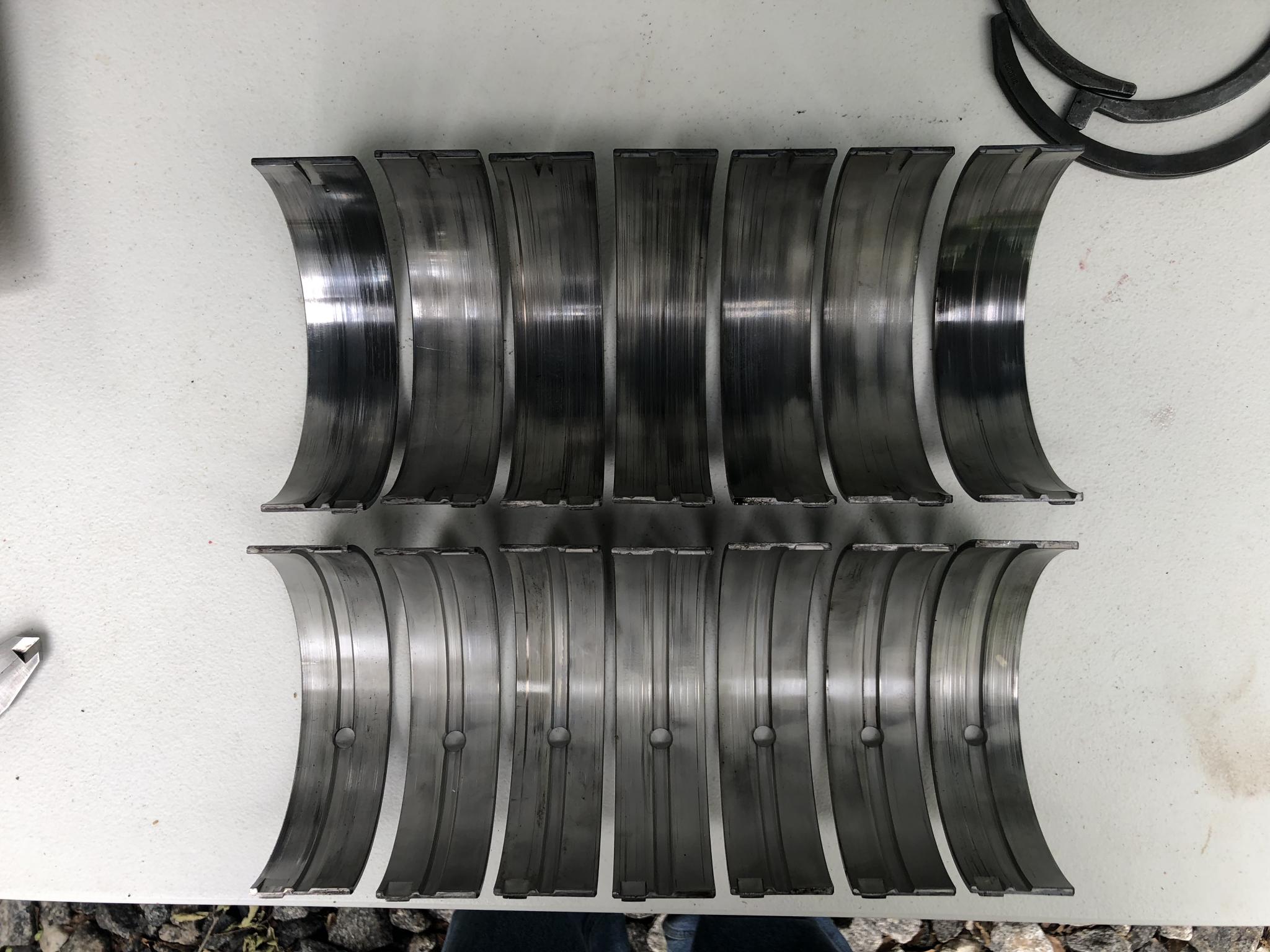

| 04-22-2018, (Subject: Helping Waterloo out with an inframe ... ) Post: #87 | |||
| RE: Helping Waterloo out with an inframe ... | |||
