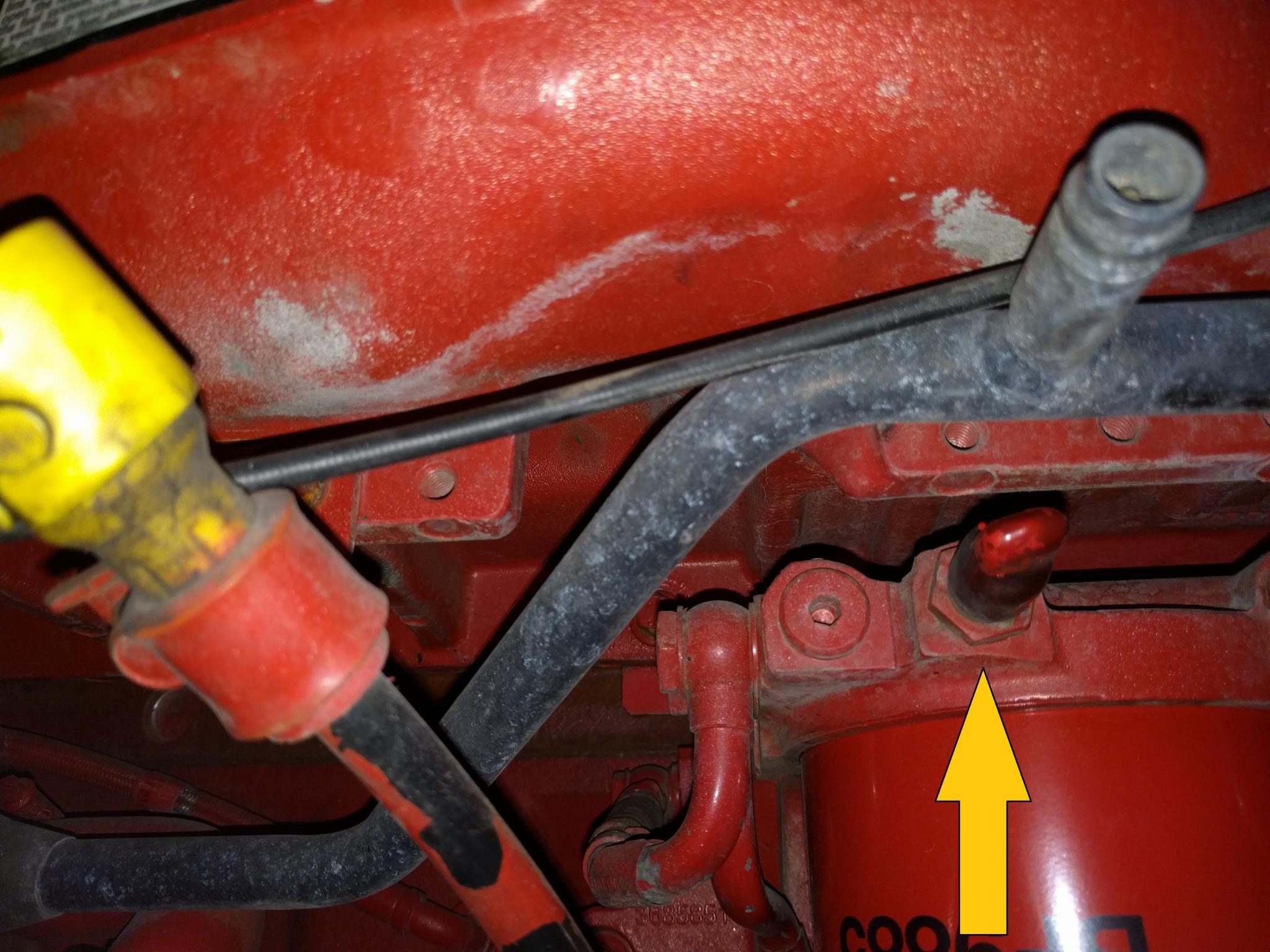

RE: Cummins ISX15 2013 won't start and cranks over and turns off right away (11-03-2017 )Shokar92 Wrote: Hi Rawze, Probably someone driving by can stop and help you. Where are you located? If I understood it right you have 2013 truck and engine is CM 2250 or 2350. What heck the fuel solenoid they sell if 2250 or 2350 has no fuel solenoid. Morons. This is not CM 871 or 870. To check lift pump take out plastic cover from fuel bleed port and push valve inside. Key should be in ON position, no cranking. Is fuel coming out? Open an account on Cumminsquickserve, register engine serial number and you can find all information about your engine and parts numbers | |||
