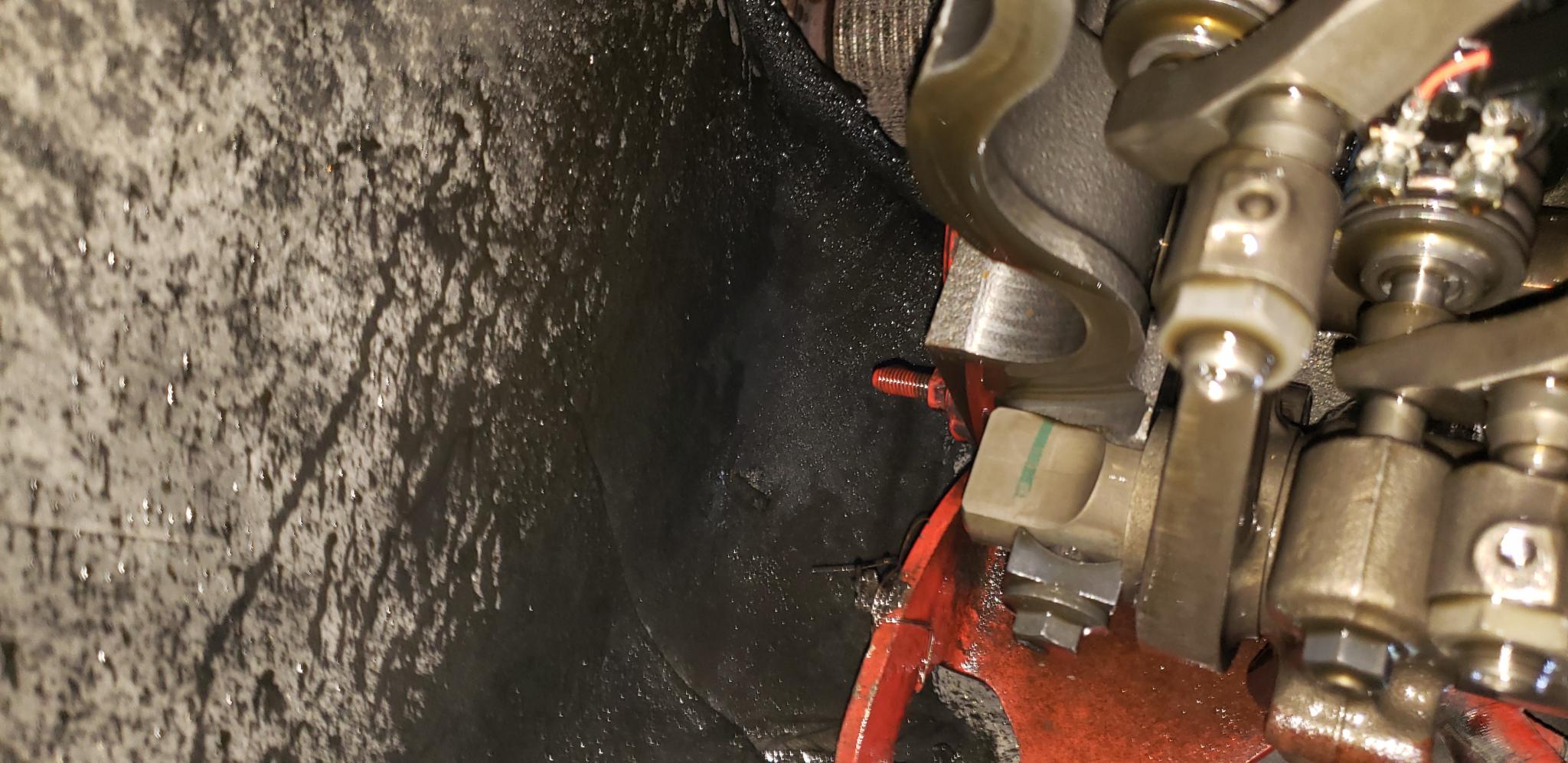

RE: New head, low oil psi, 50% jake Looks like it's a Cummins reman by the part num on invoice. I was really hoping there was a possible easy explanation.. like mixing up the front and rear rocker shafts or something | |||

RE: New head, low oil psi, 50% jake Ok, heres an update.. its cooled off outside, idle is at 650rpm, over 20psi nearly at 25psi mark. Was much lower in heat of day. Idled up to 800rpm, it's nearly 30psi, 38psi at 1200.. anyways, very possible they clunked the cam into a bearing, or didnt seat rocker shafts.. But how could they screw up the jake..? Is there any way I can disable either actuator individually without taking cover off..? Or disable the engine brake function of the turbo..? I'm getting a little noise on stage 1 with a few lbs of boost , but I cant tell if 1-3 cylinder jake is actually actuating or if it's just the turbo I'm hearing. | |||

RE: New head, low oil psi, 50% jake Id pull valve cover and run truck. Id be looking for excessive oil leaking. A few things Ive seen in the past are: Rocker shaft not properly seated to head causing a lot of oil leaking. Jake solenoid plate that bolts down on top of rocker not seated( this will leak bad to) Or the solenoid it self could be just dumping oil from bottom. Also look at cam bearings to see if any of those are leaking good. Being jakes are weak to Im leaning towards the fact that its something in the head and or rocker area that is the issue. | |||
