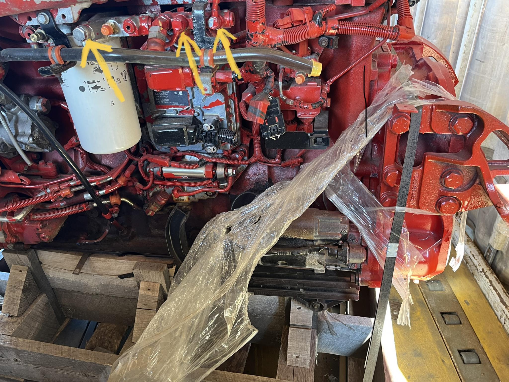

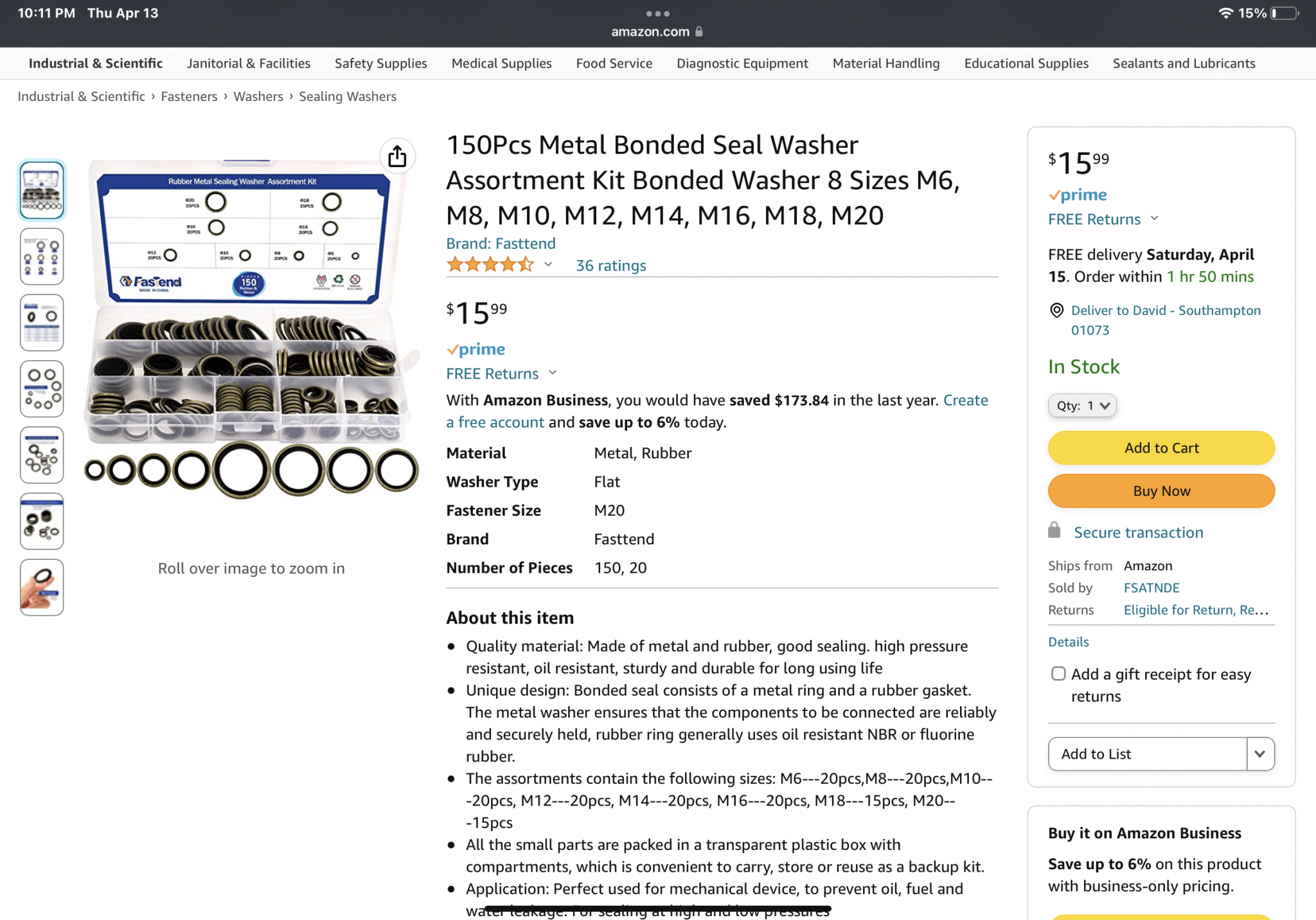

RE: ISX CM2250 in a Freightshaker Has anyone found or used aftermarket high pressure fuel system sealing washers for the banjo fittings? I can’t believe I got quoted over 65 dollars for 3 washers. Is this normal? | |||
04-13-2023, (Subject: ISX CM2250 in a Freightshaker ) Post: #16 | |||
RE: ISX CM2250 in a Freightshaker (04-13-2023 )Ironwagons Wrote: Has anyone found or used aftermarket high pressure fuel system sealing washers for the banjo fittings? I can’t believe I got quoted over 65 dollars for 3 washers. Is this normal? I don't think any of the actual banjo fittings (a hollow bolt with flat washers on both sides of them) have to suffer the 40,000 psi pressures. I think they are all on the low pressure side of the system if I am not mistaken. maybe a pic or 2 of the fittings you are referring to?. User's Signature: ->: What I post is just my own thoughts and Opinions! --- I AM Full Of S__T!. | |||
04-13-2023, (Subject: ISX CM2250 in a Freightshaker ) Post: #17 | |||
RE: ISX CM2250 in a Freightshaker (04-13-2023 )Rawze Wrote:(04-13-2023 )Ironwagons Wrote: Has anyone found or used aftermarket high pressure fuel system sealing washers for the banjo fittings? I can’t believe I got quoted over 65 dollars for 3 washers. Is this normal? Yes, I am sure you are correct Rawze now you mentioned and I thought about it. It is the mess of lines that go through the ecm cooling plate etc prior to the high pressure pump. I put some yellow arrows to the fittings I am looking for the sealing washers from. I was looking around and saw these attached pict…I can buy the whole damn box for the cost of 1 oem washer. | |||
04-14-2023, (Subject: ISX CM2250 in a Freightshaker ) Post: #18 | |||
RE: ISX CM2250 in a Freightshaker The lines you drew arrows to are low pressure, you should be fine to use Chinese sealing washers on those. User's Signature: im_seeing_parameters_in_my_sleep 1 | |||
