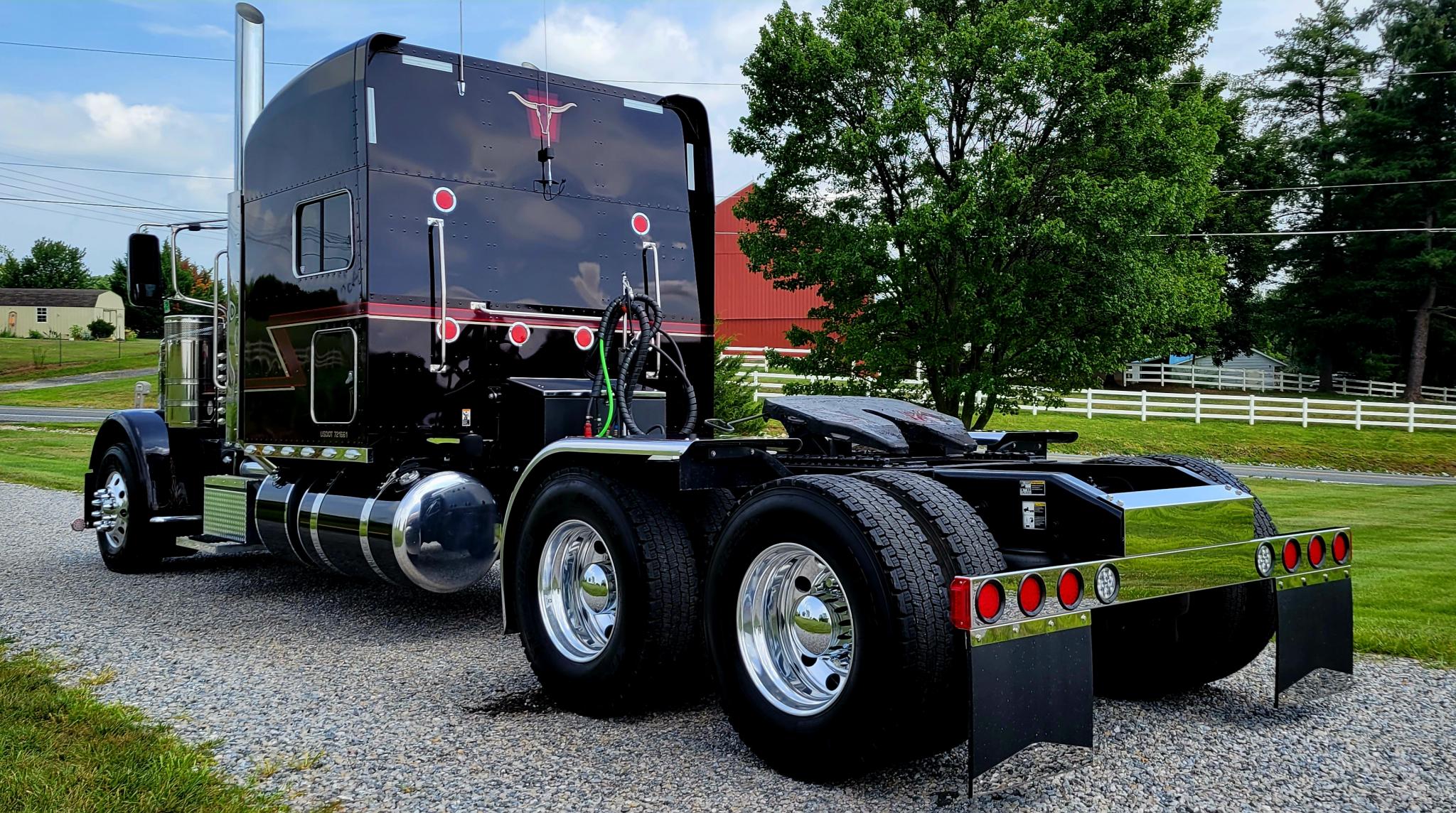

Hello all. I have a 22 Peterbilt with a 565/2050 and I'd like to add a little power, be able to read and clear codes, and monitor EGT, etc. Is the {puke dee eye} good for all that? Is the tune decent? If not, maybe {pi44-poor power box}?Thanks in advance. This is my 1st post...

The truck is a 389 with a RTLO 20918 trans and 336 rears. I pull livestock , tanker, and feed.

I certainly wasn't trying to offend anyone or get kicked off. Someone suggested I check this site out when I asked about tuning, so I am certainly not familiar with how this all works. If I purchase the equipment you suggested, who can help me with a reliable tune? I'm an older fella and I don't drive real fast. I've been trucking since the early 80's, and just want a little pep. I am very fussy on Maintenance and do oil changes every 12-15k. My last truck was a deleted X15, with 600,000 miles and still going, but I plan on keeping this one in tact because the laws are tightening up and I already get decent fuel mileage. I appreciate any guidance.
