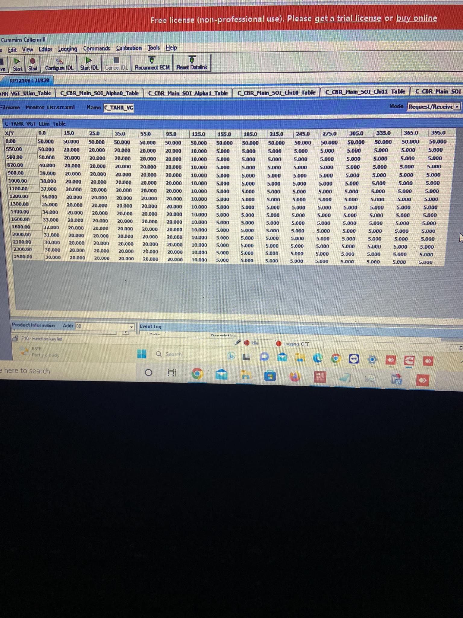

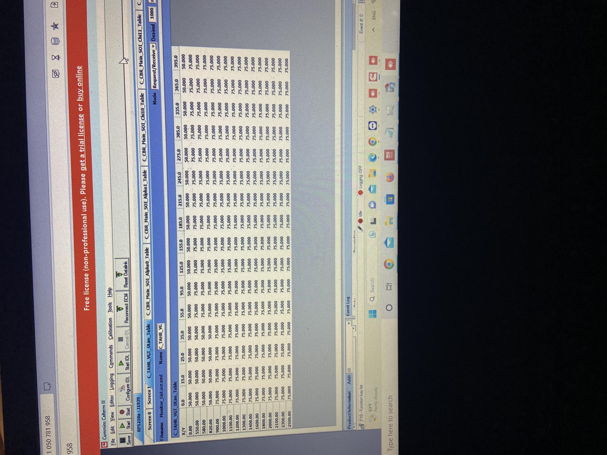

The engine was running 12 degrees final timing, the turbo tables were also slap f*cked. I’ll include pictures. There was absolutely no mode control or attempt at it. Whoever tuned it jumped cpl numbers. And the egr wasn’t properly in Bluetooth mode. Should have a report back tomorrow on oil temps after it was repaired but that’s what I seen at a quick glance when I looked at it. I really don’t understand the concept of these turbo tables though….. it looks like some shi#t out of a 16 year olds powerstroke.
