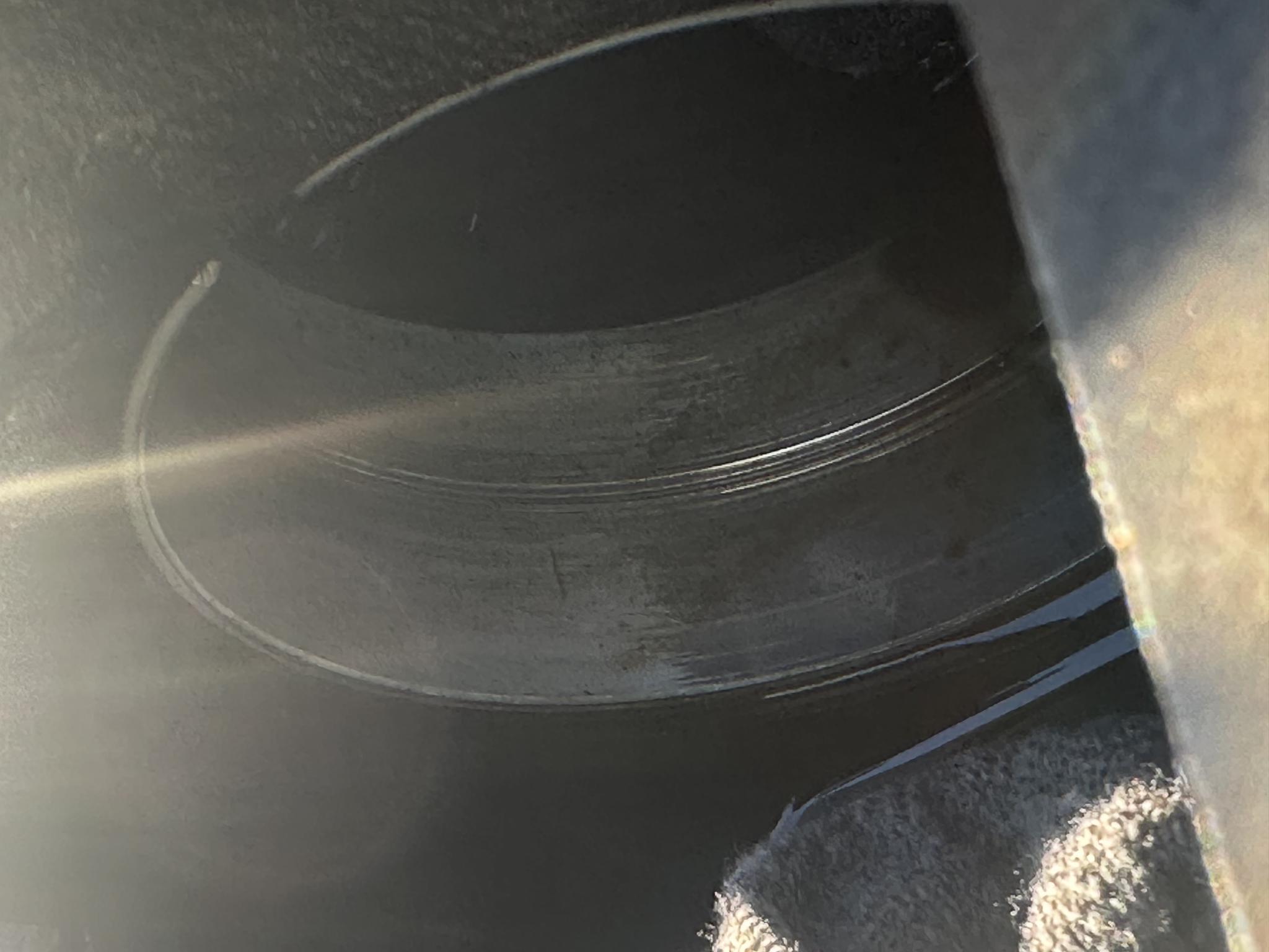

(12-14-2023 )Colter Wrote:  I wouldn't do bearing unless they don't meet the conditions for reuse which on that engine is copper showing more then 180degrees around bushing. There may not be enough room for the tooling depending on how close the firewall is. They also need to have the oil galleys lines up perfectly as you cam carries the oil. If the bushings are worn out I would change the head which would probably lead to an in-frame if you wanted to avoid having to do it again in a shorter time. If the bushings are okay just replace the cam.
There is a groove in center of the bearings for injector cam.

The head is junk........

must have run a while with that chewed up cam. It would not surprise me if you find damage to the rod/main bearings either.

(12-15-2023 )Rawze Wrote:  must have run a while with that chewed up cam. It would not surprise me if you find damage to the rod/main bearings either.
Yes engine needs a complete overhaul. Found a good used, but wondering if it’s a good swap candidate

Groove is debris carried through the oil system into the cam and then out to that bearing, as stated needs an overhead, all your bearings could have damage like that as that cam is the furthest away from the oil pump.
