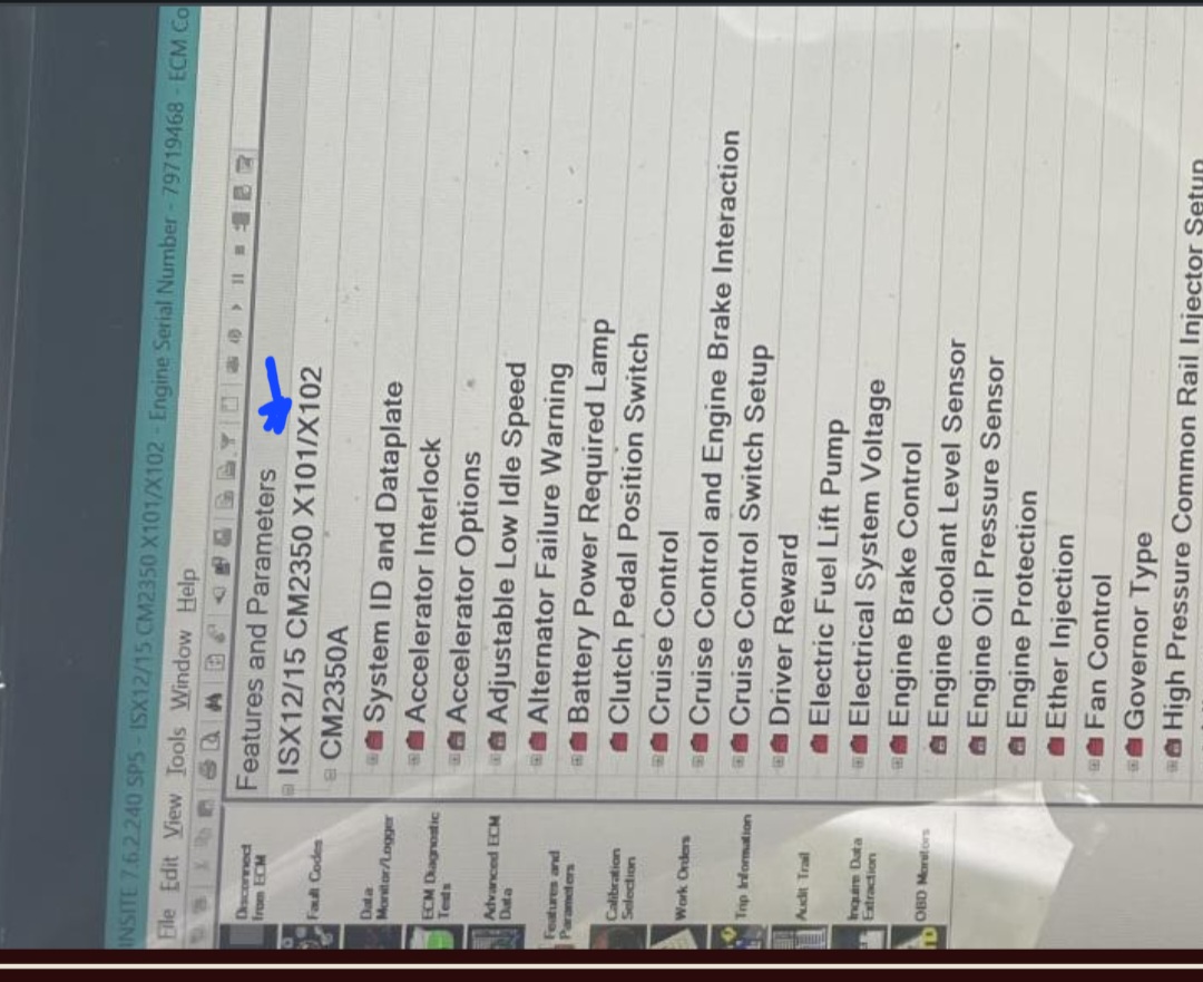

Can you post a pic of all of your parameters with them all expanded?

(09-21-2022 )DieselKid Wrote: [ -> ]Can you post a pic of all of your parameters with them all expanded?
You'll need to right click on the header there and select expand all. If you can post that we can get the full picture of what all the parameters are set to. See blue arrow in my screenshot for reference [attachment=8569]
I believe your clutch pedal switch and your service brake switch both need to be multiplexed to 49 cab controller primary. Your service brake switch parameter that appears above your starter lockout should also be enabled
