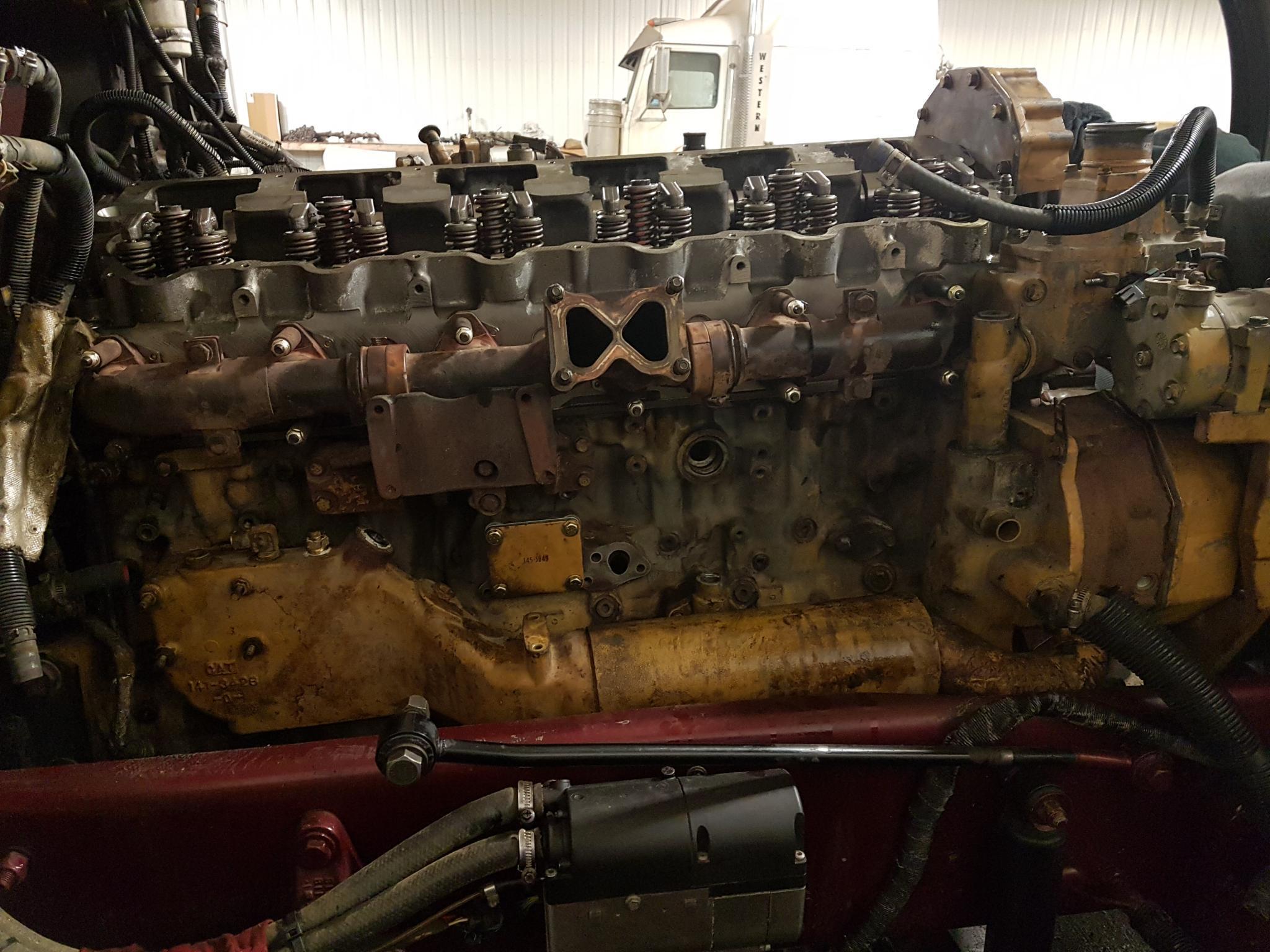

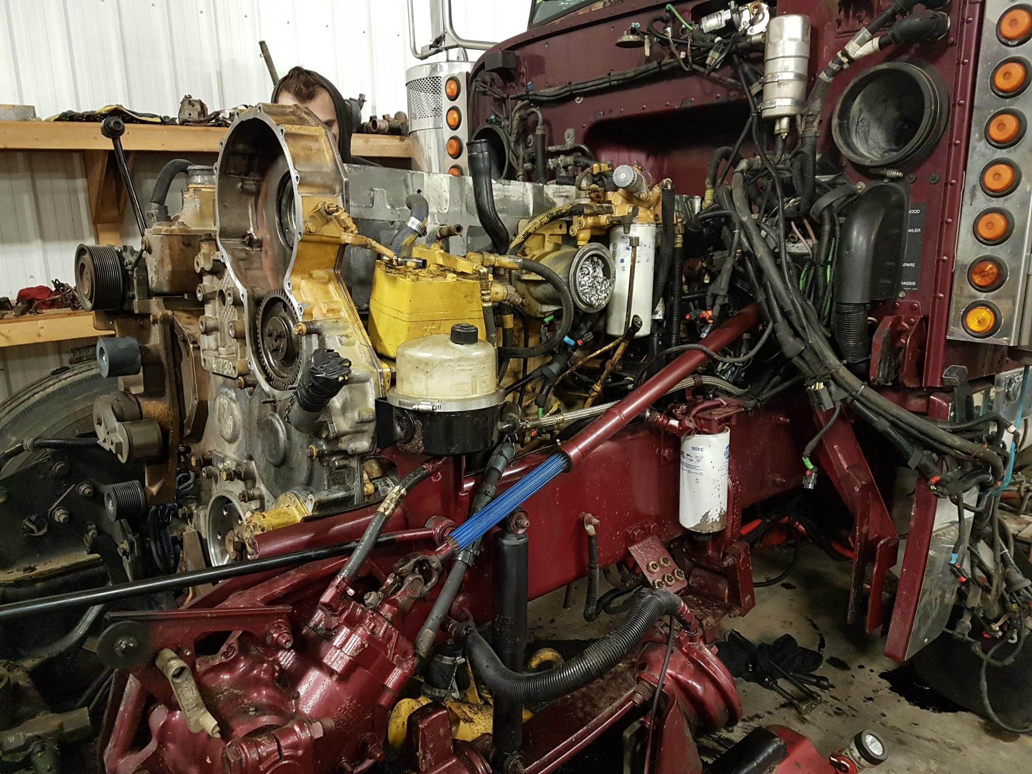

[attachment=2443]
[attachment=2444]
Coming together nicely. Removing all the mandated junk off her, boy is there a lot of extra useless crap!
Mechanic wants to remove the intake pre cooler, says it's useless. Not sure how I feel about that one yet.
RE: My c15 rebuild - Unilevers - 02-06-2017
(02-05-2017 )Brock Wrote:  Coming together nicely. Removing all the mandated junk off her, boy is there a lot of extra useless crap!
it is, get rid of it. make sure you leave the cgi baro and differential they use that for the oil pressure reference output.

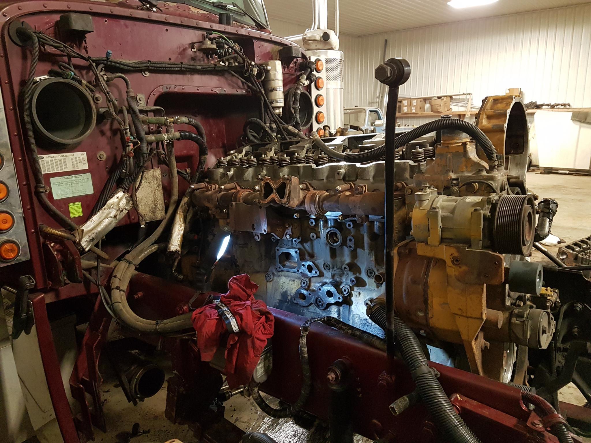

[attachment=2446]
Got the injectors and crap on today, swapped out the oil cooler for the old style one. Thinking I'll remove the crankcase filter assembly as well seeing as I have a Pitt power catch on there, let er breathe a little better!
FrankenCat
