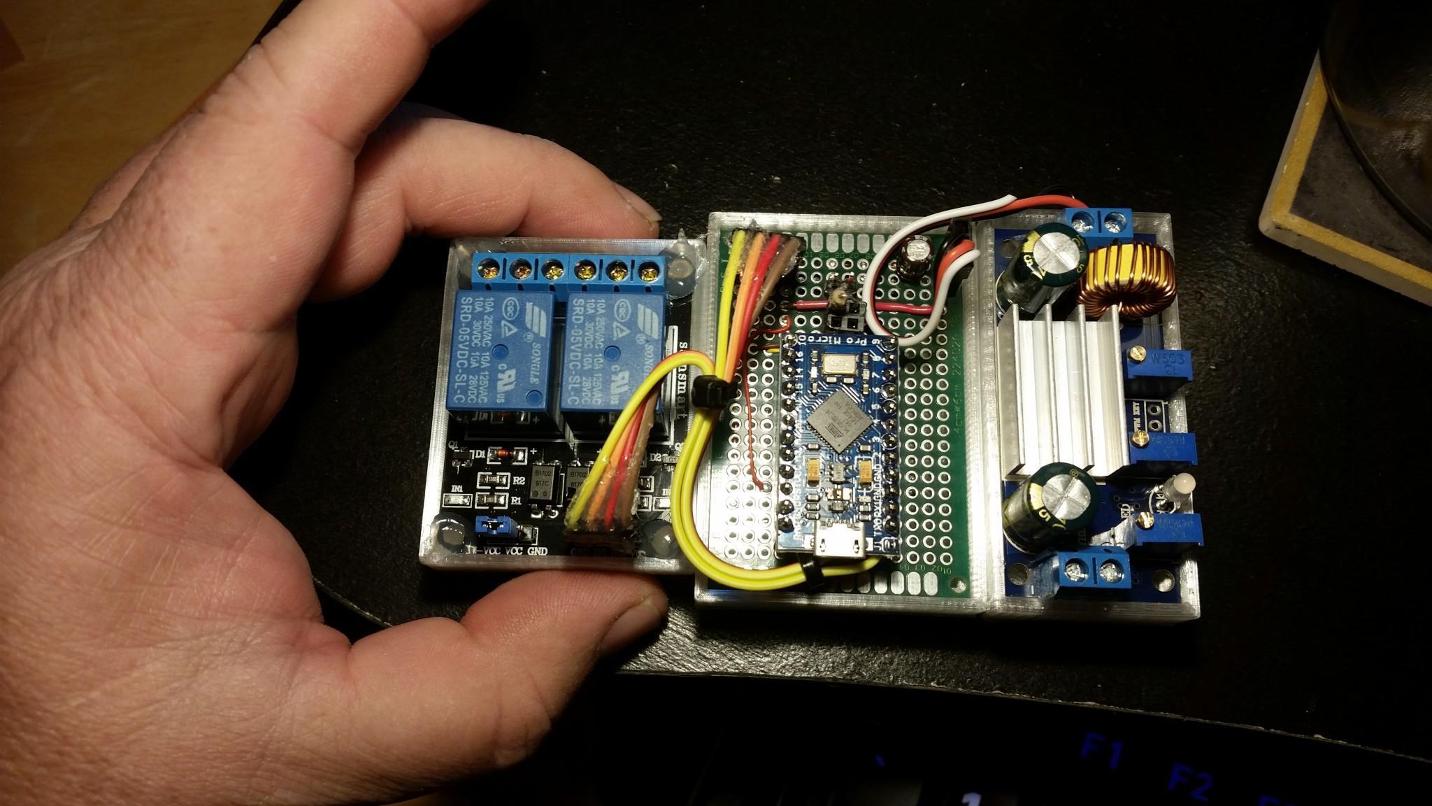

YOu have 2 solutions ...
1) learn how to replace the thermistors and service it yourself, keeping after it
,... or if you like to tinker with Arduino and are a crazy lunatic that can't leave s%it alone like me ...
2) bypass the crap s%$it cab controller and put an Arduino on it to control it yourself. Here is the one I made for mine...
[attachment=2812]

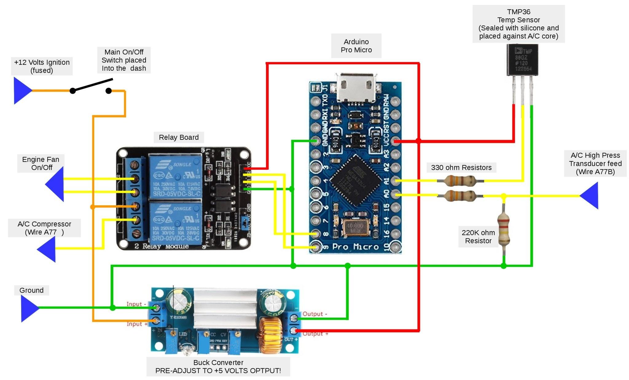

Here is the hookup diagram...
[attachment=4193]
The parts that I happened to have used ...
The pro micro: https://amzn.to/2VcoBHl
Relay Module: https://amzn.to/2URvUiE
Voltage converter: https://amzn.to/2JdnHTG
Temp Sensor I used: https://amzn.to/2H0h8T7
I used my 3d printer to make a nice holder, but a person could also just hot-glue the boards to the backing of a clip-board that has been cut down, and use a terminal strip at its edge ( https://amzn.to/2Vf8gll )for the connections.
* I used a long piece of small 3-conductor wire for the temp sensor that I mounted against the evaporator (the core in the cab of the truck that gets cold). I had to seal the temp sensor from moisture really well for it not to get erratic readings. I just buried it and the soldered wire connection in clear silicone and let it dry. I also used the silicone to also glue it to the evaporator core near the bottom left of it.
* I had to turn the "constant current" adjustment screw on the voltage converter all the way up to max, and i had to adjust the "voltage" adjustment screw on it for +5.0 Volts DC using a volt meter.
Here is the code I am currently running it with. I wrote it myself... Use at own risk! -- Seems to work very well for me, even better than the factory. It will not shut down or fault out unless there is no pressure in the system.
