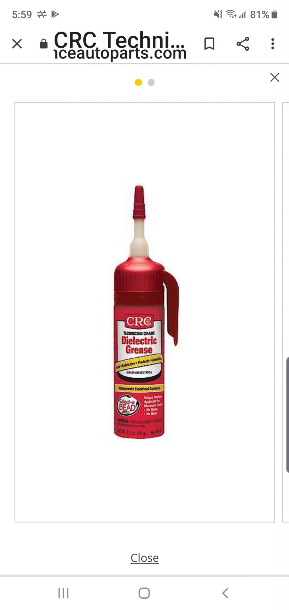

RE: Automated Eaton 10 speed shifting weird (11-30-2019 )Ricky Wrote:Do you have a picture of that grease?(11-26-2019 )Satch Wrote: I have found that info very useful. Thank you. Well today as with many days the transmission acted up again to the point where it stayed stuck in 6th gear abs wouldn't come out. I coasted into rush truck center and asked if they could check it while it had duplicated the problem. I refuse to set tractor brakes (I set trailer brakes instead) in case it cleared it. The tech shut it off after reading codes and it wouldn't start because it was still in gear. The tech then proceeded to trick the drive shaft and wait a few minutes. It started. | |||

RE: Automated Eaton 10 speed shifting weird (12-01-2019 )tree98 Wrote: https://amzn.to/37Z6QOA Dialectic Grease... Comes in a tube too, I carry in my truck, just make sure to store in a zip-loc bag, summer time it can get messy. | |||

RE: Automated Eaton 10 speed shifting weird (12-01-2019 )david24 Wrote:I got it from Advanced if I remember correctly.(11-30-2019 )Ricky Wrote:Do you have a picture of that grease?(11-26-2019 )Satch Wrote: I have found that info very useful. Thank you. Well today as with many days the transmission acted up again to the point where it stayed stuck in 6th gear abs wouldn't come out. I coasted into rush truck center and asked if they could check it while it had duplicated the problem. I refuse to set tractor brakes (I set trailer brakes instead) in case it cleared it. The tech shut it off after reading codes and it wouldn't start because it was still in gear. The tech then proceeded to trick the drive shaft and wait a few minutes. It started. | |||

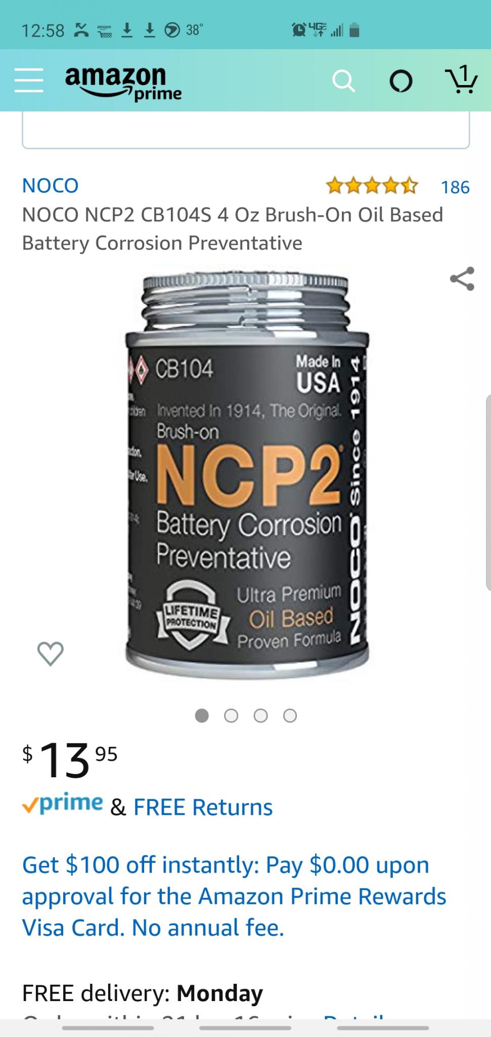

| RE: Automated Eaton 10 speed shifting weird Well some symptoms have been duplicated. The truck on occasion still hesitates to shift from 2nd to 3rd and 7th to 8th without throttling the accelerator. Without letting off within a few seconds or she'll scream at ya. I have taken the necessary steps in cleaning corrosion from battery cables. Applied the sweet and sour sauce (not actual) to all battery cables to prevent corrosion "hopefully". I've been told the computer for the transmission is beside the transmission. I can literally hear a high pitch frequency everytime the shifts about to occur from my passenger side kick Panel. Is that not the powertrain control module? Does that mean two computers for transmission? I haven't looked around transmission yet | |||

| RE: Automated Eaton 10 speed shifting weird I see that NCP2 stuff says its oil based. Doesn't oil burn? I've had and seen many batteries cook so hot they catch fire. Recently had 1 on my truck that I soaked in water after knocking the cables off of it to cool it quicker because it was starting to melt. Wouldn't oil be adding fuel to the fire? Does it say anywhere "nonflammable"? | |||

RE: Automated Eaton 10 speed shifting weird (12-04-2019 )Chamberpains Wrote: I see that NCP2 stuff says its oil based. Doesn't oil burn? I've had and seen many batteries cook so hot they catch fire. Recently had 1 on my truck that I soaked in water after knocking the cables off of it to cool it quicker because it was starting to melt. Wouldn't oil be adding fuel to the fire? Does it say anywhere "nonflammable"? I would think that if a battery got hot enough to catch a bit of oily (or tar-like) terminal protectant on fire, that would be the least of your worries at that point. User's Signature: ->: What I post is just my own thoughts and Opinions! --- I AM Full Of S__T!. | |||

RE: Automated Eaton 10 speed shifting weird (12-04-2019 )Chamberpains Wrote: I see that NCP2 stuff says its oil based. Doesn't oil burn? I've had and seen many batteries cook so hot they catch fire. Recently had 1 on my truck that I soaked in water after knocking the cables off of it to cool it quicker because it was starting to melt. Wouldn't oil be adding fuel to the fire? Does it say anywhere "nonflammable"? It's got the flammable placard. It's a cancer aid and has reproductive harm...hmm maybe this should be a substitute for sweet and sour sauce for California. The diesel is flammable the gear oil is flammable, the hair spray is flammable, and generally the contents of the trailer are flammable. Fun fact, wd40 is flammable also. I get what your saying, I don't have dielectric grease in my truck...yet. | |||

| RE: Automated Eaton 10 speed shifting weird My concern wasn't that you shouldn't carry flammable stuff. Hell I have a butane and propane torch in the truck at all times and carry two 3 gallon cans of gasoline. My curiosity was with putting an oil based product in an area that can cause it to burn or even expedite a burning situation if the batteries short out. Rawze kicked a hole in my stupidity. It's all good. | |||
