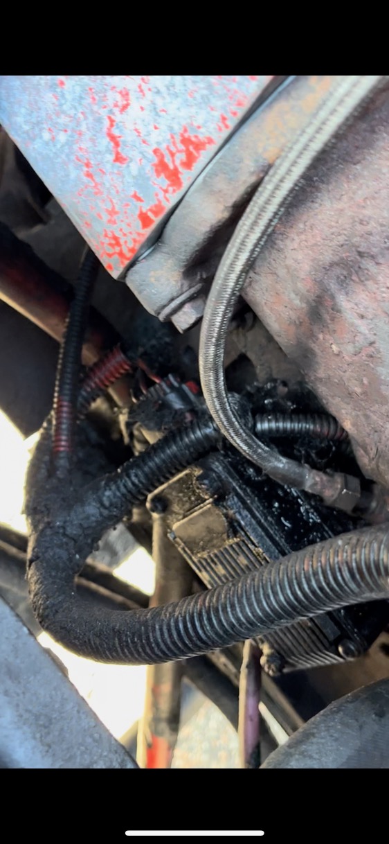

| RE: Isx leak Well when I first got it back from the shop I drove it to the TruckStop about 50 miles and the first place I saw oil was here on this module. This the pictures I took that same day | |||

| RE: Isx leak So where did that oil come from? It can't be the case that ONLY the turbo actuator box has oil on it and there's no oil anywhere else. This isn't even a hard problem to figure out, you just need to look around a bit more. You might need a mirror or a flashlight or something but there's no reason you couldn't follow the oil trail from that turbo box back to the area it originated from. Clean the engine REAL good, then put shop air to the fan clutch so the fan can't come on and blow leaking oil around. Start it up and find a way to hold(a stick between pedal and seat) the rpm's steady around 1600 or so. Now give it a few minutes and start looking around for oil running out from somewhere. Just don't overheat it because now the fan is disabled. Shouldn't take very long to find the leak. | |||

| RE: Isx leak Thanks on the replies.Well when I trace it back it’s literally dripping from the oil fill housing at the bottom. Another thing to note is the oil filler assembly area is the highest point on the engine I can find oil. The thing that puzzles me is; can that cause all that oil leak? I will try do what you said earlier on | |||

RE: Isx leak (12-18-2024 )3406E Wrote: .... Another thing to note is the oil filler assembly area is the highest point on the engine I can find oil. The thing that puzzles me is; can that cause all that oil leak... Looks like that filler assembly would be capable of some serious mess. The picture you have shows dirt sticking to the top side, but not the bottom which is most likely due to a continuous flow across the surface. Maybe not all of your leak, but looks like a good bit of it from what the picture shows. Looks like the fan is pushing the leak from the filler joint onto the the front cover as well, according to the streaking down the surface. | |||
