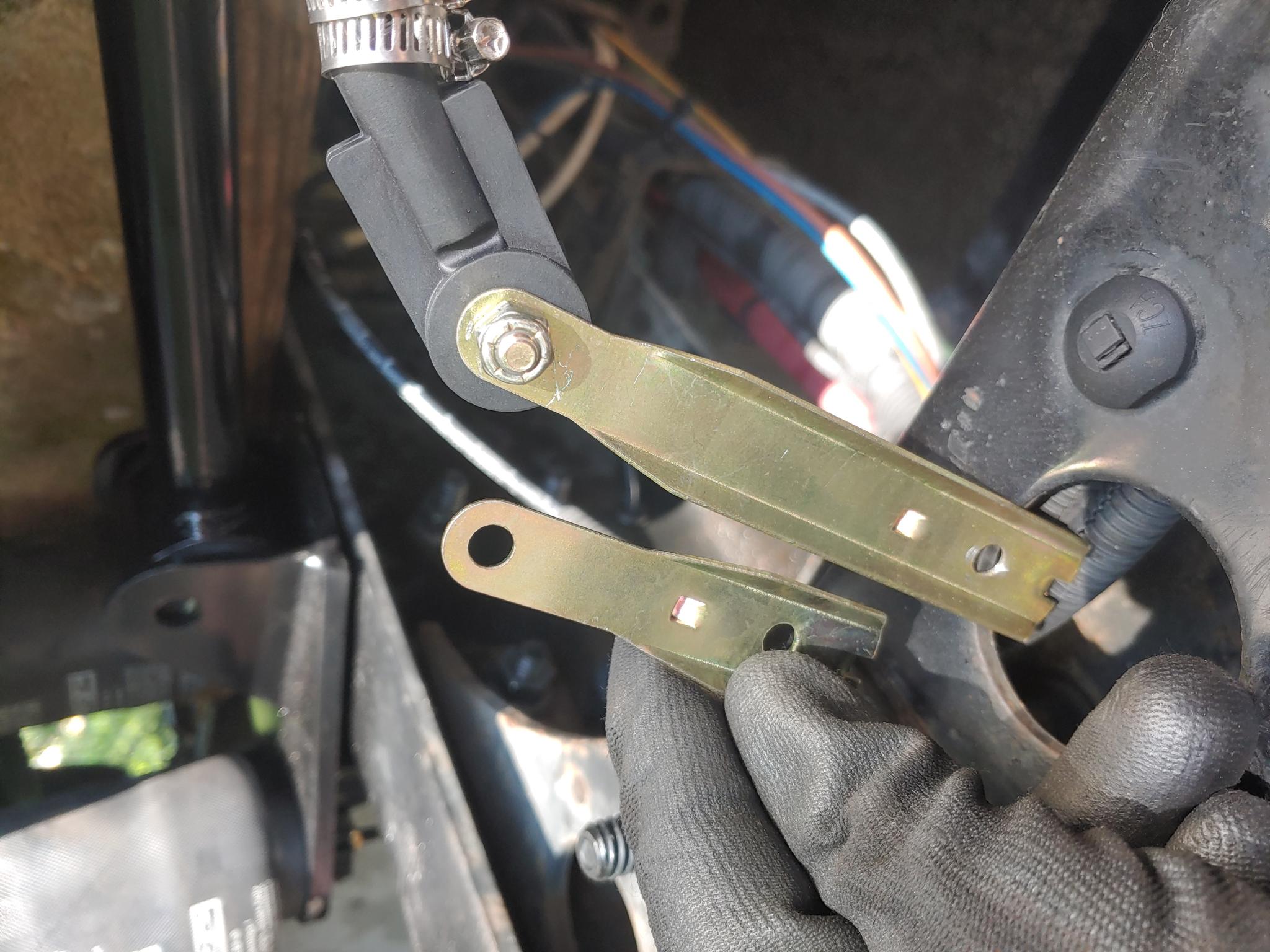

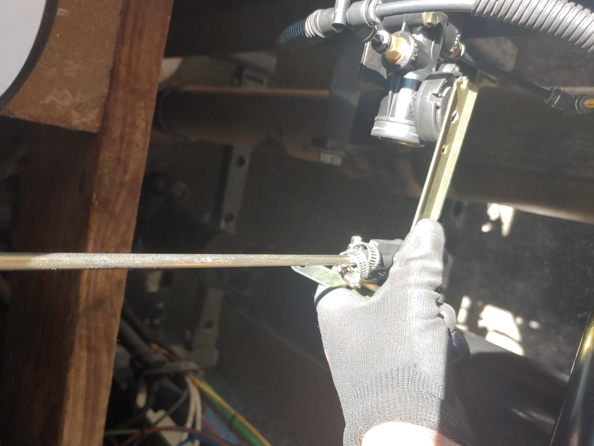

RE: ProStar Sleeper Suspension Modification... (06-17-2021 )Paccardude Wrote:(06-17-2021 )Chamberpains Wrote: I would look at your cab leveling valve. If it's broken internally then it will not send air to bags. Hey Chamber, I replaced the height level valve and still no air accessing bags from supply line. I took the bracket off going ton the fill/empty knob or dial and once I got that off i turned the knob and the bags filled with Air. I used the long connector and it sits at a 90 degree angle. Do I need to replace with the short arm connection? The dial isn't spinning. User's Signature: We're a full grid off. | |||
