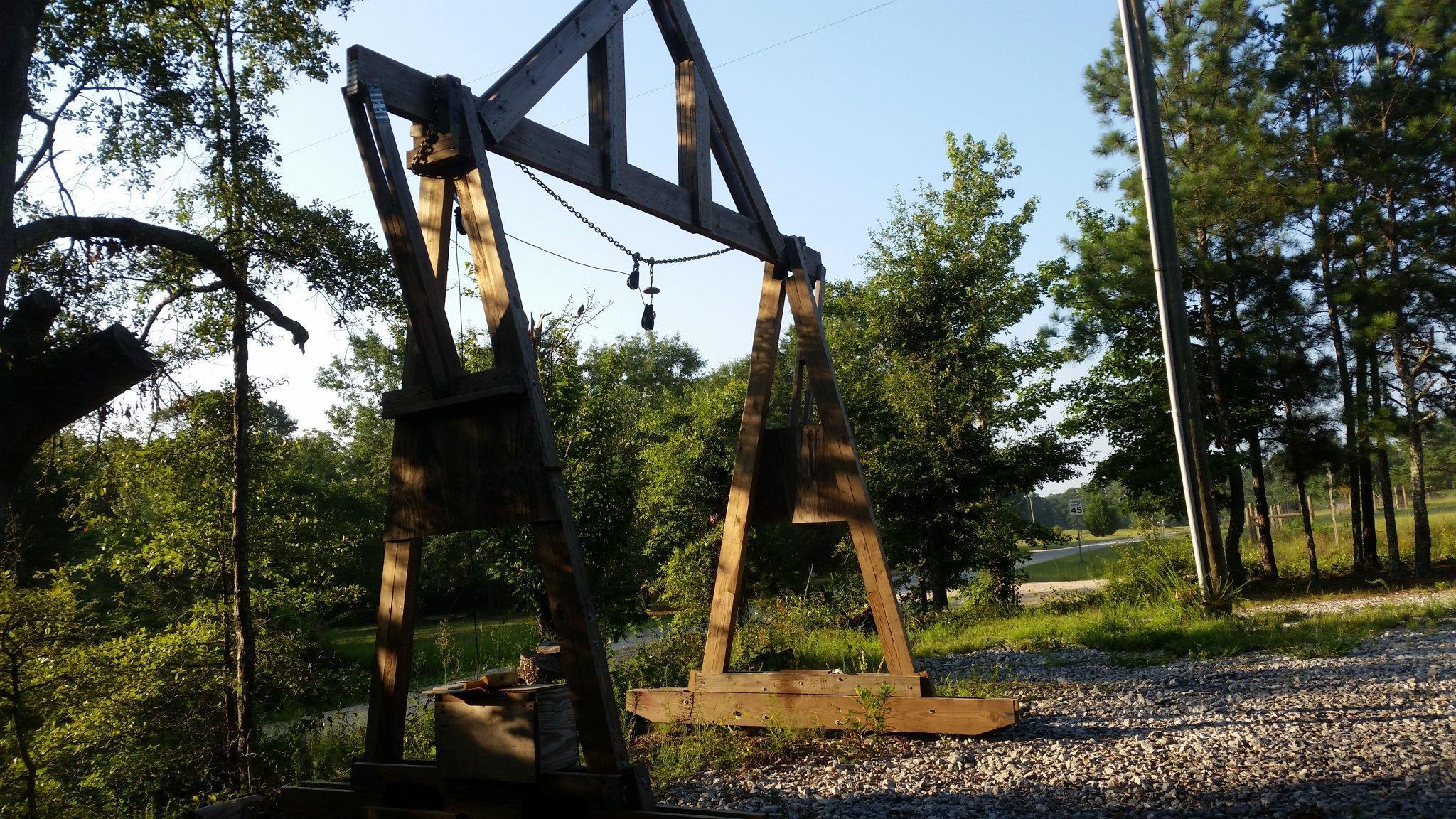

| RE: Rawze's Daily blog... Did you change the diff at the shop or home? Do you have a jack that works with that? | |||
| 07-20-2017, (Subject: Rawze's Daily blog... ) Post: #89 | |||
RE: Rawze's Daily blog... (07-19-2017 )Mrkentee Wrote: Did you change the diff at the shop or home? Do you have a jack that works with that? I did it myself. I rolled the differentials out from under the truck and used the yard crane I made a few years ago. User's Signature: ->: What I post is just my own thoughts and Opinions! --- I AM Full Of S__T!. | |||
| 07-20-2017, (Subject: Rawze's Daily blog... ) Post: #90 | |||
RE: Rawze's Daily blog... (07-20-2017 )Rawze Wrote:(07-19-2017 )Mrkentee Wrote: Did you change the diff at the shop or home? Do you have a jack that works with that? I remember the crane. I didn't realize you'd taken them completely out. That must have made it easier. | |||
