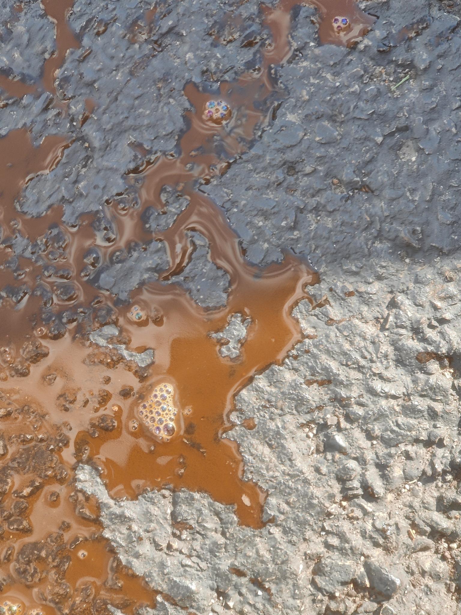

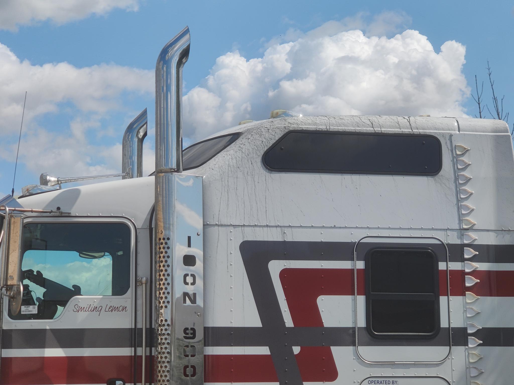

This is one of the issues I am having because of whatever is going on in there(demandated plus lots of moisture)

That is not normal. Maybe cans that were only partially hollowed out and it's now blowing old soot out???
Does it smoke like a freight train going down the road?

No, everything was done properly but a renowned shop. My theory is some of the coolant is going through the exhaust system and grabbing the soot on its way out.
This stuff spilled out of my coolant filter when I changed it

Did you have the truck off in an area where one of the hurricanes that recently went through? That looks an awful lot like some sideways blowing rain got down your pipes and it vomited it out when you started it up.
The rust colored coolant is quite concerning though. Have it tested for combustion gasses.

Are you implying that is what your coolant looks like?...
I guess some people just want to tear their equipment up by running the wrong coolant.. or only water?...
if your coolant is really that rusty.. then YOUR GOING TO BURN HOLES RIGHT THROUGH YOUR LINERS!!!! -- YOU CANNOT RUN WATER ONLY, OR WATERED DOWN COOLANT IN A WET-LINER ENGINE LIKE THE ISX.. IT WILL DESTROY IT IN A VERY SHORT TIME!

(09-10-2021 )Rawze Wrote:  I guess some people just want to tear their equipment up by running the wrong coolant.. or only water?...
That came out of the coolant filter. I have been running the red stuff(peak nitrate free). I might have the mixture off but up front it seem proper(-25 freeze level so it is not a perfect 50/50[or combustion gasses have lowered its effectiveness])
