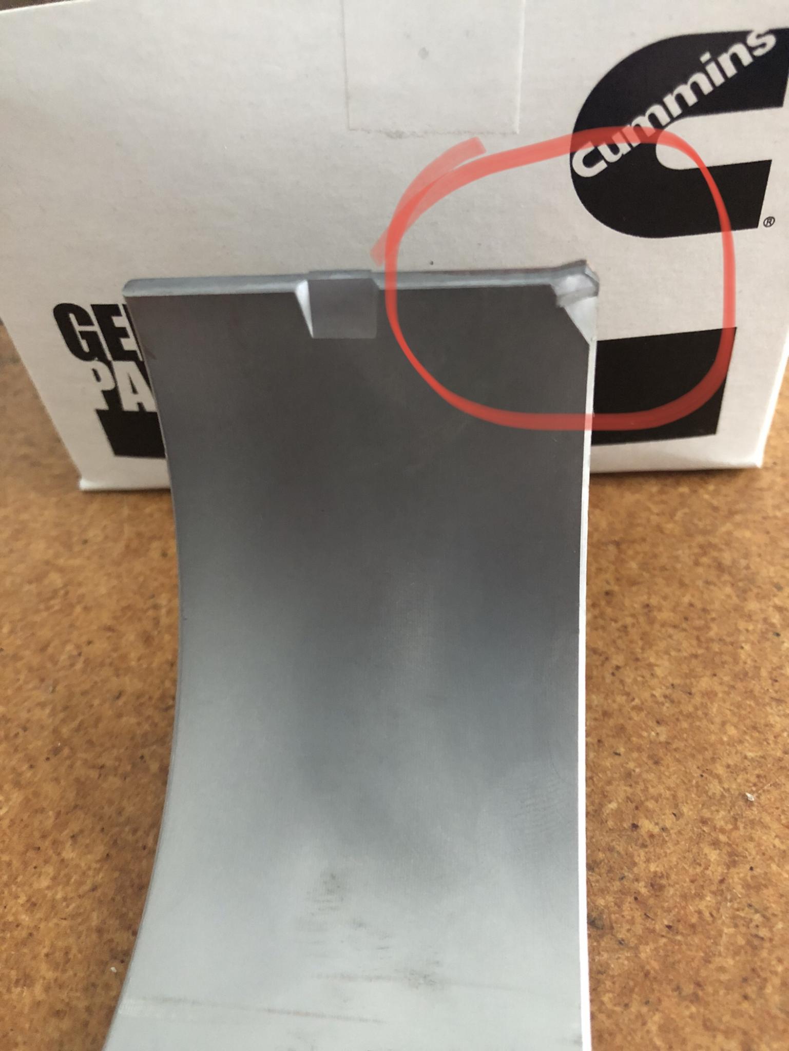

I noticed that every one, all 6, of these rod bearing lobes have this nitch or notch in them. Is this actually correct or a batch production error?

(12-13-2022 )kozakvod Wrote:  I noticed that every one, all 6, of these rod bearing lobes have this nitch or notch in them. Is this actually correct or a batch production error?
So I went through literally everyone of them and they're all the same so I'm going to assume at this point that is an intentional design.
Moving on.

yes, that is intentional.

Also you could have cracked style or saw cut rods and they do use a different bearing. You need to verify you get the correct. Rod bearings for the style of rod you have
