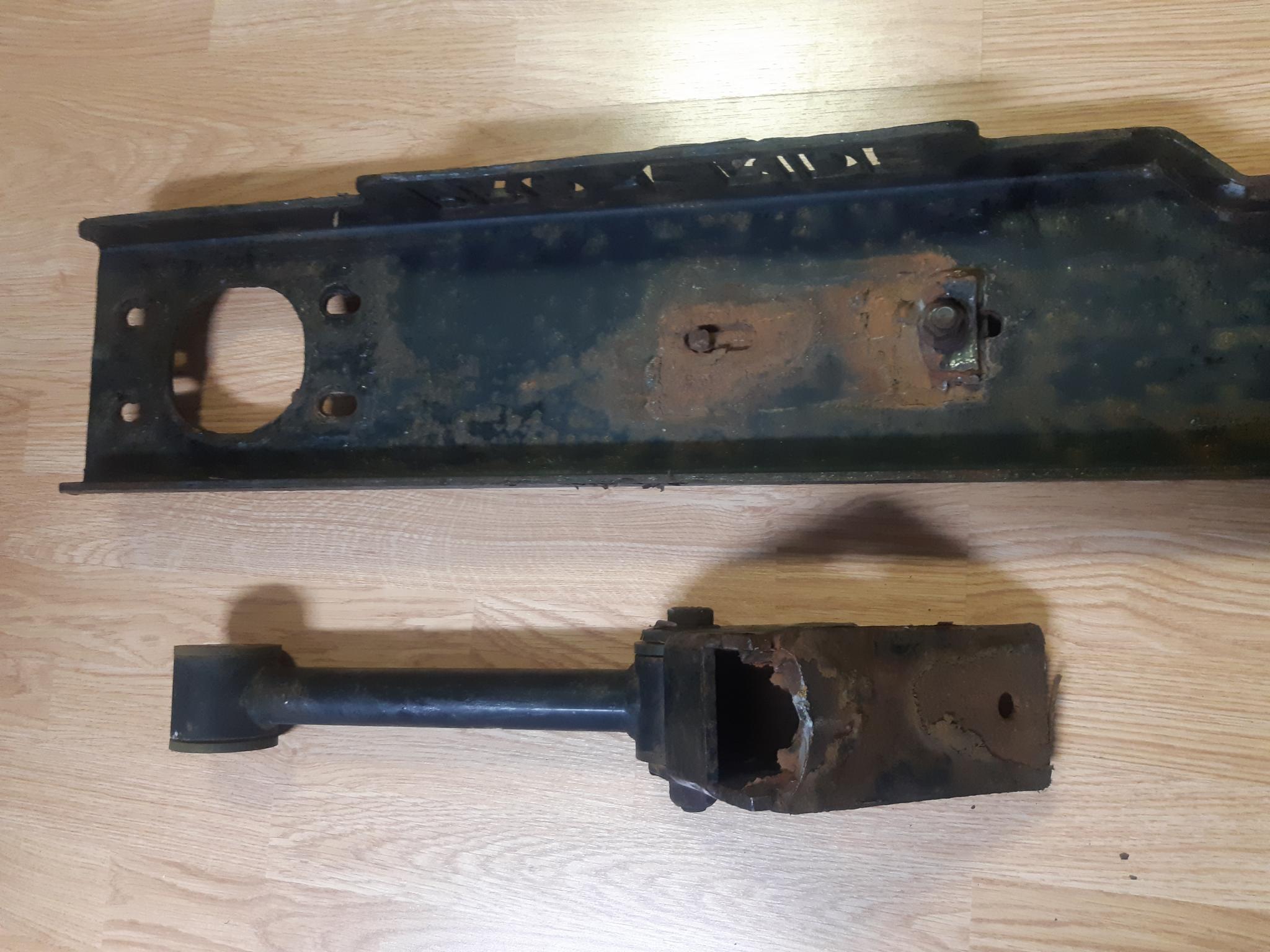

RE: ProStar Sleeper Suspension Modification... (02-10-2017 )Rawze Wrote: Other than that, I haven't heard anything bad from it so far. I installed mine Sept 2017, just over 3 years ago. It just broke on me this last trip. I don't live near a dealer, and can't wait for shipping, so I'm going to throw a couple big bolts in it and hope it holds. Maybe it's time for me to look at that new 4 bagger this summer. | |||

RE: ProStar Sleeper Suspension Modification... (12-13-2020 )barf Wrote:(02-10-2017 )Rawze Wrote: Other than that, I haven't heard anything bad from it so far. yeah ... I have had to correseal and por-15 mine in a few spots. Seems the winter road salts and weather likes to sneak in under their paint job in a few places. User's Signature: ->: What I post is just my own thoughts and Opinions! --- I AM Full Of S__T!. | |||

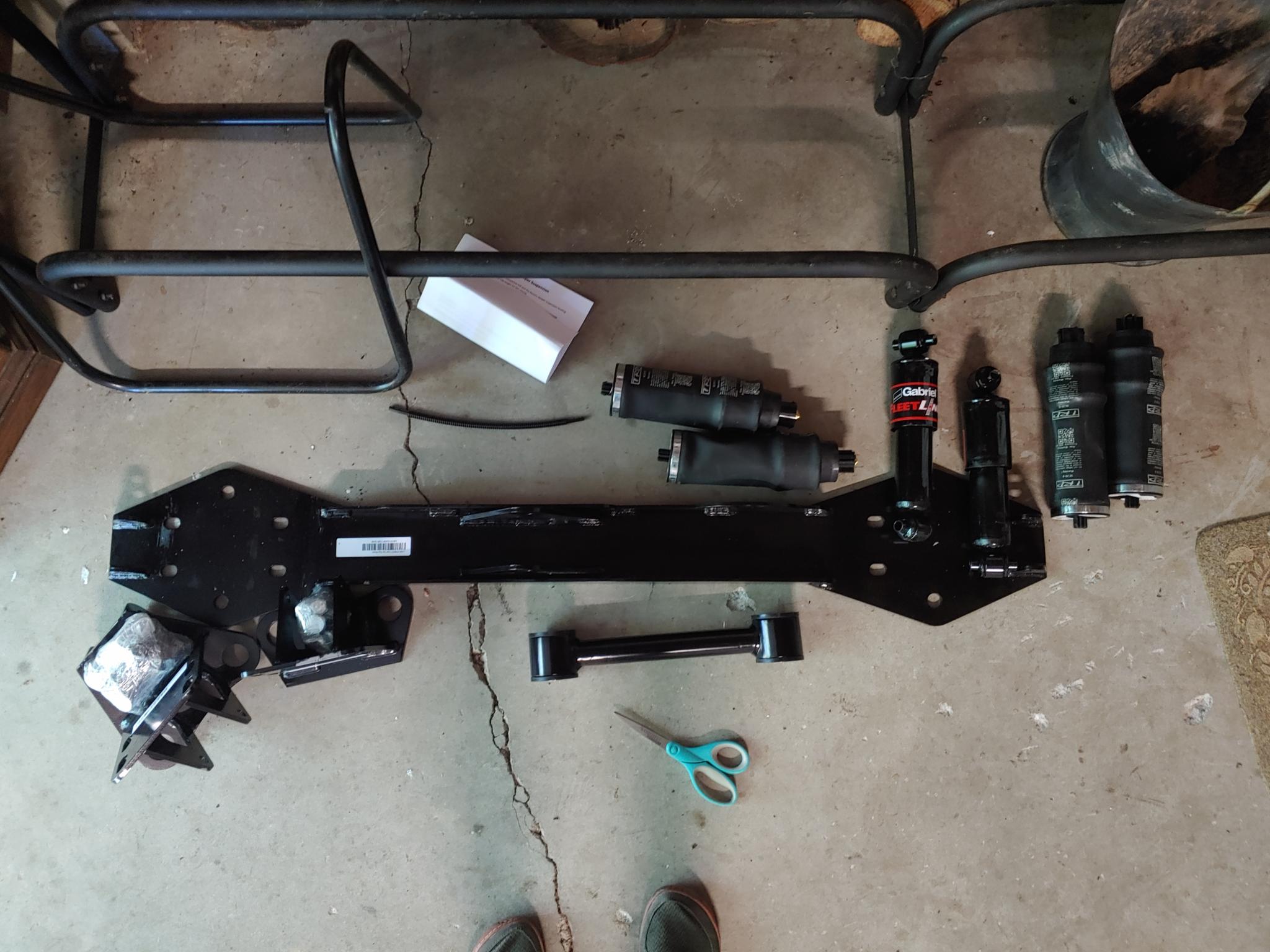

| RE: ProStar Sleeper Suspension Modification... Hi all, I ordered my pro-ride xt sleeper suspension. I removed the original airbags. They were filled with air but now there is no air coming out of the 1/4" air lines running into the bags. I've checked for leaks with some dawn dish soap and water. There is only a small leak out of the air dryer assembly, it's where there is a hole that you can put your finger into. This had already been happening with the old air bags. I tried the air compressor, no leaks. I noticed there's only one governor running out the back of the compressor and the side one is blocked off. I'm not sure where I to start. I got a new air dryer filter. I haven't installed it yet. I was wondering if I should remove the old filter first and WD40 the air lines? Please advise User's Signature: We're a full grid off. | |||

| RE: ProStar Sleeper Suspension Modification... I would look at your cab leveling valve. If it's broken internally then it will not send air to bags. Also make sure if you replace the leveler that you install it correctly so that it inflates at the right angle. Most leveling valves are pretty universal as to fit many different applications and mounting styles. It's not hard to wrongfully mount one to fill when it's to dump or vise versa. | |||

RE: ProStar Sleeper Suspension Modification... (06-17-2021 )Chamberpains Wrote: I would look at your cab leveling valve. If it's broken internally then it will not send air to bags. I sprayed for leaks, nothing. Is there another way to trouble shoot? User's Signature: We're a full grid off. | |||

| RE: ProStar Sleeper Suspension Modification... Make sure you have air coming from the supply line into the leveling valve on the cab. If you have air coming in you should have air coming out when the leveling valve is in the down position. Do you have air to the seats? I ask cause the seat air shares a port with the cab air bags and if the secondary cutoff port check valve has rusted shut from moisture then you will need a new aid dryer assembly. | |||
