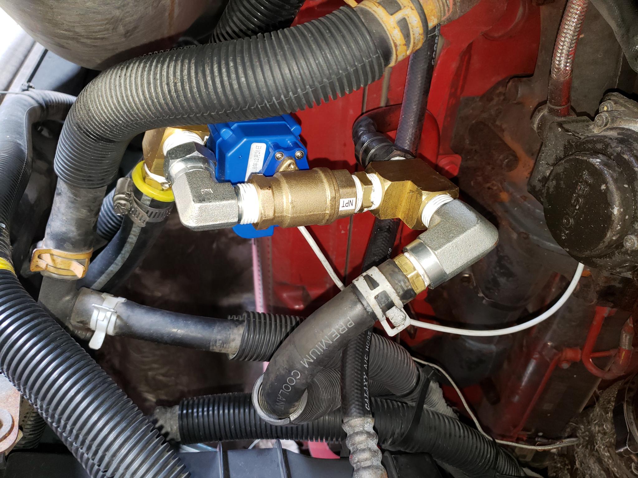

| RE: How to turn your heater core off and on in the cab. Well today is install day....I also got a new degas bottle because I can't see my antifreeze in the old one....I will let you know how I make out... | |||

RE: How to turn your heater core off and on in the cab. (06-23-2019 )earnies2 Wrote: Well today is install day....I also got a new degas bottle because I can't see my antifreeze in the old one....I will let you know how I make out... Well things didn't go well I couldn't get the fitting off the tube that comes out of the back of the head....so I heated it up and the copper fitting broke off.....so I removed the tube and put it in a vice and heated the fitting again hop to get the broken piece out but the whole fitting that was grazed on the pipe came off...so off to cummins in the am for a new tube and seal for the head end....sometimes I'm a bull in a China shop..... | |||

| RE: How to turn your heater core off and on in the cab. Earnie! What the hell were you doing behind the head? All you had to do was go inline with the heater core inlet hose. You can extend it too if it is too short and mount the valve elsewhere using hose barbs and clamps. Bad Earnie! | |||

RE: How to turn your heater core off and on in the cab. (06-24-2019 )Waterloo Wrote: Earnie! What the hell were you doing behind the head? All you had to do was go inline with the heater core inlet hose. You can extend it too if it is too short and mount the valve elsewhere using hose barbs and clamps. Bad Earnie!I wasn't behind the head. The heater hose tube comes out of the side of the head at the rear. I broke the 90 degree fitting at the end of the tube. Then I removed the tube to put it in a vice to remove the broken piece and after heating it the threaded part that was grazed on the tube came off I still never got the broken part out.... | |||

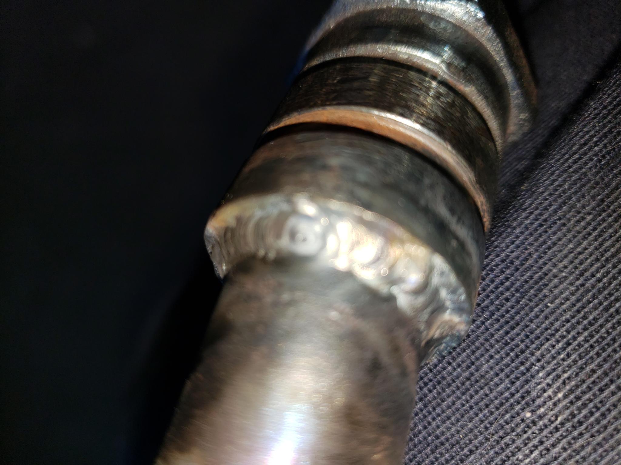

RE: How to turn your heater core off and on in the cab. (06-24-2019 )earnies2 Wrote:(06-24-2019 )Waterloo Wrote: Earnie! What the hell were you doing behind the head? All you had to do was go inline with the heater core inlet hose. You can extend it too if it is too short and mount the valve elsewhere using hose barbs and clamps. Bad Earnie!I wasn't behind the head. The heater hose tube comes out of the side of the head at the rear. I broke the 90 degree fitting at the end of the tube. Then I removed the tube to put it in a vice to remove the broken piece and after heating it the threaded part that was grazed on the tube came off I still never got the broken part out.... All fixed I had the fitting tight welded back on the tube and finished the job now all I need to do is wire it up | |||

RE: How to turn your heater core off and on in the cab. (06-24-2019 )earnies2 Wrote:(06-24-2019 )earnies2 Wrote:(06-24-2019 )Waterloo Wrote: Earnie! What the hell were you doing behind the head? All you had to do was go inline with the heater core inlet hose. You can extend it too if it is too short and mount the valve elsewhere using hose barbs and clamps. Bad Earnie!I wasn't behind the head. The heater hose tube comes out of the side of the head at the rear. I broke the 90 degree fitting at the end of the tube. Then I removed the tube to put it in a vice to remove the broken piece and after heating it the threaded part that was grazed on the tube came off I still never got the broken part out.... Here is what I had welded... | |||

| RE: How to turn your heater core off and on in the cab. Looks fantastic! Factory. | |||
